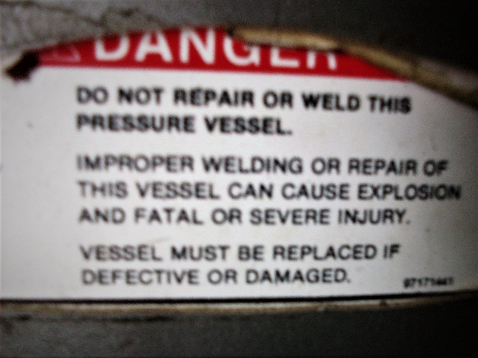

My compressor that came with a dryer doesn't dry the air going into the receiver, but only going out. Kind of suggests that moisure going into receiver isn't as big an issue as moisture going out to your tools.
The guy who spoke of making a cooler, or coil, before going into the tank. Thought about that. So where does the water go? Still goes into the tank.
As I took this picture, I noticed the DRAIN DAILY sticker and tried to do that. As often happens with me, the valve won't work. Plugged up!
Compressor lives in a small second story, very tight, heated room with two tiny windows. Would be UGLY if it ruptured.

I think they stuck the label on it because the tank did explode and severely injured the grandfather.
