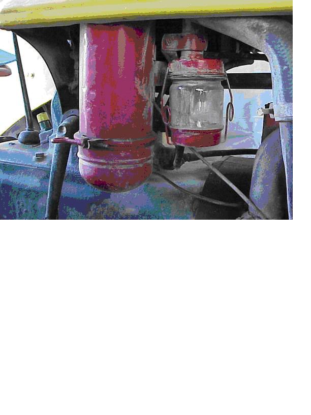

The glass setting jar was likely a prefilter like a cyclone.. it was not an oem part of the 9n oil bath air fitler.
soundguy
Soundguy,
Yes, I checked and it is an air filter. The 9N is a faithful machine but we have been neglectful, haven't done much work on it - always plan to work on it in the winter when we have "extra" time ....but.
