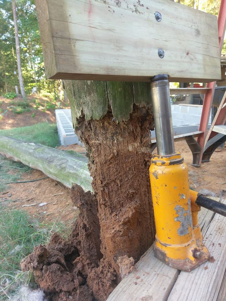

Eddie,
Were the posts real cedar (like a pine tree) or what we wrongly call cedar in Texas (Mountain Juniper)?
Were the posts the whole tree, maybe with just the bark pealed?
If it was juniper and nearly the whole tree, I think you had the sapwood rot away leaving just the rot-resistant heartwood. Saw it with fence posts growing up.
Usually, the layer of sapwood is fairly thin on Mt. Juniper but I think if it grew in favorable conditions the sapwood gets thicker.
I never did any research before, but since you asked, I just did and it looks like what I've been calling a cedar tree, is actually an Ashe Juniper tree.
/ Akita Pool #182
Eastern Red Cedar heartwood won't rot. At least I haven't lived long enough to see the heartwood rot.
hugs, Brandi
/ Akita Pool #183
So many distractions have come up that I haven't had any time to do anything on this until yesterday. The biggest motivation to start this project was that the current cedar posts for the porch where rotting out. I put them in the ground back in 2005 and started noticing rot after a few years. I though they where ready to fail, and thought that if I didn't get them out now, the porch would fall over during a thunderstorm in the Winter or Spring.
After taking apart the porch, I jacked these posts out of the ground to find very solid wood in the ground. I don't know if the outer layer just rots away and that's that, or if the rot would continue like it has and eventually fail. I was surprised by this.
This morning I woke up planning to get more work done, but my wife was sick and very dehydrated, so we went to the hospital instead. She is doing better, the IV did wonders for her and for the first time in two days, she is able to sleep. I did all her chores today, and went to the feed store. Maybe next weekend I'll be more productive.
cedar rots on the outside, the heart stays good almost indefinitely! but they will loosen in the hole as the diameter shrinks from rot

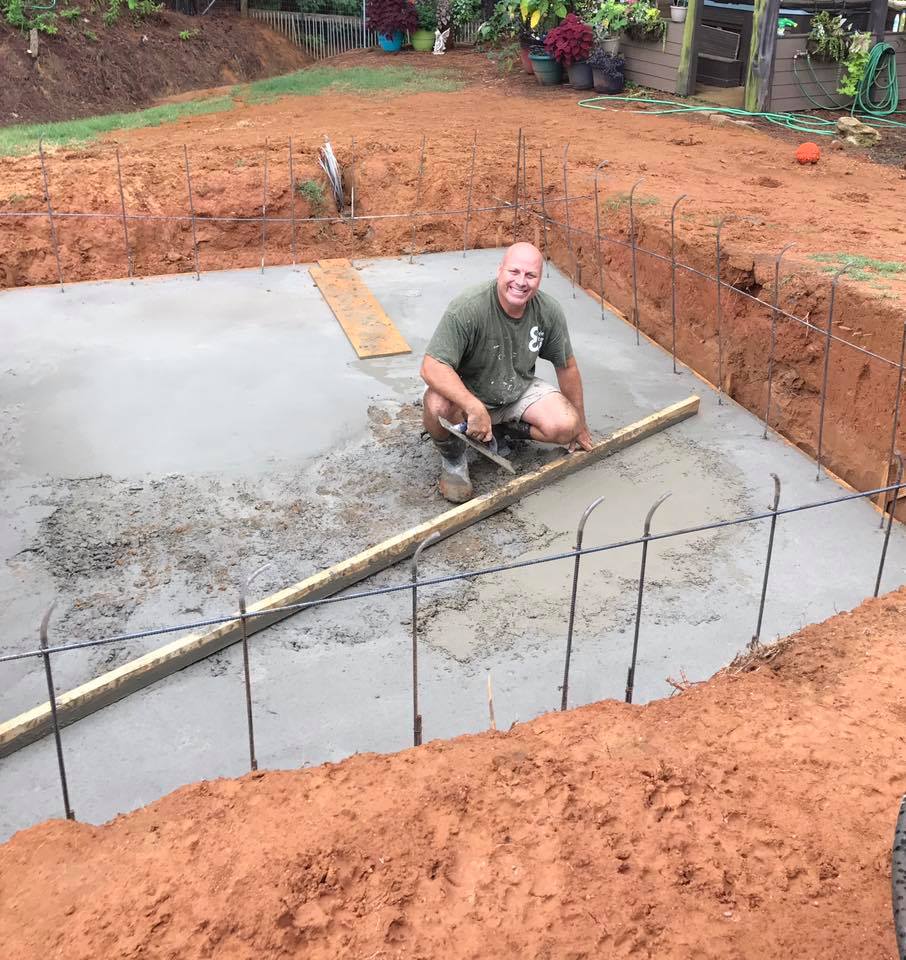

I drilled the rebar into my existing porch and also into the house foundation. I also drilled holes for it into the sides of the blocks so it would end in the middle of the block. Since the bock is 16 inches long, I went with one piece of 3/8's or #3 rebar in every other opening of the block, which gave me a nice 16 inch grid. Big enough to walk through and keep the rebar in the air on chairs.
The rebar and forms have been done for quite awhile, but the weather hasn't been good. To get to where the cement truck needed to be, I had to make sure the ground was dry. Rain kept messing that up, but fortunately it's been dry for a couple of weeks and the ground is nice and solid.
4 yards is the minimum, and I used up every bit of it. My measurements put me at 3.2 yards. The rest I wanted to fill as many blocks as I could. That turned out to be both a good idea, because it's another step forward, but also a horrible idea, because of the effort it took to do this on my own.

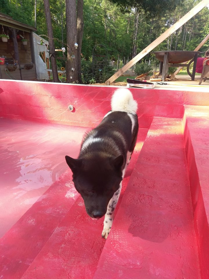

Then after a lot of reading, asking for advice, and calling manufactueres, I decided on RedGard to seal the block. That was my original plan when I started this project, but the more I asked, the more options I learned about, and then dismissed for a variety of reasons. Cost, complications installing, Cost, lack of support from the manufacturer, Cost and availability.
First coat of RedGard was brushed on every seam. I put it on fairly thick, but more importantly, getting it into every crevice. Then the next day, I used a paint roller with a 1/2 inch nap to roll it on over every square inch, including what was already done the day before.
This morning we put the hose in there and started to fill it up. Of course, Matsu was the only one to see what was going on, and get his toes wet.

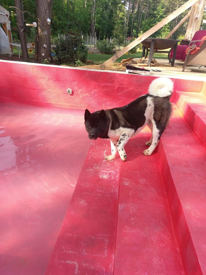

I filled up the pool for the 4th to see if there where any leaks, and of course, to get in it and see how it is.
There is a leak. It's a pin hole that is shooting out water between the blocks. Every seam got two coats of RedGard, so I'll have to see what's going on there when I drain it. I'll probably put on another coat after sealing that leak, and then go to plaster for the next layer of water proofing.
I was unsure how small it would feel when building it. The goal was to have a place for my wife and I to relax and cool off, but also for grand kids to play and have fun, and maybe even get the dogs to come in and cool off too. The dogs are using it as a water bowl. Only one has put his feet in it, and seems unsure of it. I think that will change with time, but either way, it's always an option for them if they want to go in it.
I put out two blow up rafts to lay on, and we had five adults and one 2 year old in it with plenty of room. The stairs have proven to be the best part of the pool. Warren, my grandson, just loves to run along them, and splash in the water, then go down another step where it's a little deeper, and the climb back up again. Over and over again!!!
We'll enjoy it this weekend, and then Sunday night, I'll drain it to work on the leak and get ready for plaster and then tile.

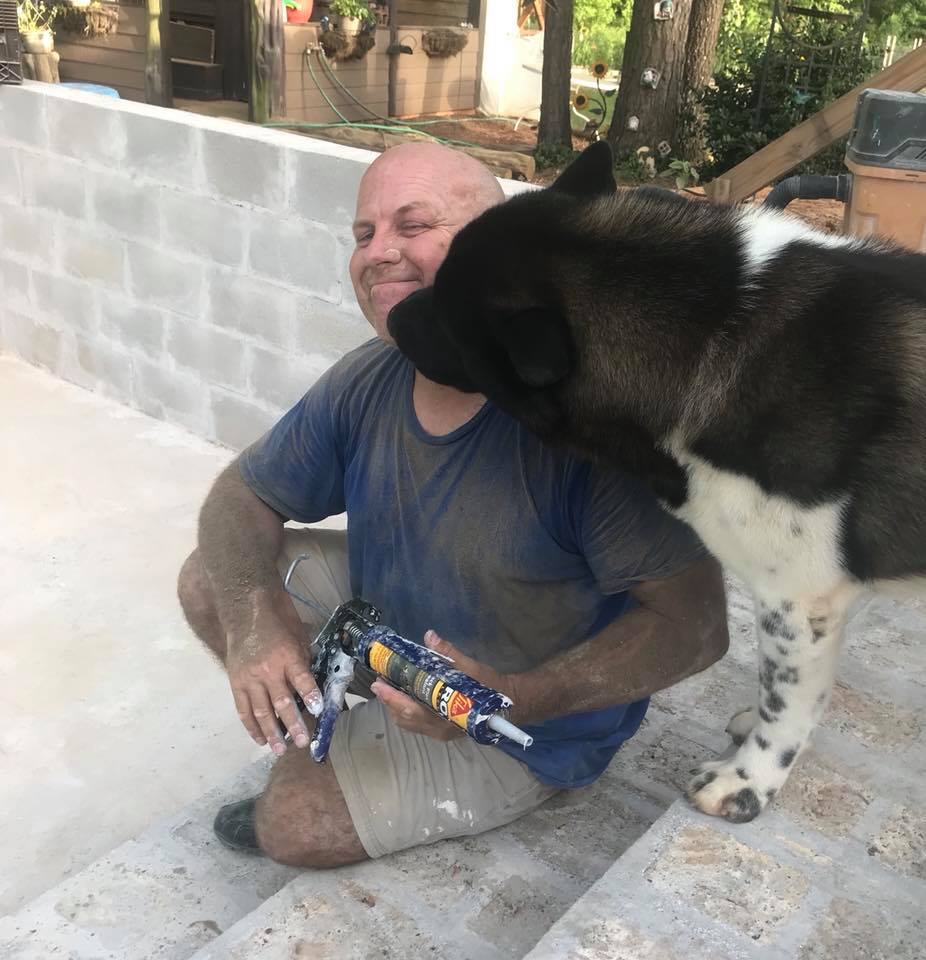

Update on the Redgard. It faded quite a bit when under water, but it's still on there. I found a couple of leaks that I plugged with some blue gasket sealer because that's what I had on the shelf, and it worked great!!! I also added a couple sacks of leveler to get it to drain better. That far left corner was holding water after emptying the pool, and I wanted to fix that before the tile went on.
