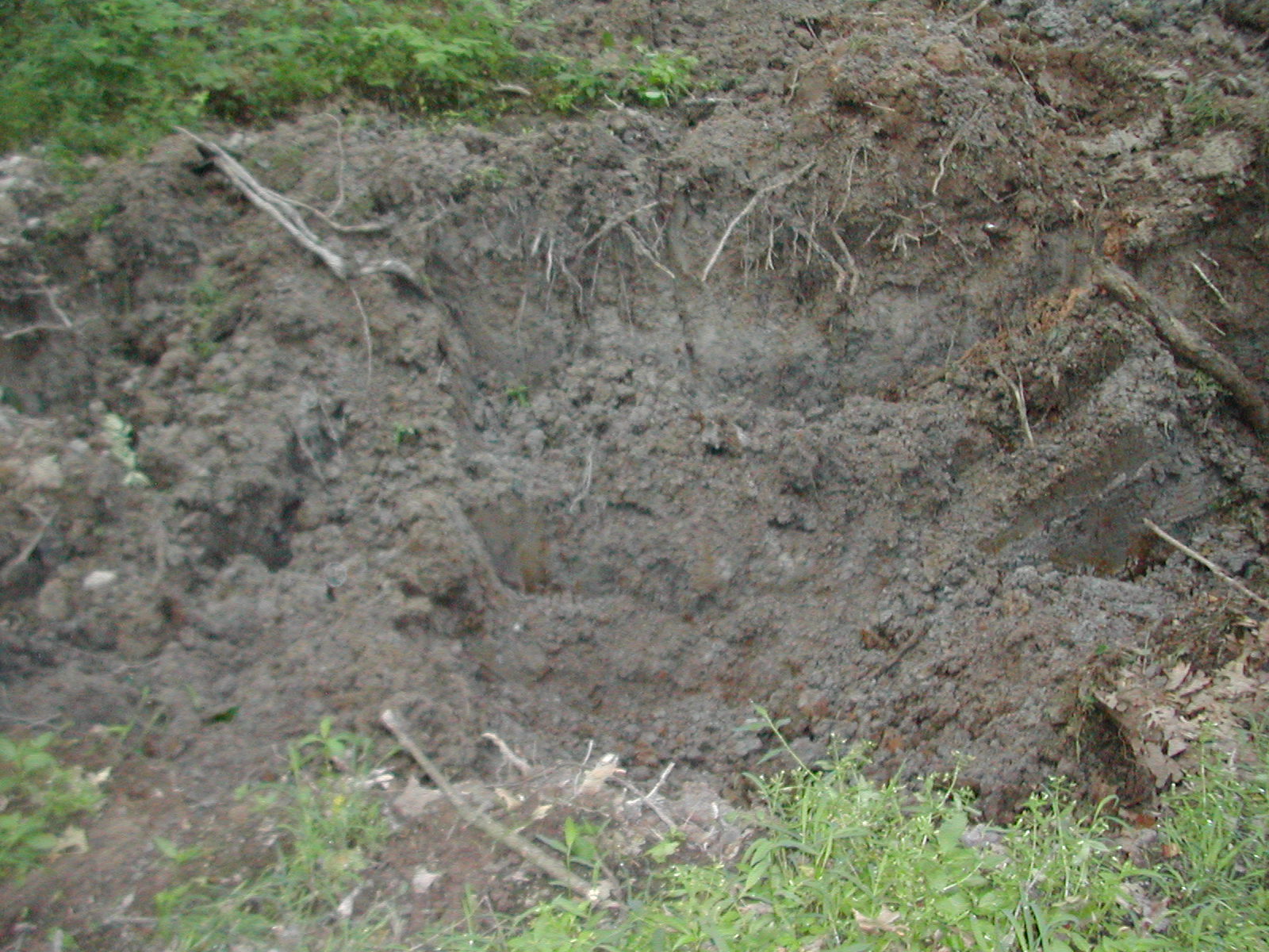

You know how hard it is too take an effective picture of a dirt hole????? I think next time, I need to get the dipperstick in there so there is something to relate too.

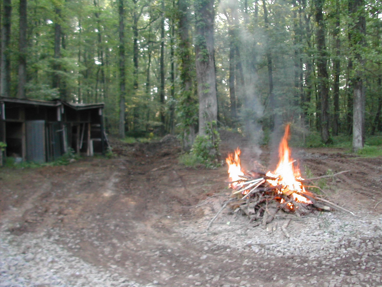

So today, I went out and got cracking on it a bit more. The air was still so I fired off my burn pile. Pic 2342 so I could stoke it a bit throughout the day.

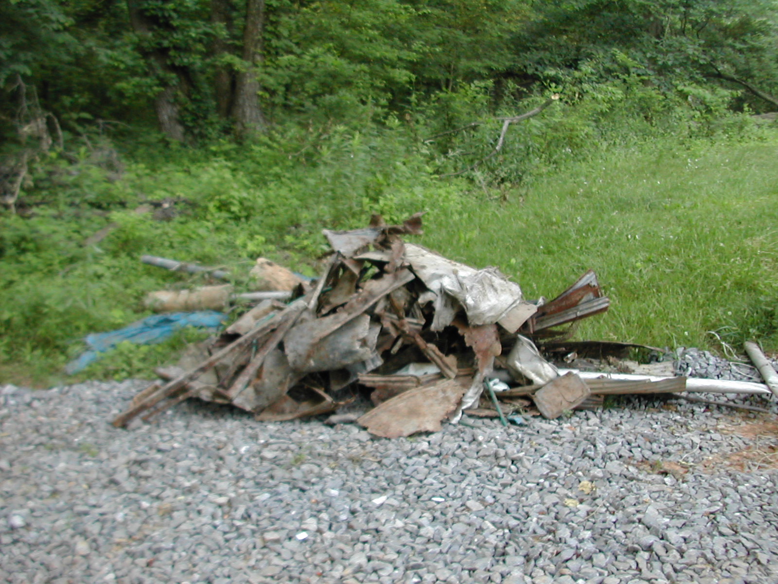

2343 is the pile of scrap steel from the area you see cleared. :(

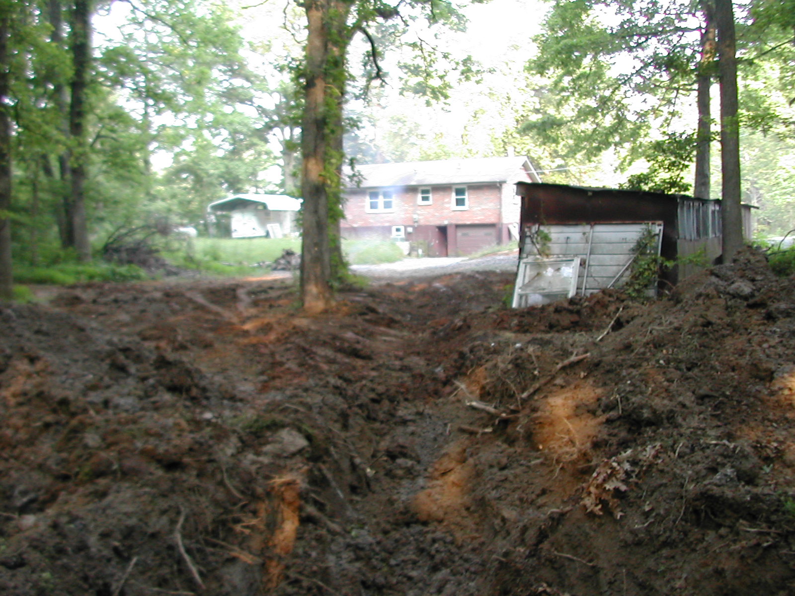

2345, from my hole, back towards the house, after I swaled out the ditch a bit. Still needs a lot of work, but one step closer.
2347 My collection hole. It is about 6 or 7 feet deep. Needs to get substantially bigger, but it should make a good start.

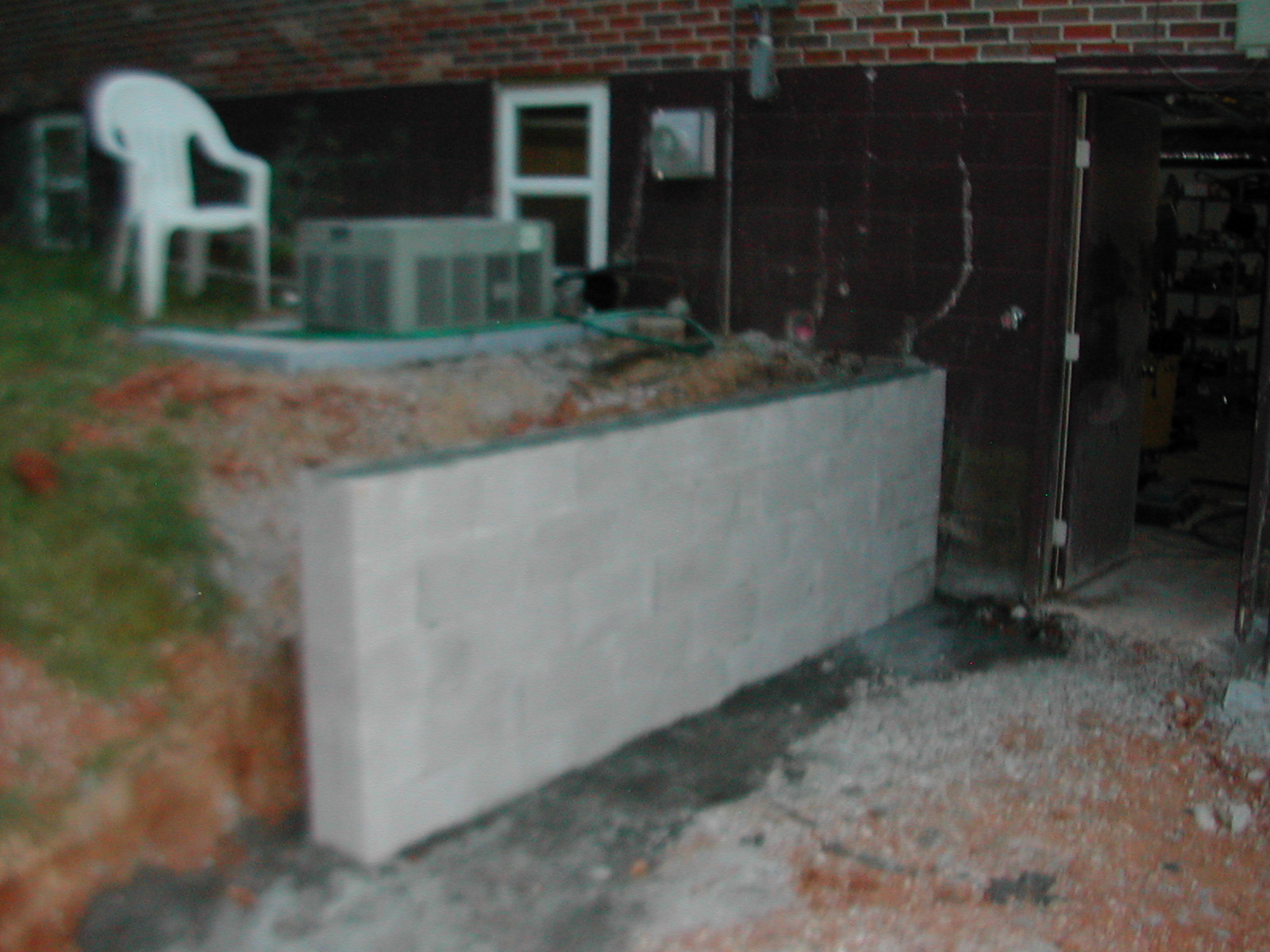

We dug under both rotted piers on the basement on either side of the garage door and poured a support pad underneath and outside of them. About a meter cubed. We also stuck 3 rebar in and ended the rebar up in the block above the pour. Then after that base would harden, we cut out holes in the blocks above, added a piece of rebar top to bottom in each core, and filled the blocks.
We also filled the crumbly block beside the personell door.
I removed the wood retaining wall beside the AC unit, and dug about a 2' footer last night, and Mingo and Christina mixed and poured a footer, then dry set the wall, then poured all the cavities solid. They also ran a rebar in each cavity I think.
The back is getting steadily cleaned up.
I got the small bucket reamed out and installed to do some of the foundation work. My error in judgement only cost me $50 so I can live with that.
Pinion bearing on the Mowing truck has decided to raise a ruckus... Needs to be changed in the next week or two... Funnnnnnnn :(

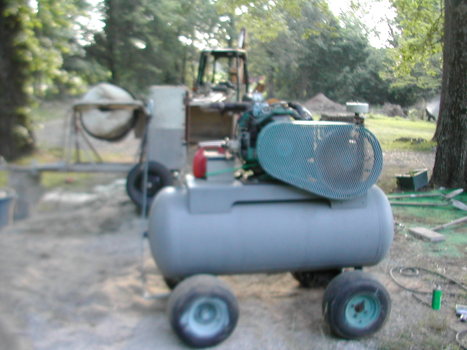

Thought I would show a picture of my "little" air compressor, Not many folks have an air compressor that drives itself. :D
Life is good, we have decided to hire out the re-finishing of the hardwood floors, so that is scheduled for the 18th or something of this month.
Think Mingo and Christina are working kitchen walls and the archway tomorrow. I think I am backfilling the wall they built today with sand, gravel, cement (I guess that would be called concrete :eek: ) mix (real light on the cement....

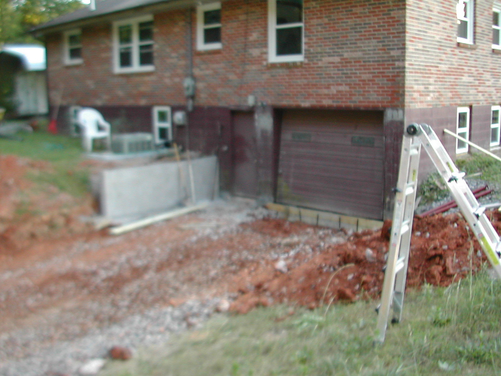

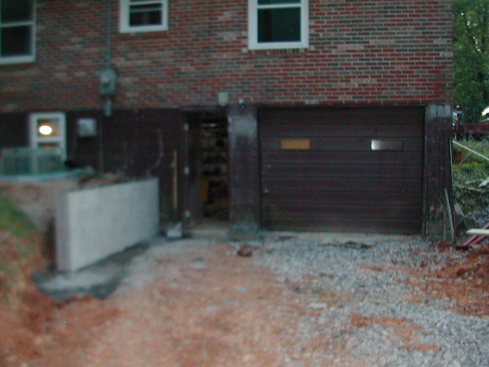

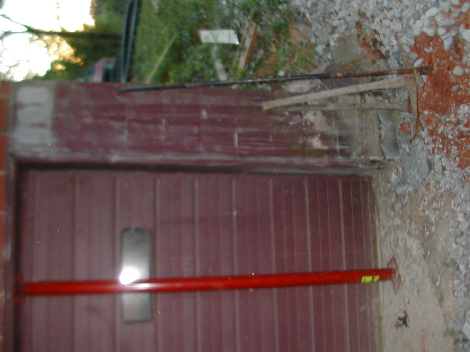

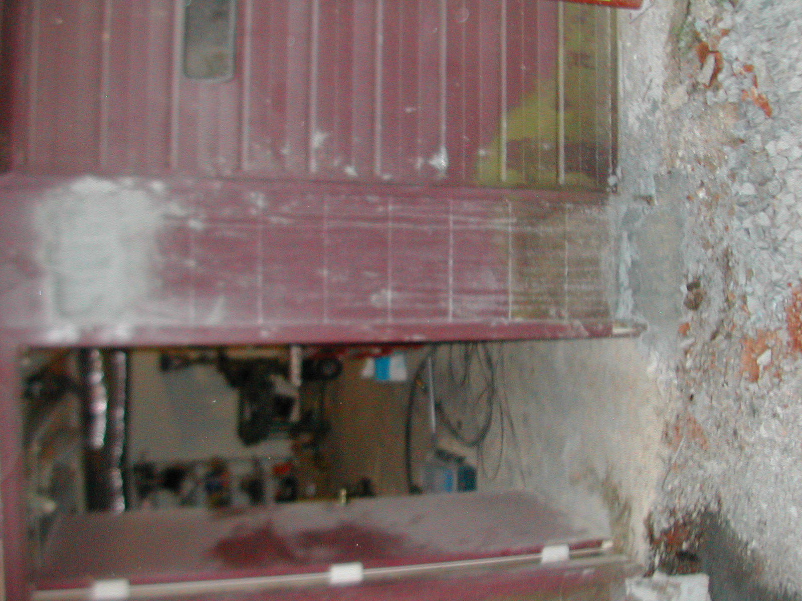

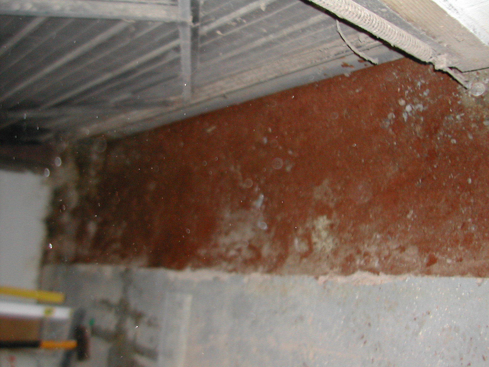

Well, let me post some more of my poor pictures,
I must be changing something, and not even realizing it, because I did some samples in the shop and they came in fine, yet, the ones I took at the JH house are terrible, and as was pointed out (did not even realize it) somehow the left is blurrier then the right.
So below are the pictures from Thur night.
Dug out below the garage door, and into the cut that Mingo made so we got back to solid concrete in the basement / garage.
Currently we are discussing putting down paving stones instead of concrete outside the garage.
I think Hanna and Mingo are building a mailbox (or two) today.
I am going to start clearing the house, I think, for the hardwood guy who will be here on the 20th I think.
Also need to change out the electrical outlets and switches in all the bedrooms.
Will probably also start clearing a bit in the back to move the bike trailer back from the carport.

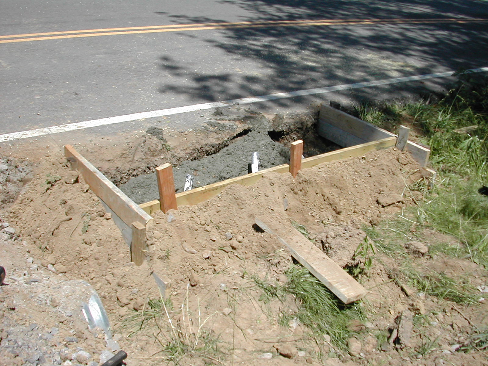

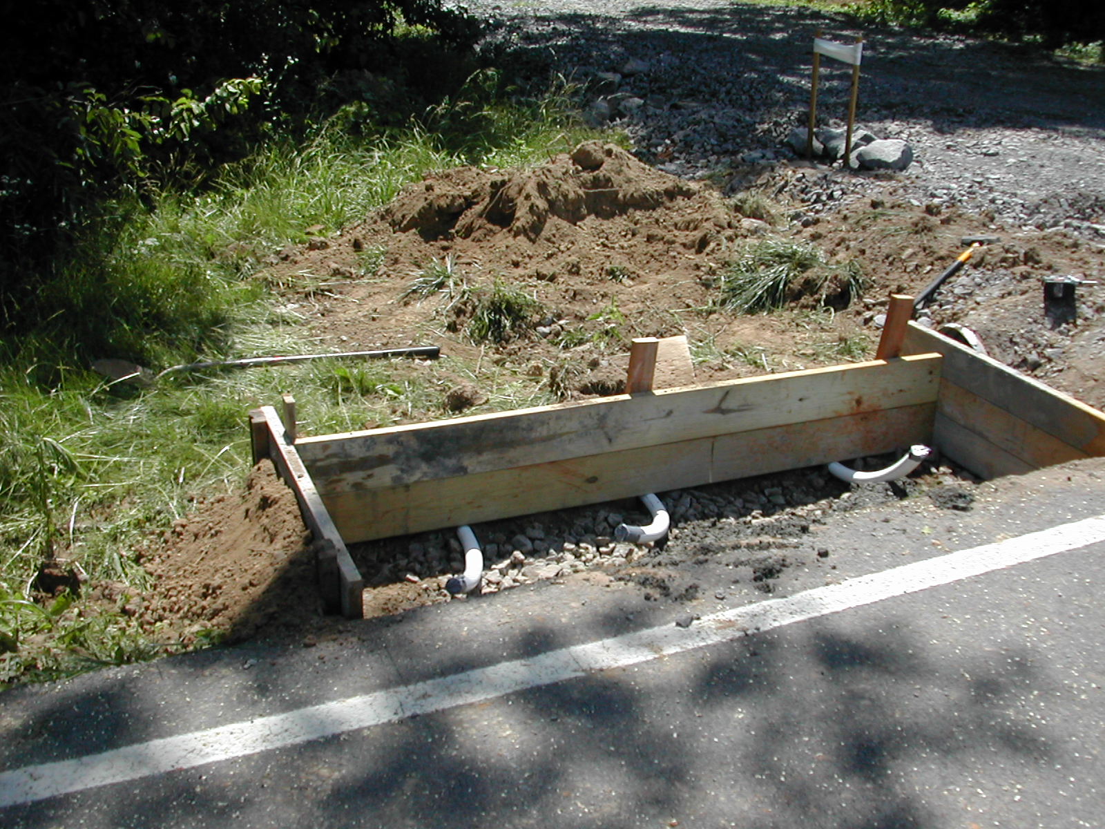

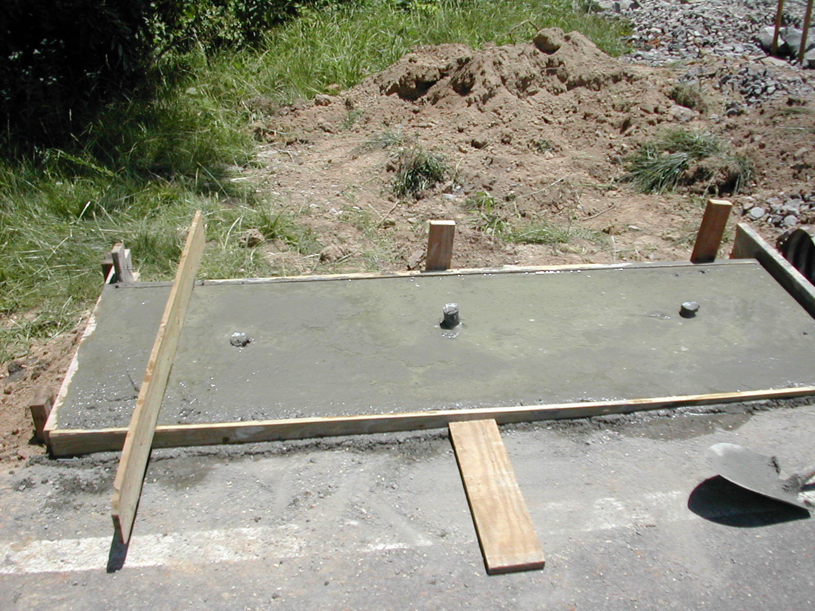

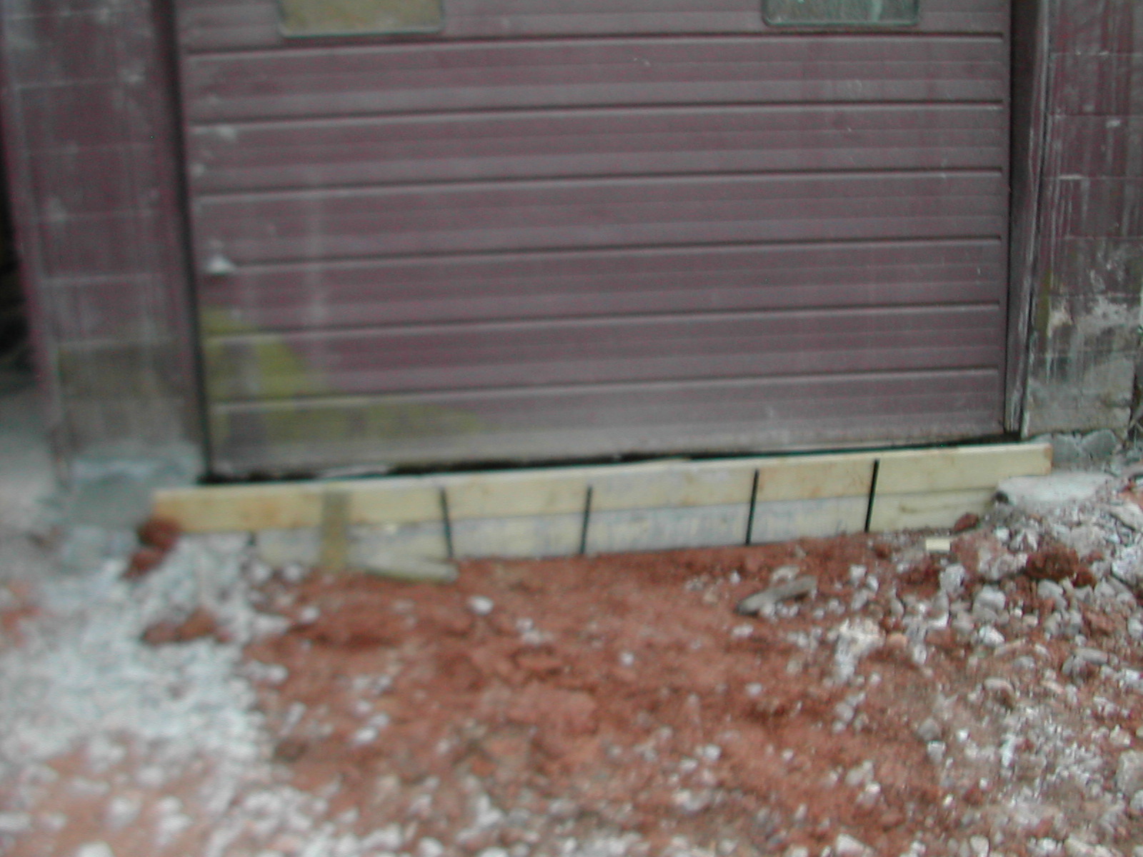

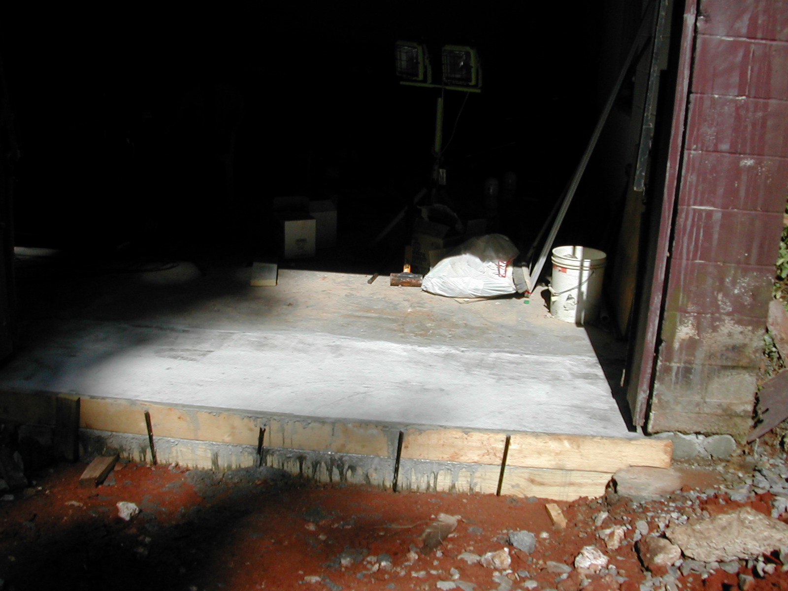

So, as usual, the best laid plans went awry :D
I ended up participating in the Mailbox building class, along with holding the How many grease guns of grease can an old worn back hoe take. :eek: (have not found the answer yet, kind of like one of those lollipops )
Whatever fooling around I did, seems to have cured the camera at least :D
After we poured the foundation, we then went on to work on the house a bit, Hanna has the drywall about finished out, Mingo primed up the archway betwixt the living and dining room, I mounted an exterior light by the new door and speedy mortared in the new lentil beam.
Some good customers came over and we toured the house and talked about things for a while.
2408 garage door concrete this morning
2410-2418 Mailbox pad in the offing. Yes, the tractor moved the concrete from the house to the road (375' one way)
