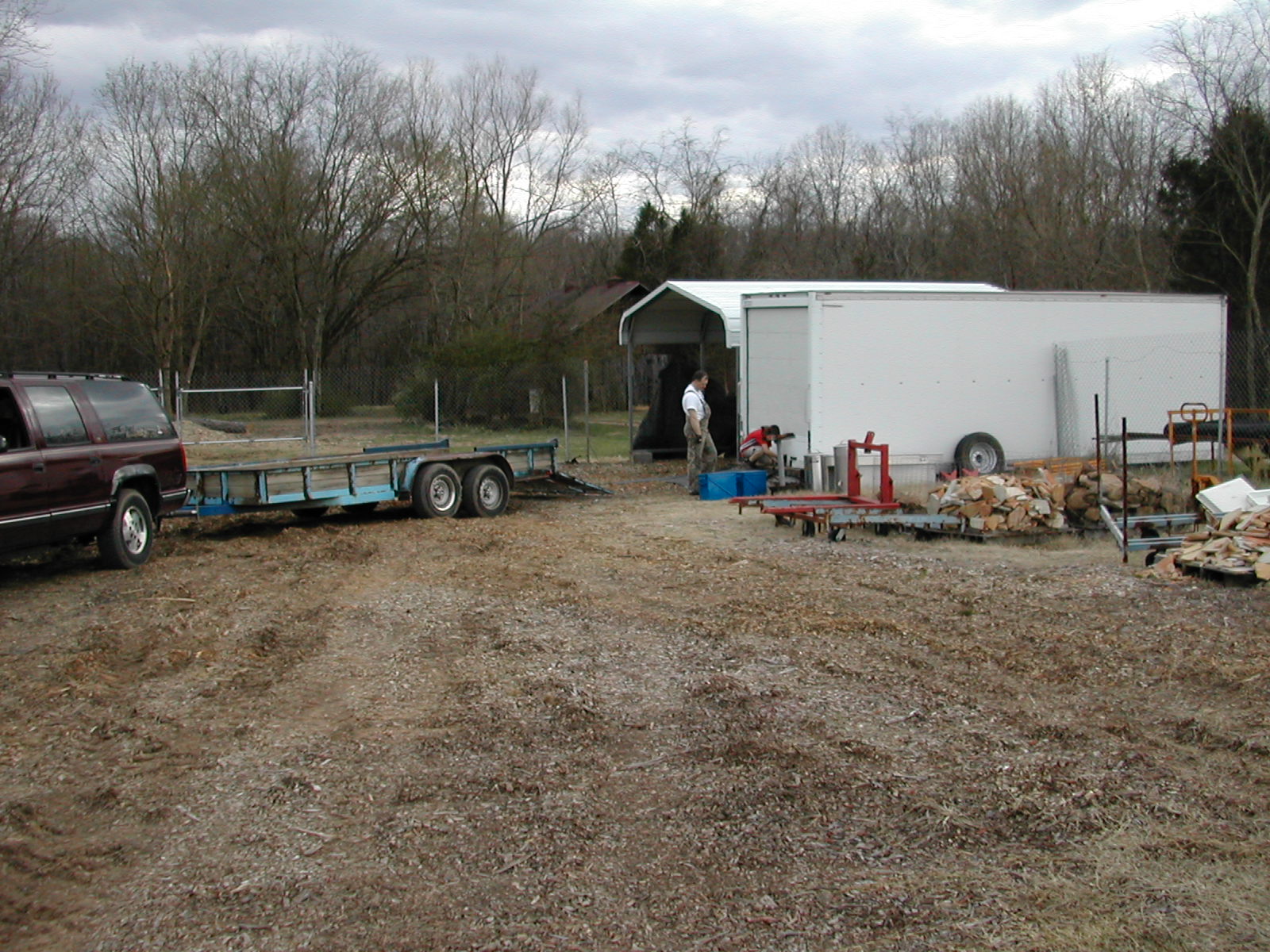

So todays project for me was moving a load of material from the mowing property out to the new property. I have to be off by April 1st.
So my buddy Jim came over to lend a hand, and the kids pitched in a bit. Got one good load out, couple more to go. Also have to move my storage container and the carport I just had built before they pulled the rug out from under me....
And here are some more pictures of the well.
And unloading at the chicken coop.

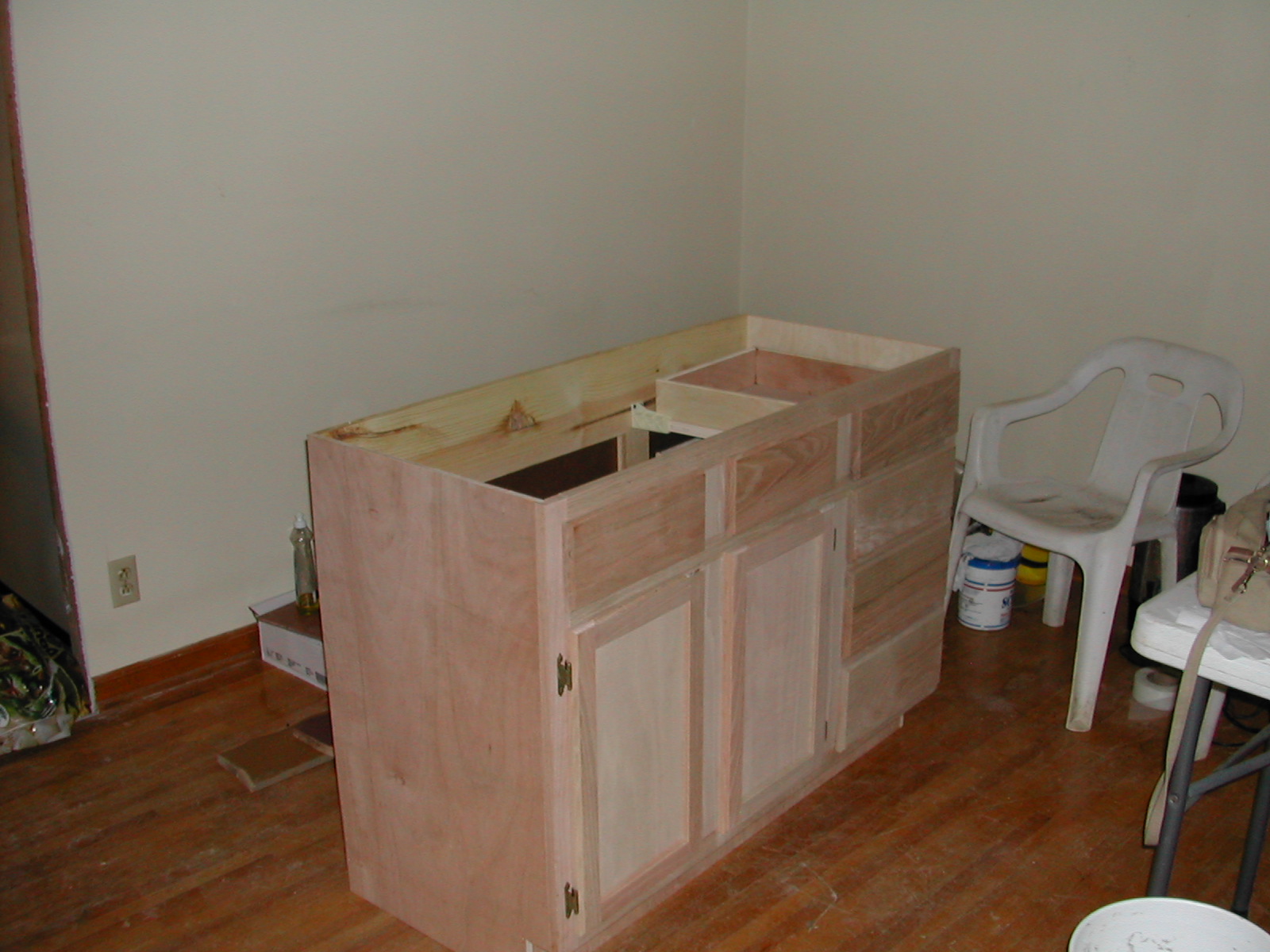

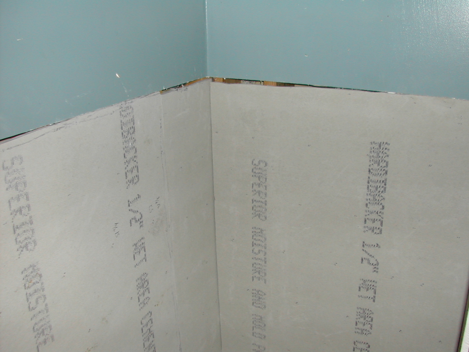

Hanna worked on putting hardy board on the wall to tile up today. That is not going so well. She also picked up a vanity cabinet, but it has the drawers all on one side, not sure how she plans to make that work, and I am not sure she realized it till I pointed out that she would have to find a sink that was not centered in the countertop.... I do not think this will be so easy, maybe I am wrong.

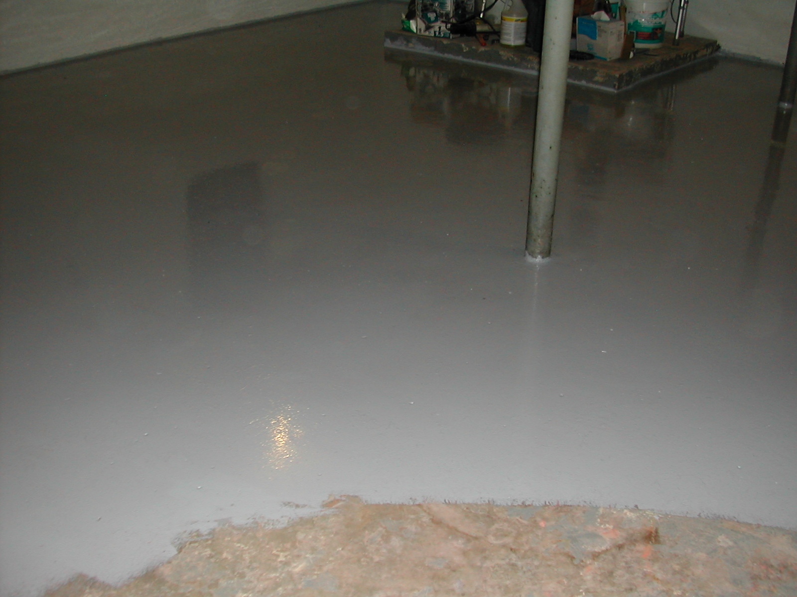

1982 is the epoxy coating on the floor,,,, Forgot to tell her to pick up some shark grip (sand) to add in, Think it will be slick if it get's wet :) Just maybe eh?

No house work for me today, Hanna worked on finding a sink for the vanity, and getting the wall board and tiling in the bathroom straight.

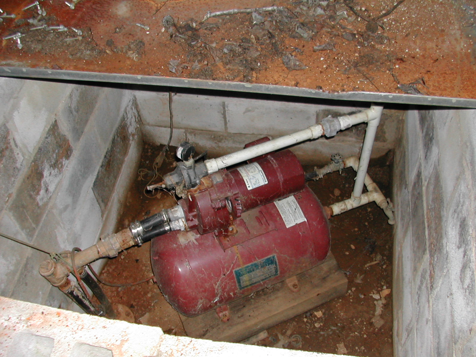

Alan you have been doing so much work that I am getting tired just from reading about it. The driveway looks good. Since I am going to be doing some work on my driveway this summer I might want to ask you for advice about that. I agree with eddie about the pump walls and actually have some more advice for you. That is a jet pump I beleive that jet pumps were designed so that sailors would have something to use their vocabulary on. My advice would be to get rid of that thing. tear down that ugly wall and put a short piece of 24 inch pvc pipe in the ground around it. You can mount the pressure switch in the Pvc pipe and then just use a manhole cover to cover it. You can either just run the pipe to the house or if you want it for extra water put a freeze proof hydrant in right at the pump. If you do decide to go with the submersible pump buy some 1/2 black flexible pvc pipe ( I dont know what it is called) run your cable to the pump itself inside that pipe and then get a band clamp and clamp the pipe to the pump. This will stop a lot of your problem with having the wires break when the pump twists as it kicks on.
If the epoxy floor is too slick then just buy more paint add the sand to it and repaint it. It will cost some money but that will give you a good second coat and should last longer.

After looking at the well picture, I'd definiatley get rid of that wall and fill in the hole. Pull the pump, cap the well and cover it in grass. If you ever need it, you know where it is, but odds are that it's not something you really need right now and why live with such an eye sore? You have way too many other projects going on to deal with trying to make that mess into something that is only less of a mess then it already is. Just think how much nicer your yard will look without it there!!!!
