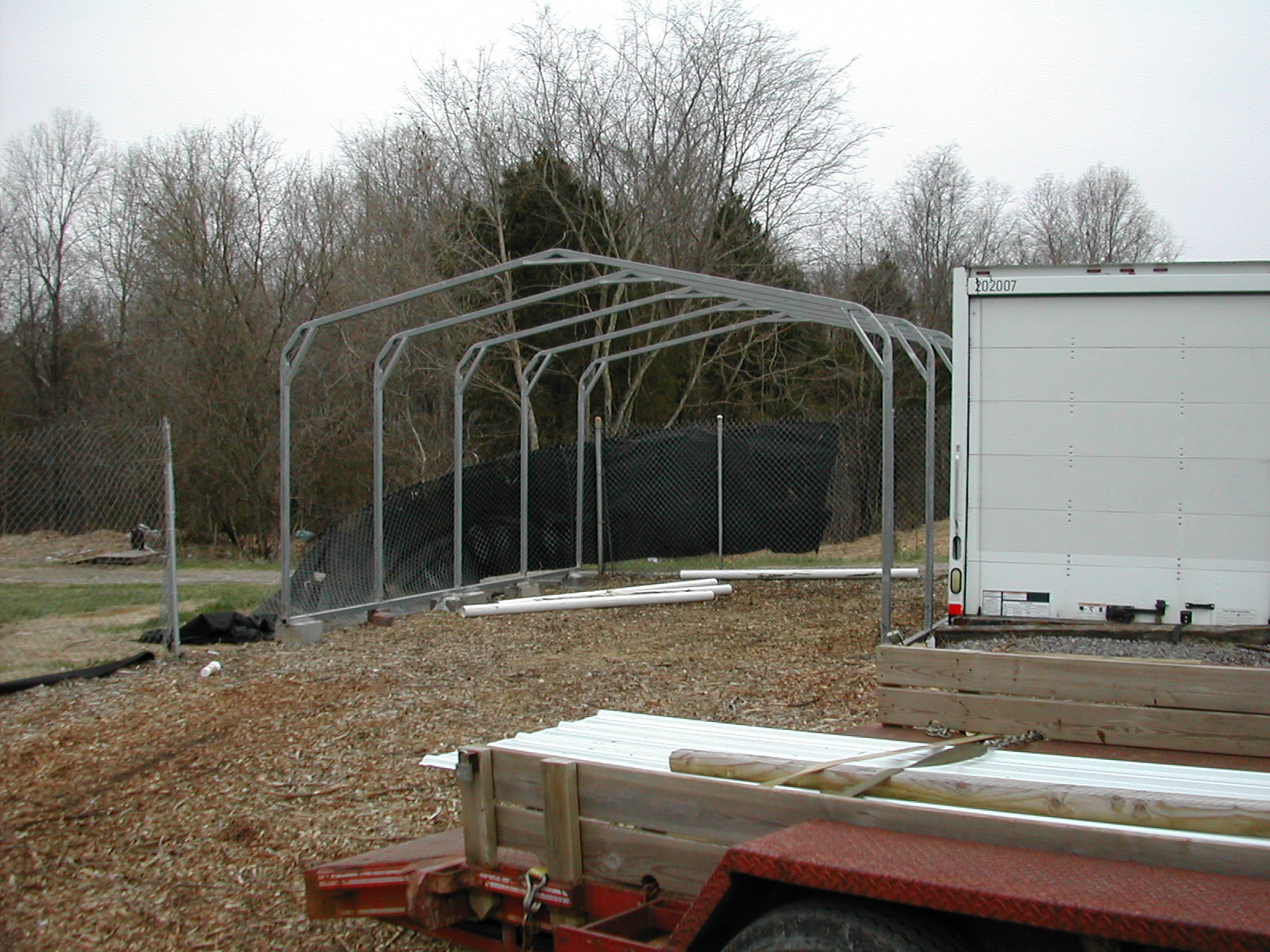

So, as usual, I did not get everything I wanted done, but we definetely made some headway on clearing off the Landscaping land and getting stuff moved to the new house. Will have to take a picture of what we moved today when I am at the house tomorrow.
So here are the pictures of today.
Makes me SICK to be taking down the carport that I just had put up. I should have known better then to do it on rented land.
Oh, and for those of you that have not seen me, I am not exactly what you would call "slight" of build, and crawling around on that roof pulling off the sheetmetal sheets was not exactly a chore I have been looking forward too.
Oh, and I have to cut off the heads of my ground pins..... No fun at all. I think I made the anchors like 80" long, I was wrestling trying too pull them up and the DW looks at me and say's "diddn't you say you were making those so they would not come back up out of the ground?" Dont you hate it when they are right :)
Wrecker is coming next Friday I think to move the storage box.
Should have it all wrapped at that point. That is $200 a month back in pocket at least. :)
