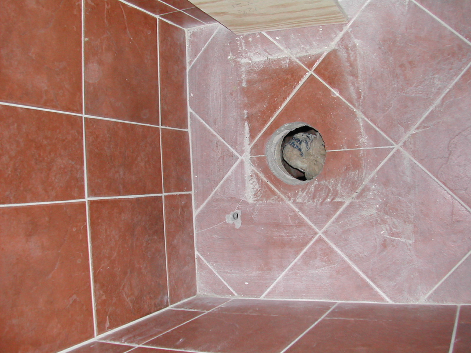

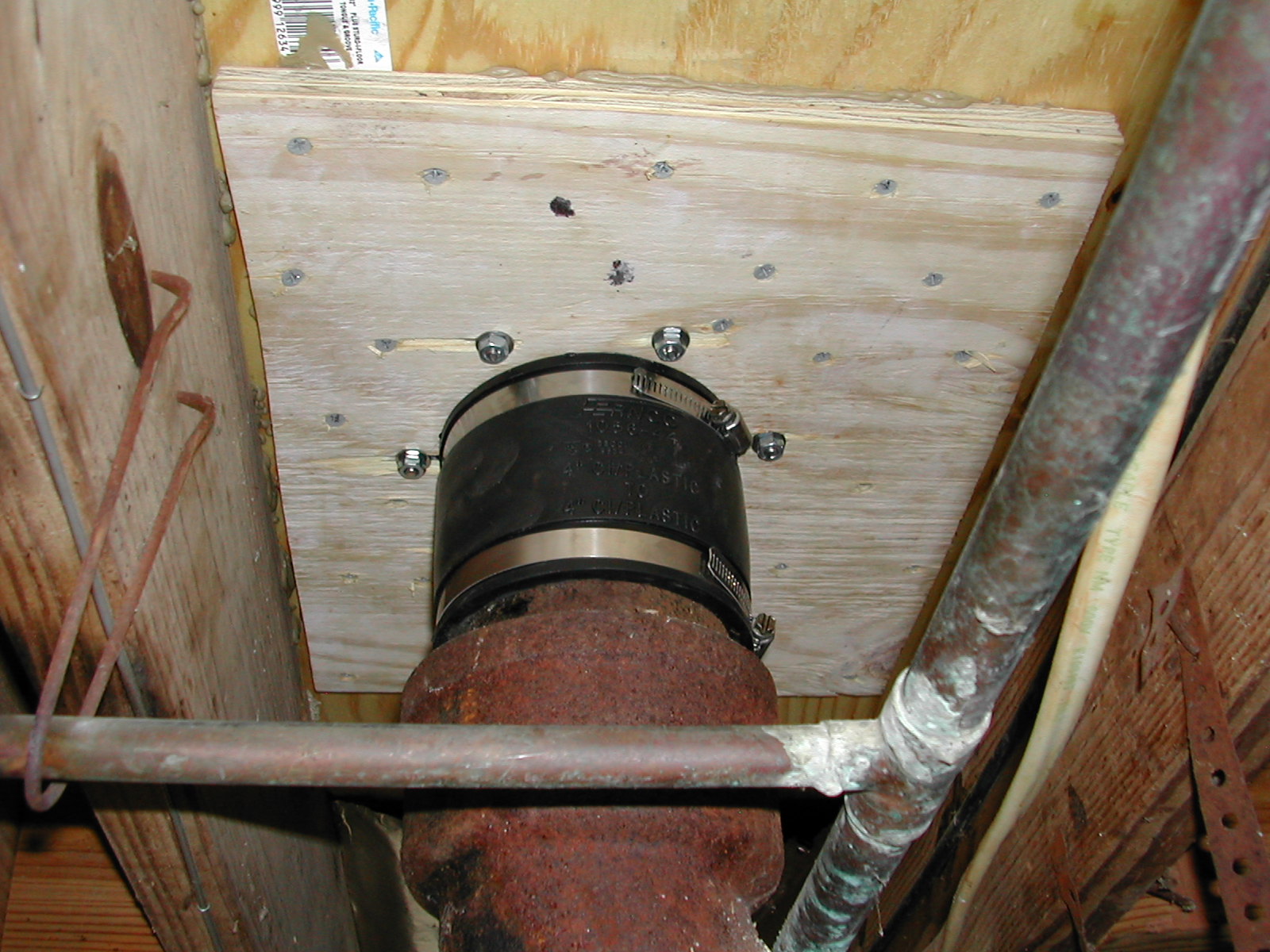

Big problem of the day is I realized I cut the hole around the toilet drain too big. The closet ring just hangs on the outside edge. Absolutely not good. And no "easy" fix. I know why I did it, bell mouth cast iron pipe, clearance to get the ply in over it etc. but I sure did cause myself a HUGE problem. I figure just like lowering the pipe, the answer will come up immediately after I do something I cannot reverse.

Al on the closet flange ,here's one option if you have acess underneath.
cut about a 1 foot square of plywood ,cut out a circle a little oversize of the outside dia. of the outside flange hub. This is the coupling on the bottom of the flange.now cutit in 1/2. Make sure if fits well. add const. adhesive and screw it up to the sub floor. the larger the patch the stronger. May not be the best solution,but it's a start. I think You two are burned out from too much work. You need a date! Take Mom outa town for a couple of days. Good luck Tool

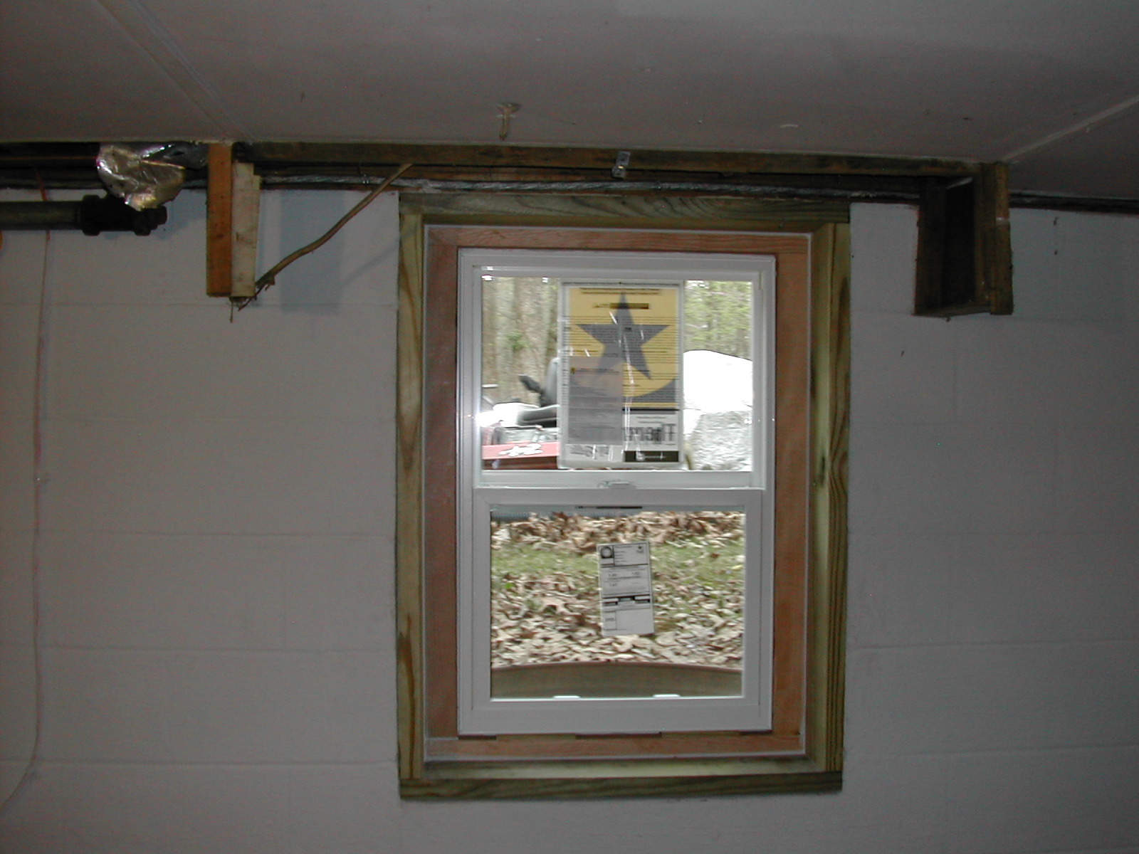

Toilet flange and basement windows were the two we picked to tackle, and he also took care of getting the vent through the eave that had kicked my butt yesterday. We fixed the toilet flange pretty much as Tool described. Lots of construction adhesive, lots of screws, tight accurate hole, it is real solid, all tied together and screwed into place. It came out well.

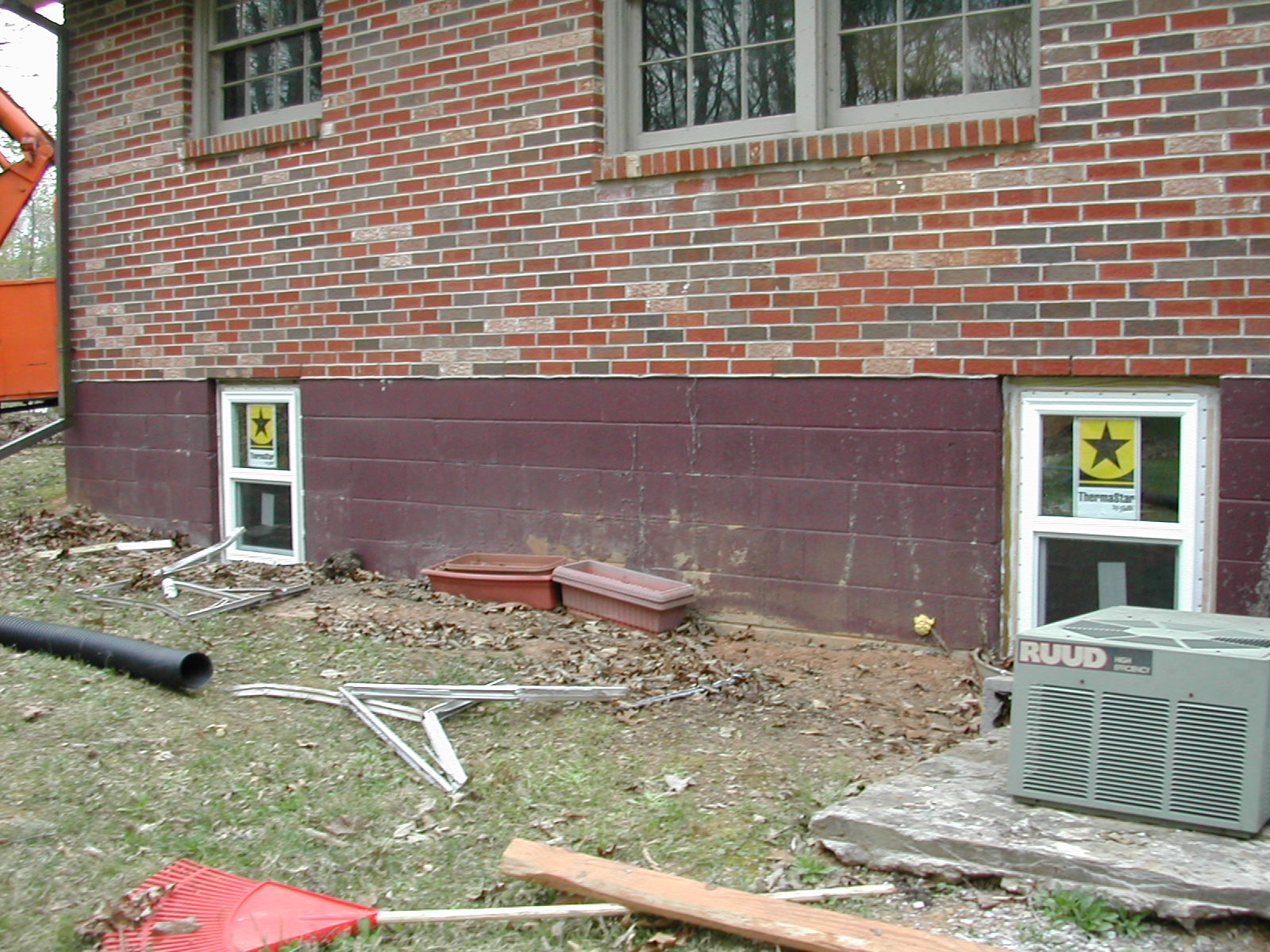

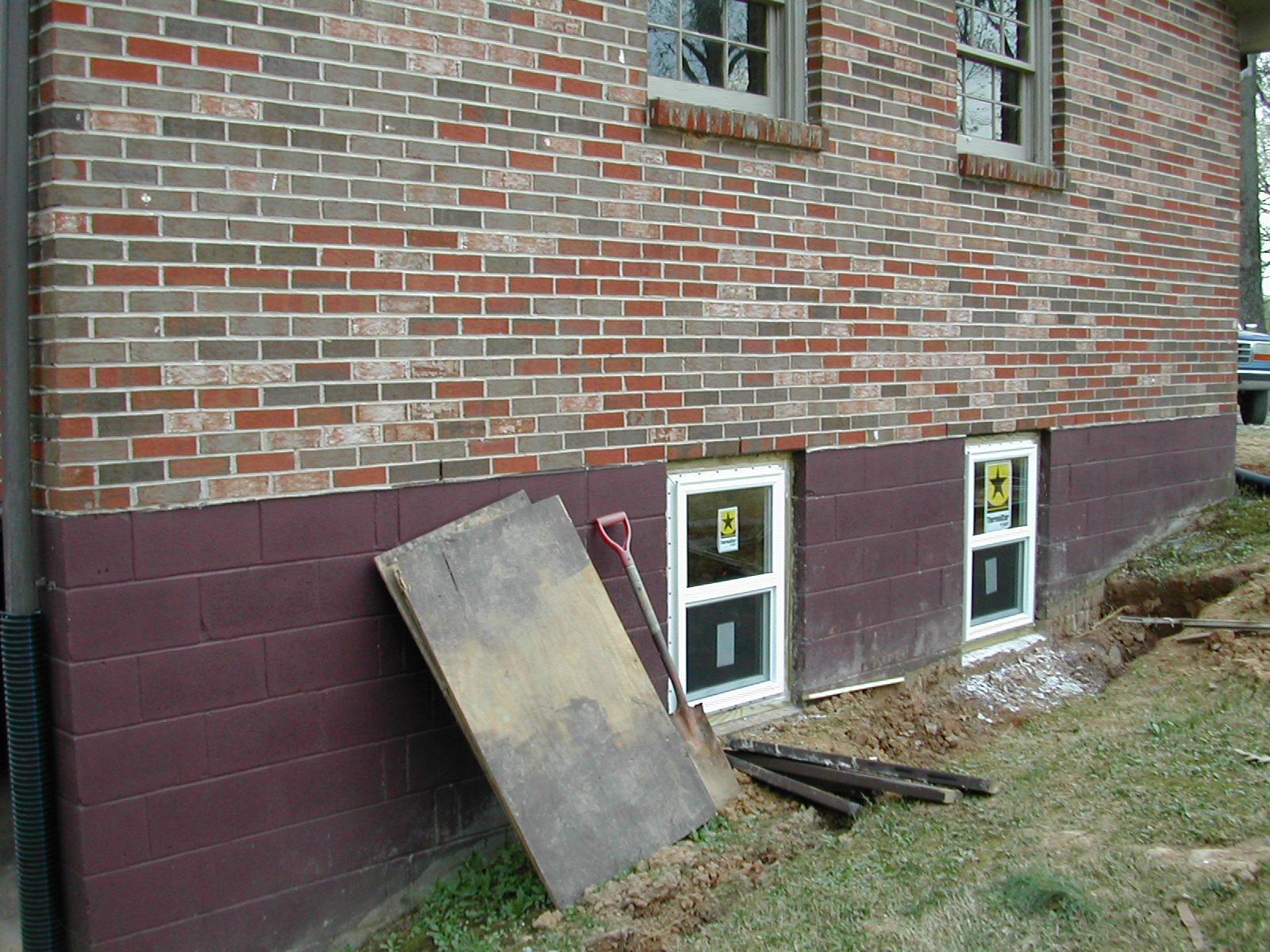

We also installed the 4 basement windows. Went with a standard 2 X 3 single hung double glass Pella window for $72 each from lowes, and made the frames to fit. I can finish cutting in the paint and sealing etc. now.

2039, the hole that about did me in.
2058, the hole that we are done messing with :D
The rest are my new basement windows.

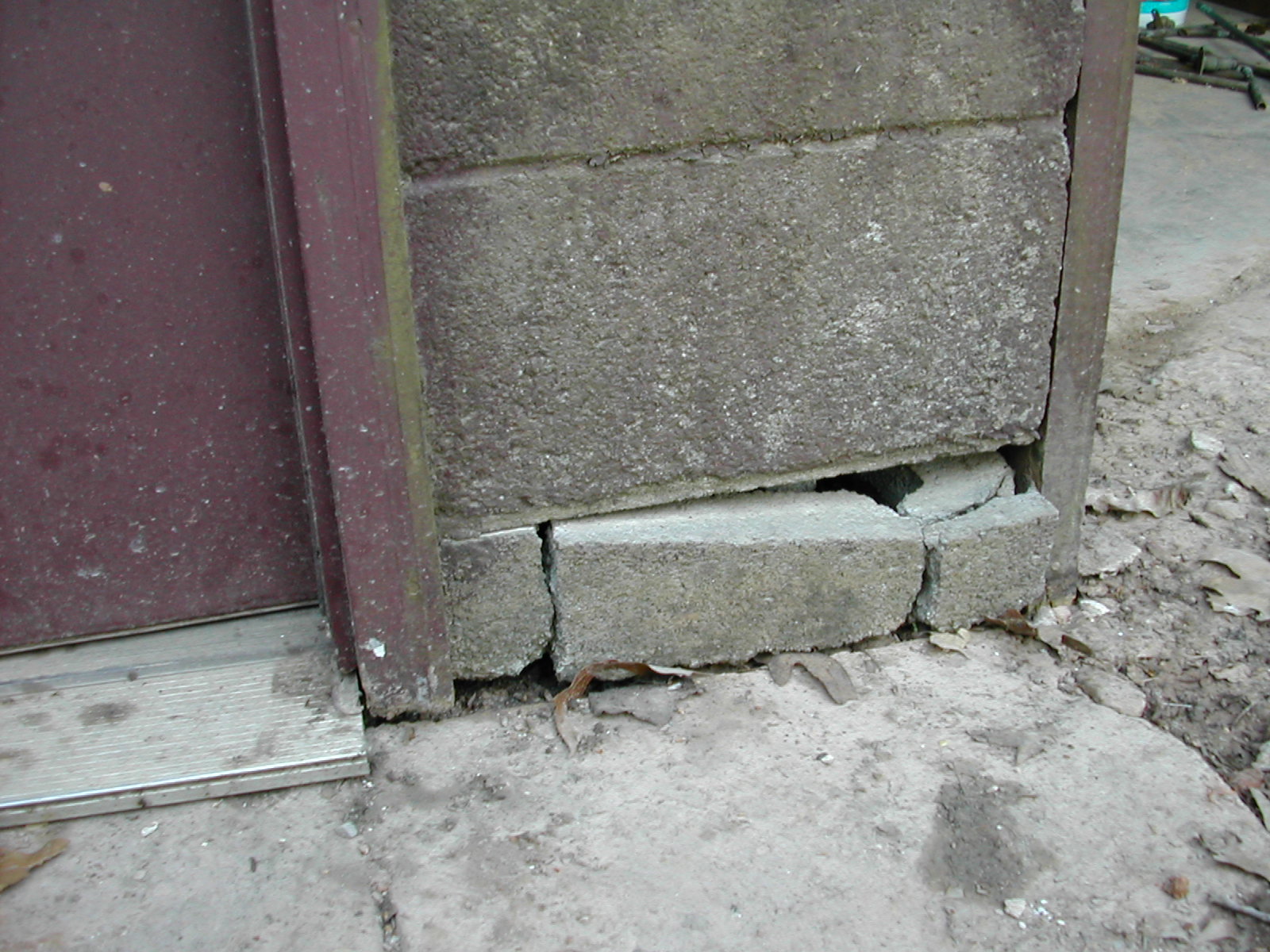

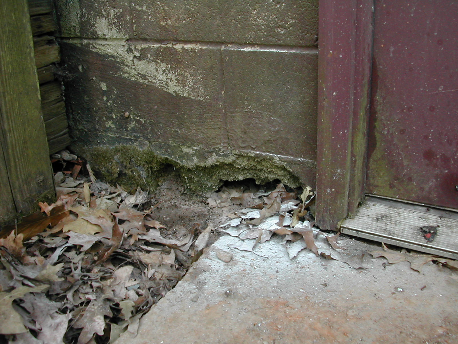

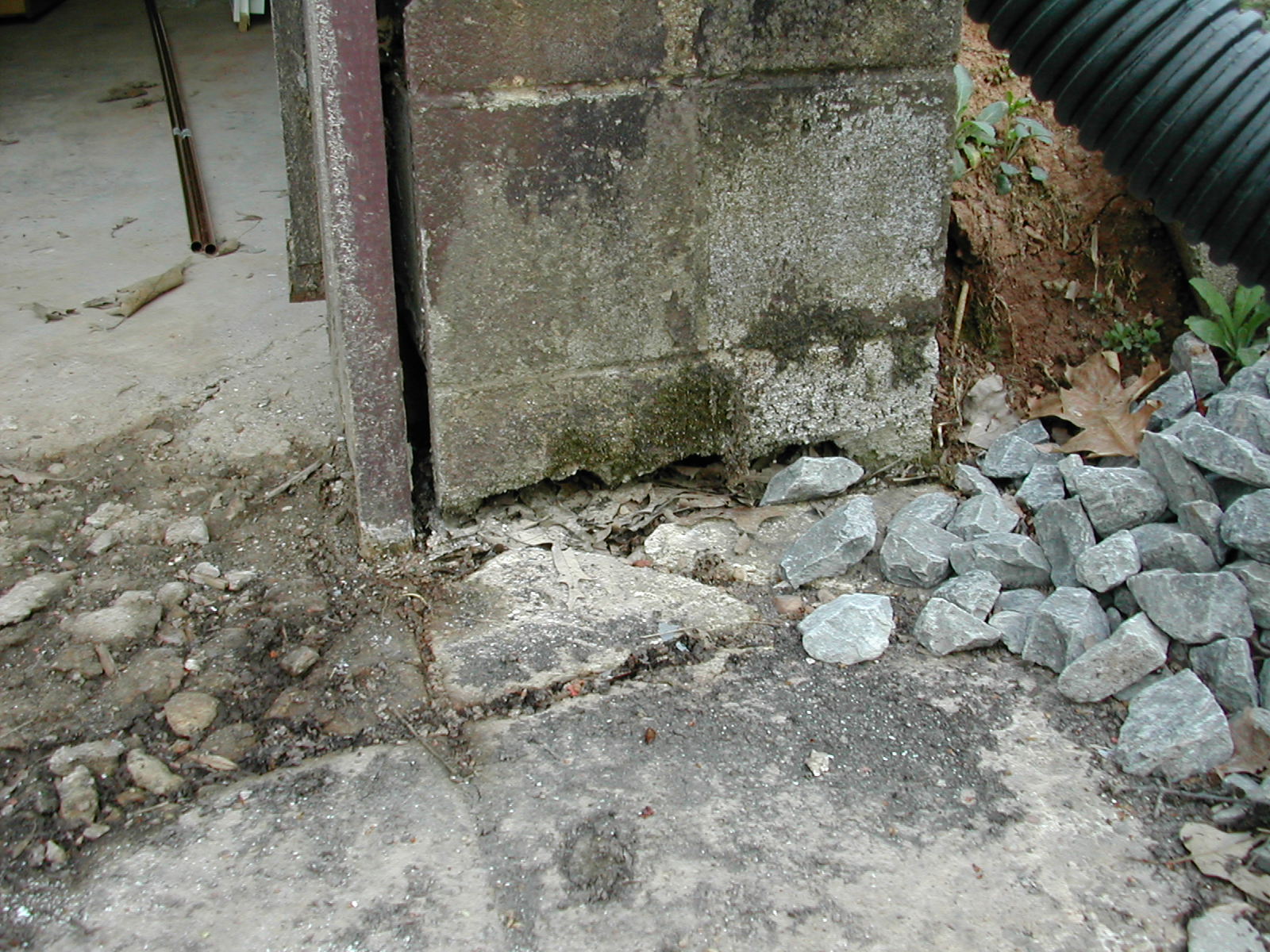

These are the blocks down by my garage entrance that all the water has ate away over time..... Now this will be an interesting project unto itself. Now if I can just get my dad to bring me up a new rolloff door that I need.
I think I will do them all one at a time, 3 seperate pours, I do not think they poured the blocks so I will go up about 4, and start pouring in from there, do about a 3' by 3' pad about 3' deep underneath each one.
Block and support the garage door while I do one at a time.
Any thoughts appreciated.

Great bath floor repair,look's solid. WE do it all including retaining walls and drainage. In the Bay area we always have Geo. techs.aboard. Great teachers!
Gutter leaders [down spouts need to be tite lined to past lower found.. Over the years that water washed the fines from under the lower footings. I'll bet an apple pie the rear of the house has settled. Allways does with any kind of slope and mis directed water. code on hills here, makes us discharge tite line 12feet below the lowest found with a defuser. You could skip pour new footings.
see ye Tool

It suprises me that it has not settled much, but it is certainly right around the corner.
The drainage on this house is non-existent, what they could do wrong, they did, to include some hilarious things (well, maybe not so hilarious) Like pumping the condensate out of the basement, then draining it back into the basement.................... Go figure.
I assume skip pour is making new foundations say a meter or two, then jumping or skipping a meter or two and doing it again and then filling in the blanks slowly? That is what we did on one BIL's house in Germany. Long and complicated rules, but nothing like working in a celler, under a basement, under a three story house, built I think in the 1600's and removing the sandstone and pouring in new footers.
Basicly, that is what I plan to do, and then tie it all together with Rebar at the end pours.
I need to do the gutters and fascia, well, I need to do the gutters, and I want the fascia right before hanging new gutters on them.
I am contemplating putting in a sump, with pump, right at the back corner of that garage, then directing my drains etc into that, then pumping it to the other side of the roll of the hill. At least I am now well aquainted with a guy with a backhoe :)
