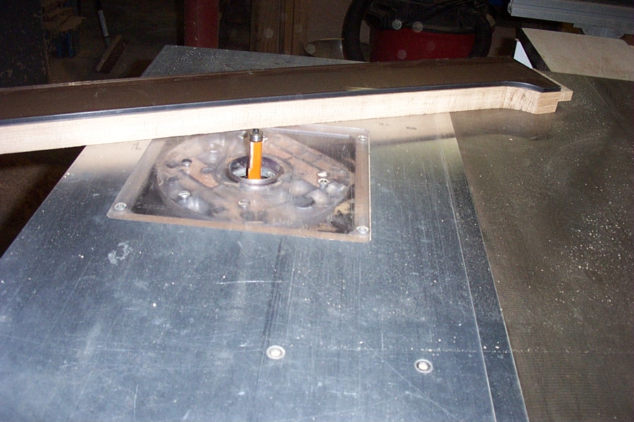

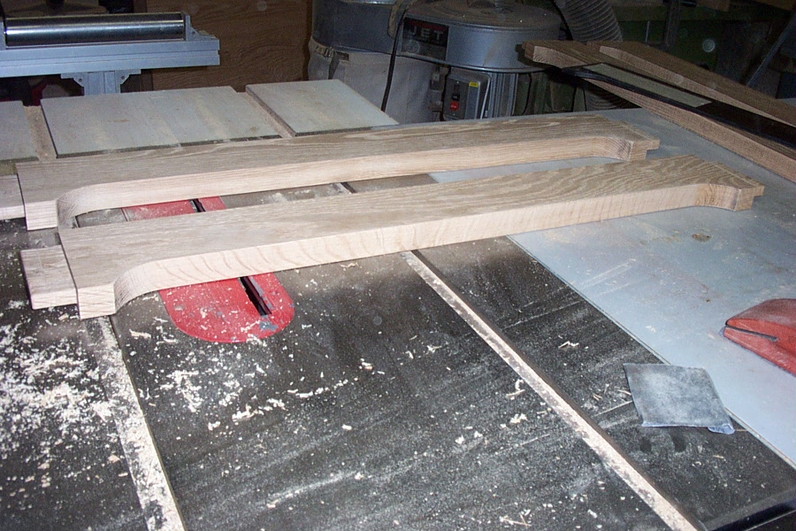

Today I whipped up a template to relieve the bottom sides of the aprons. I used 1/4" lexan and kinda cheated using a CNC Bridgeport miller but you could just have easily used 1/4" luan. ;)
As you can see in the first pic, I use a 1/2" follower bit in my table mounted router. I used double back tape to afix the template to the apron but you can also drill a couple of small holes and just slightly tap in finish nails so the template wont move.
This method gives you a nice smooth surface and you can generate any profile that your heart desires ! :)
The second pic is the aprons finished routed.

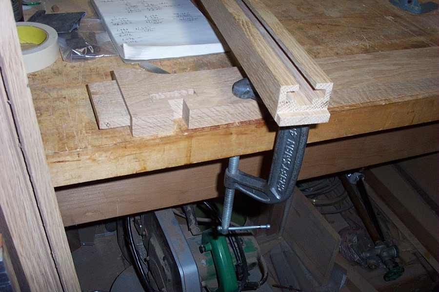

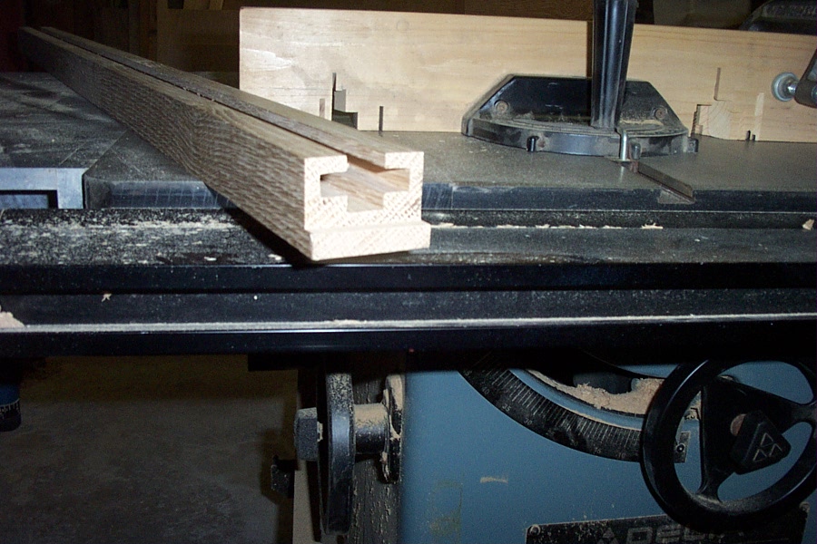

First pic is the t-slot rails that will be mounted inbetween the end aprons.

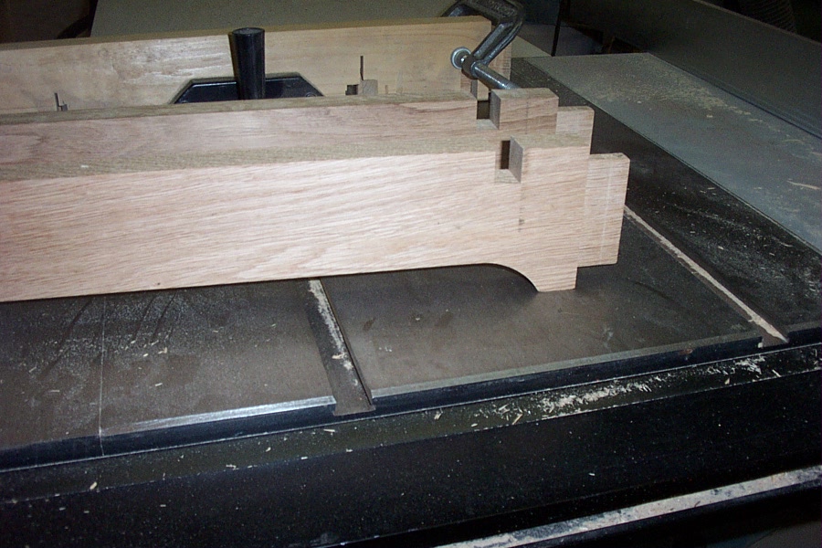

Second pic is the apron end cut for the runners that will attach to the bottom of the top.
Third pic is end aprons mortised.
Fourth pic is the t-slot rails fitted to the end apron.

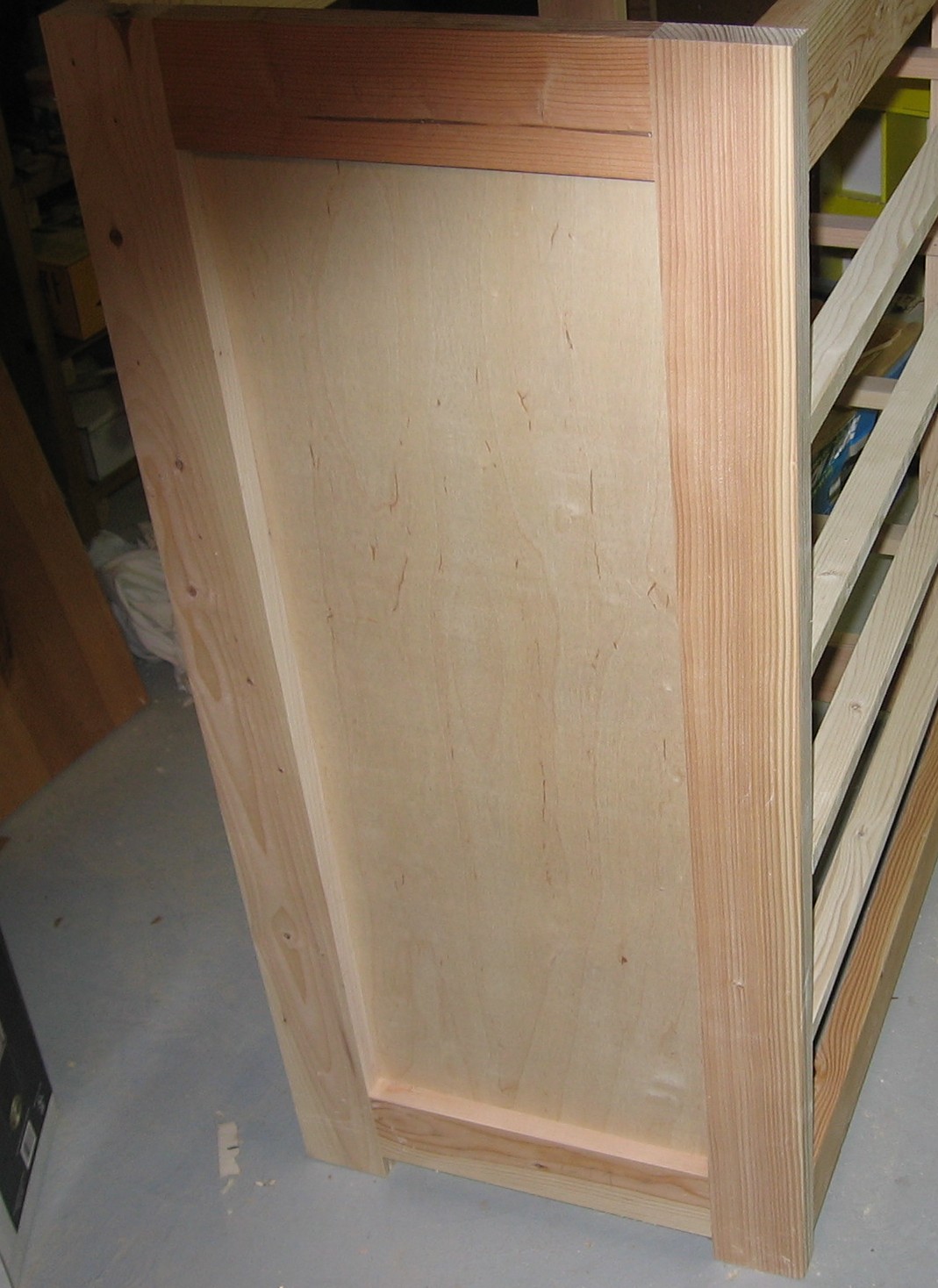

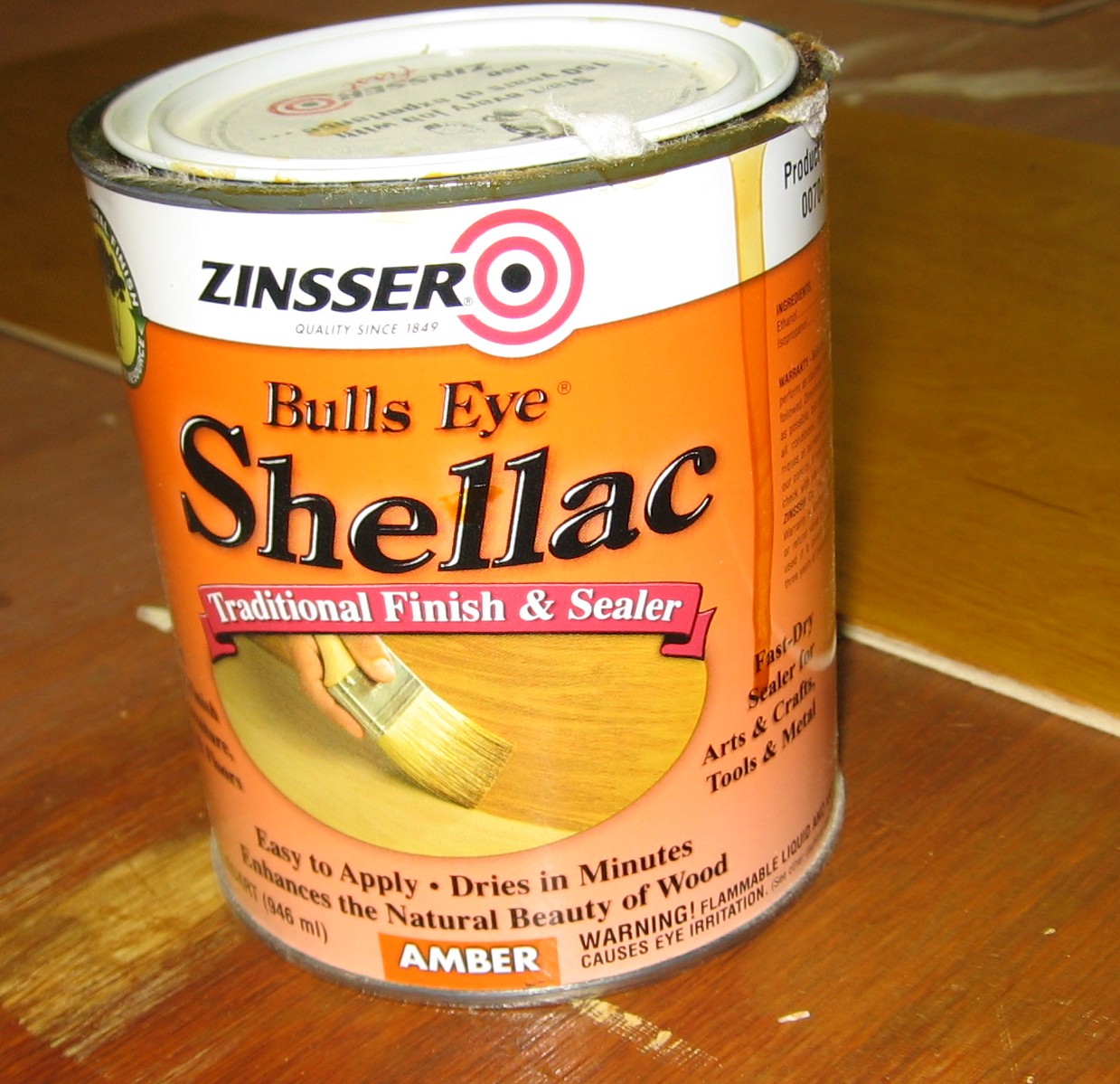

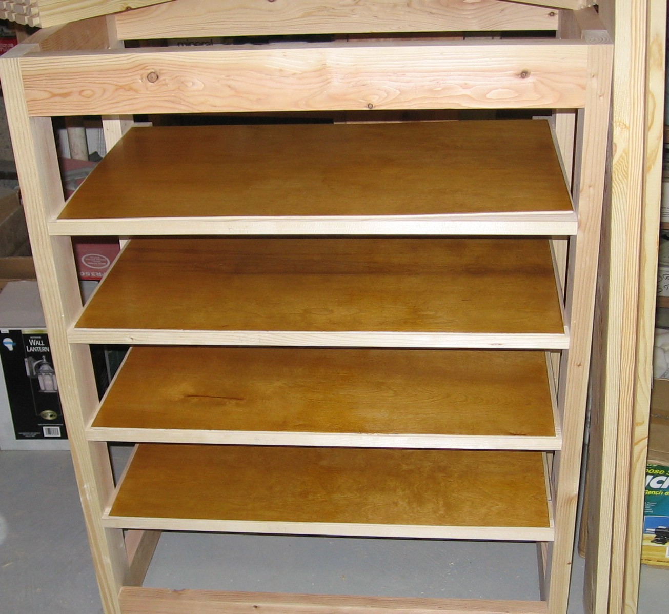

I took some photos so folks would see what a little stain and Shellac will do for cheap birch plywood. Here I've used honey maple stain (carver tripp) and Zinsser shellac.
The first photo shows before and after. A drawer bottom and a plywood leftover piece.
The second photo shows some of the the drawer bottoms racked for drying on the drawer rails.
The third photo shows the type of Shellac I use. I like the premix, although on some projects I mix my own from flakes. Here I've used the Amber because I like the depth it gives on light woods.
The last two photos are the side pannel with and with out the finish applied sitting in the spot where it will eventually be attached with a surround molding.

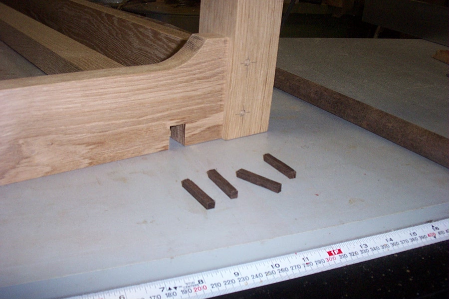

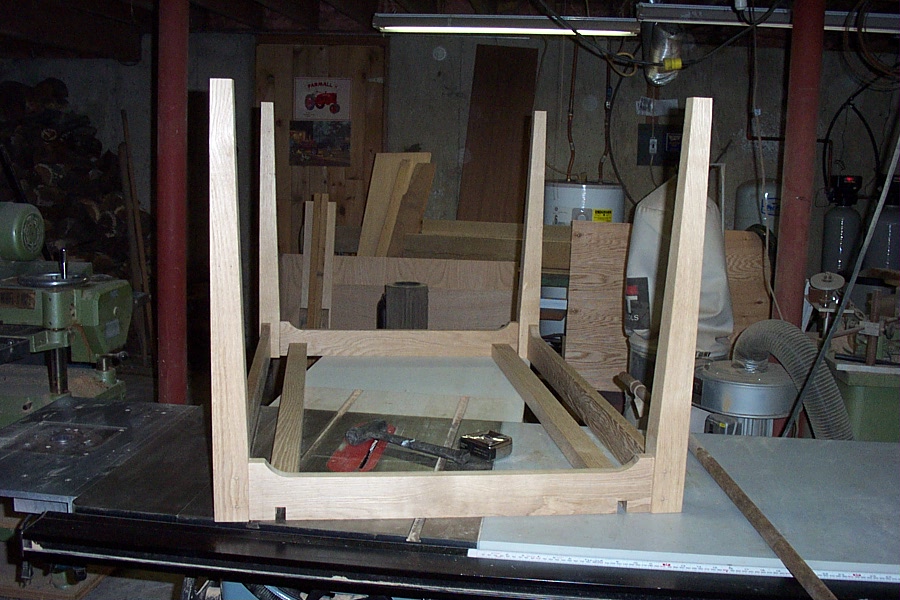

In the first pic I have the whole base dry assembled.
Second pic is the brazilian rosewood pegs I will be using to pin all the tenons after the final assembly. I also just put in the shallow mortises in the legs where the pegs will be positioned.
I see alot of sanding in my future which is pretty boring stuff, oh well, gotta do it ;)
BTW The rosewood pegs will have a diamond shape on the proud end and they will stand proud about 1/16" above the leg surface.

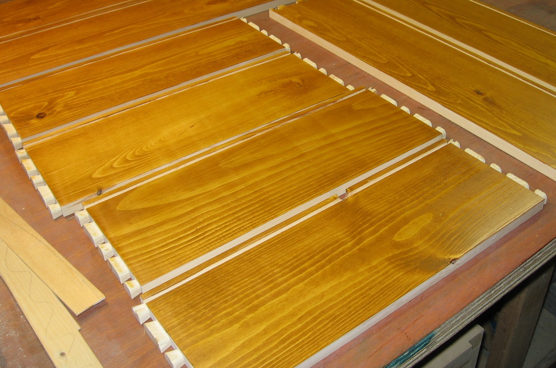

I stained and shellaced the insides of the drawer sides. Here's how the finish looks on pine.

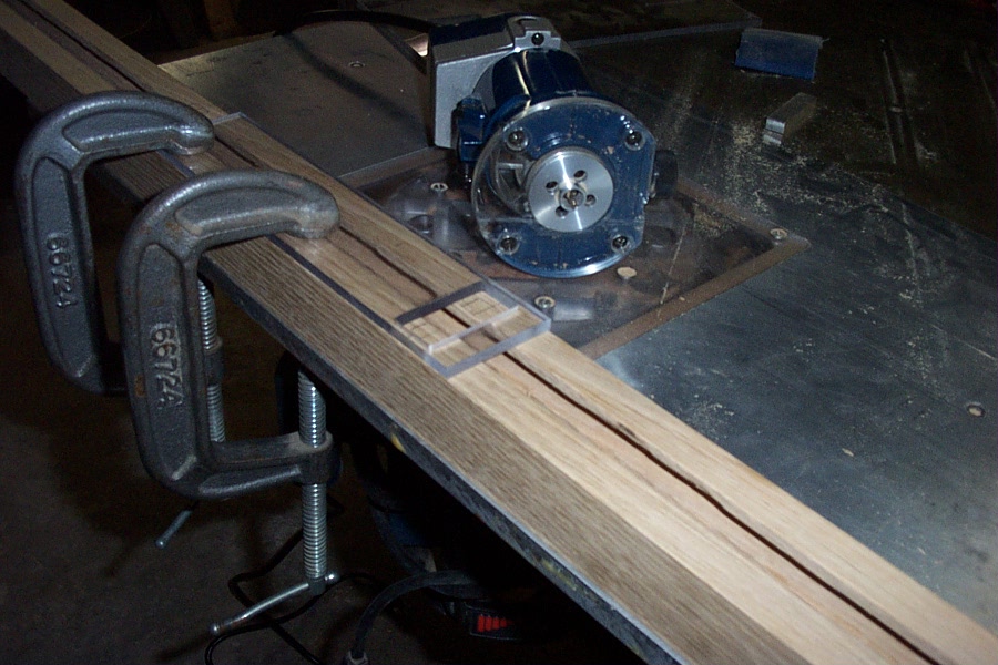

The first pic is using my laminate trimmer to put the cutouts in the t-slot rails.
The second pic is the t-slot rail cut, and the guide rail with the hardwood dowels that will slide within the t-slot rail. I made up a guide bushing for the trimmer for small jobs like this.
The third pic is the guide rails with the hardwood dowels.
