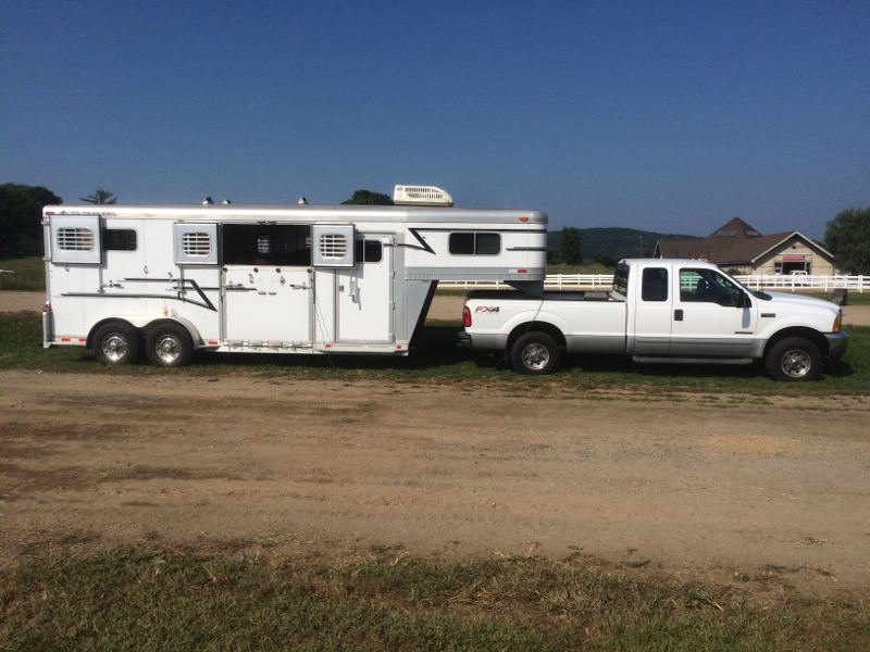

^^^ that's the issue we have, I have a sharp breakover starting down our driveway. Very, very little clearance and the trailer is a bit high in the front.
IMO they should make them with a bit more clearance.
   / allowable weight on a gooseneck? #19
Some are better than others. I had a Stidham at one time that was custom built for the NFR show fiveteen years ago. The roof was taller like a thoroughbred, and the floor of the bunk was raised up the same amount. It made a normal size bunk with better truck bed clearance.
I've seen guys with toybox trailers put a lift kit on them to get better bed clearance. That would work for a horse trailer if you had a ramp gate.
   / allowable weight on a gooseneck? #20
I guess I am lucky then. I have about 11 inches of clearance. image-3585950482.jpg The bunk on mine is a little low. Wish it was about 6-12 inches higher, but there is no problems. The total height including the AC unit on the top is under 11 feet. As I look at other trailers at this horse show they are a lot lower to the bed than mine is. That's my 2001 F-250 4x4 with an Elite trailer. Two horse straight with one horse slant. Most of the time we just set it up as a two box stalls. I can see problems if you raise a pickup up 8 plus inches.
