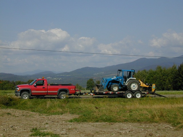

A picture of my trailer set-up.

How do you like it ? I bough a Duramax about 20 months ago. 55,000 miles so far no problems 19 mpg average. My first diesel. I have a 12' B&M trailer but I want to get a 16' trailer next year. I have tie downs that are bolted to the wood planking and I want welded steel ones. I drive about 16 hours a month with the tractor on the highway. Nice photo. Dave
