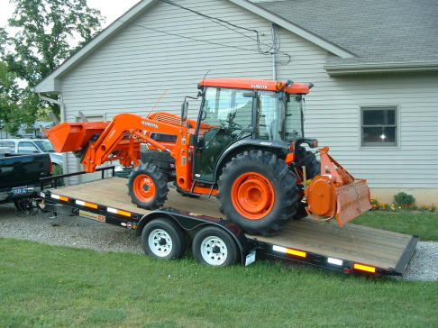

Here is a picture of my 20' H & H hydrualic tilt trailer with my 4330 on it. I love the tilt feature! I also like the 20ft length much better than the 18' I used to have.
Good Luck.
