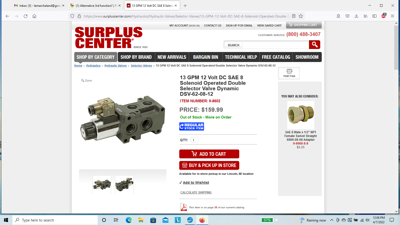

Doesnt this valve connect both sides of the circuit to each other? so fluid moves either direction?
However, thinking more about this, i realized that these cylinders have different areas on each end (due to the rod) - and thus different volume-per-inch-moved. meaning this wouldnt work in EITHER direction:
  • compressing the cylinder would just overpressure the rod end, not enough space for fluid from bottom
  • extending the cylinder would ~cavitate the bottom, too little volume sent to the bottom side
Now I'm confused because while i don't see how LD1 could be correct - it seems NEITHER way works on common cylinders... and yet that's the cushion valve's stated purpose
Yes, the different piston areas/cylinder volumes is why it doesnt work. The cylinder physicaly cannot compress without fluid leaving the system.
It can however still extend. Yes it will "cavitate". It will draw a vacuum on the cylinder, introduce air, etc.

I've been wrestling with the same issue and holding off adding a third function to control the new grapple I recently bought. For me, if there is some additional relief valve or whatever protection I can add to the system, I'd be happy to spend another $100-$200 and possibly more if it would protect my tractor's hydraulic system at a relatively affordable price point.
The good thing about forks is you can build them so they bend before you damage the rest of your tractor.
So the other approach that comes to mind is to rebuild my grapple lid with some kind of shear pin that would break first. Or sell the grapple and build a set of forks.
I'd also rather learn from all of you before I break something instead of getting an expensive remedial education at the dealership repair shop.
