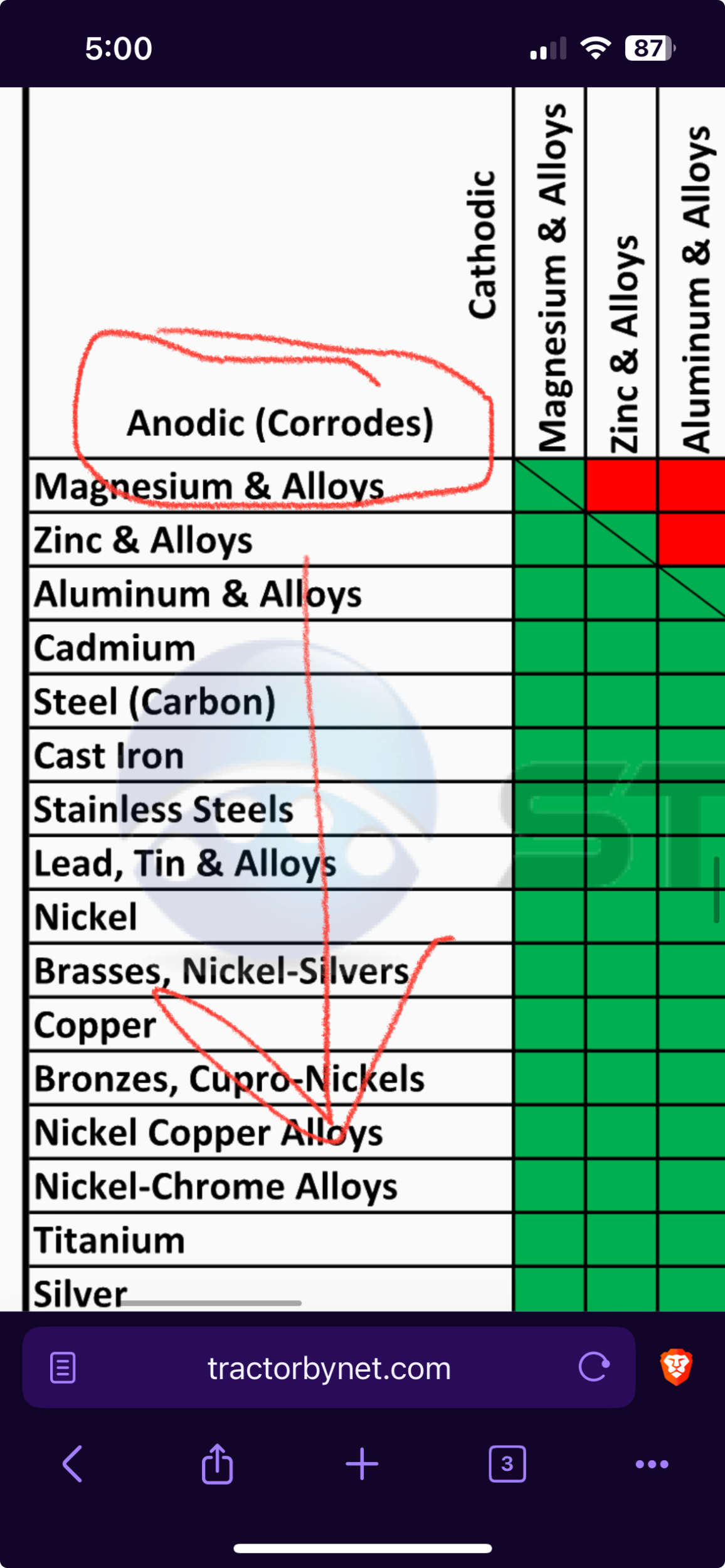

There is something about the chart I don't understand.
If I start with aluminum, and go to the right over to steel, it is red.
But if I start with steel, and go to the right over to aluminum, it is green.
What am I missing?
Each row is referring to what metal will corrode first when in contact.
Take the first row. Magnesium will corrode first when in contact with pretty much everything except itself. Now go down to Aluminum. It will corrode before everything except Zinc and Magnesium. Now down to steel, it'll rust before cast iron and after aluminum.
This table is why posts above said you'd be okay with aluminum-steel contact if the steel was galvanized. The zinc galvanization will protect aluminum too but if it wore through or failed the aluminum would be next in line.
What am I missing?
