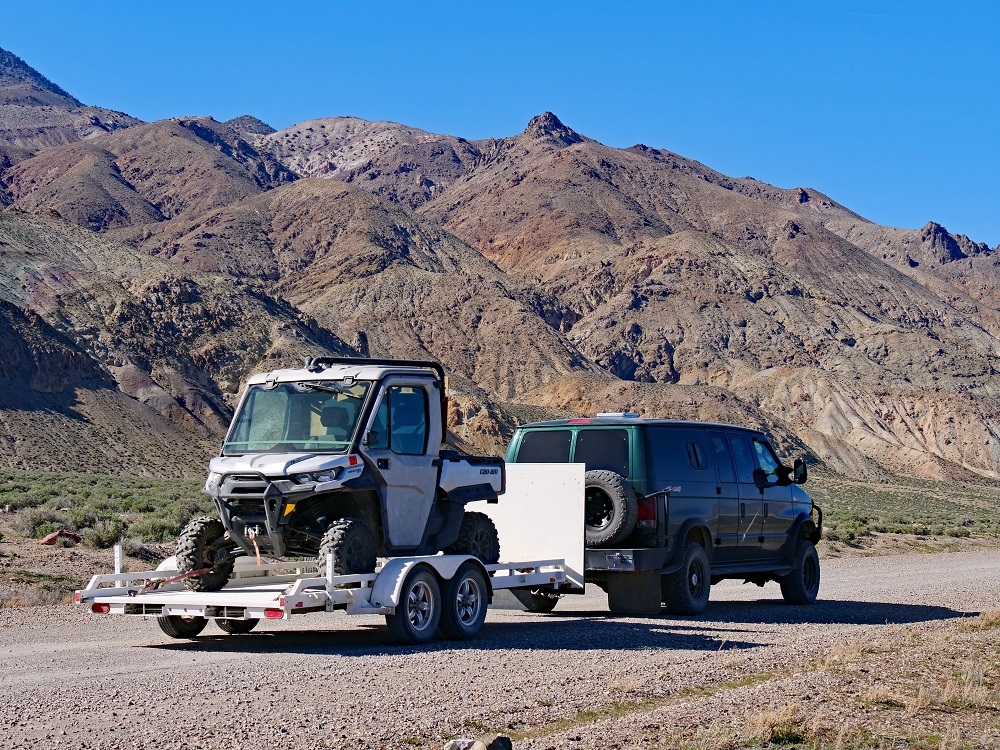

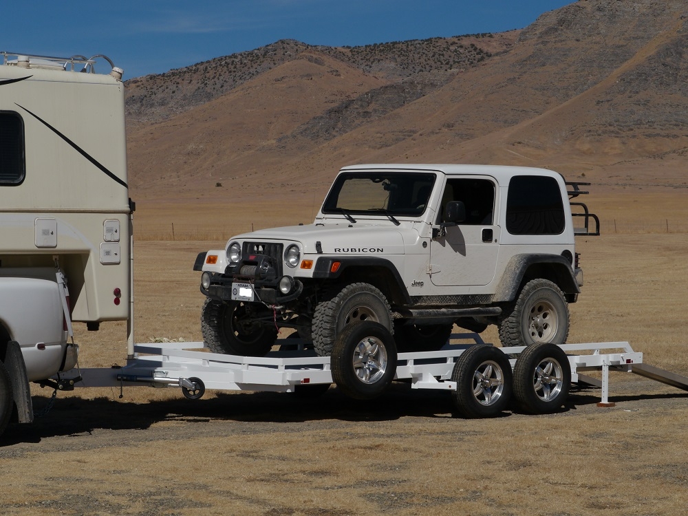

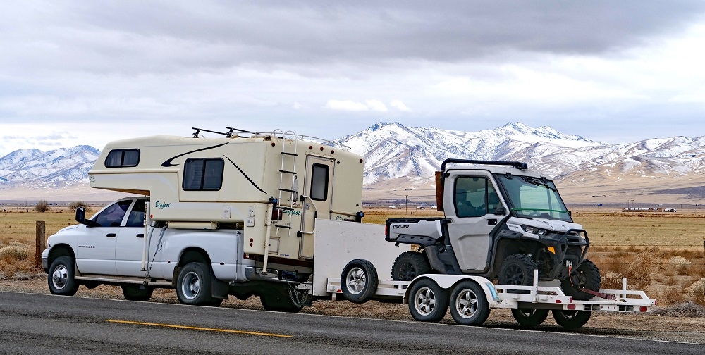

I wouldn't be afraid of an aluminum trailer at all, considering your application. 8 years ago I bought an Aluma Model 7816 all-aluminum trailer and it has held up perfectly despite being used mostly on washboardy dirt roads. It has thousands upon thousands of miles on it - I've towed a car on it to Texas from Nevada, and my Jeep all over the west coast and my side by side also. I've had to do NOTHING as far as repairs to it. I did paint it white because I preferred that to the aluminum color (deck is aluminum also); I also mounted a 4' high piece of plywood across the front because gravel off the towing vehicle's tires was messing up paint and glass on whatever was on the trailer. The fenders are quick and easy to remove in case the car doors don't clear.
That looks pretty solid! My uncle recently retired and looking to hit the road more often and bring their quad bike. His F250 got a new camper so he had ordered new tires and dually wheels, and will be looking for a new trailer next.

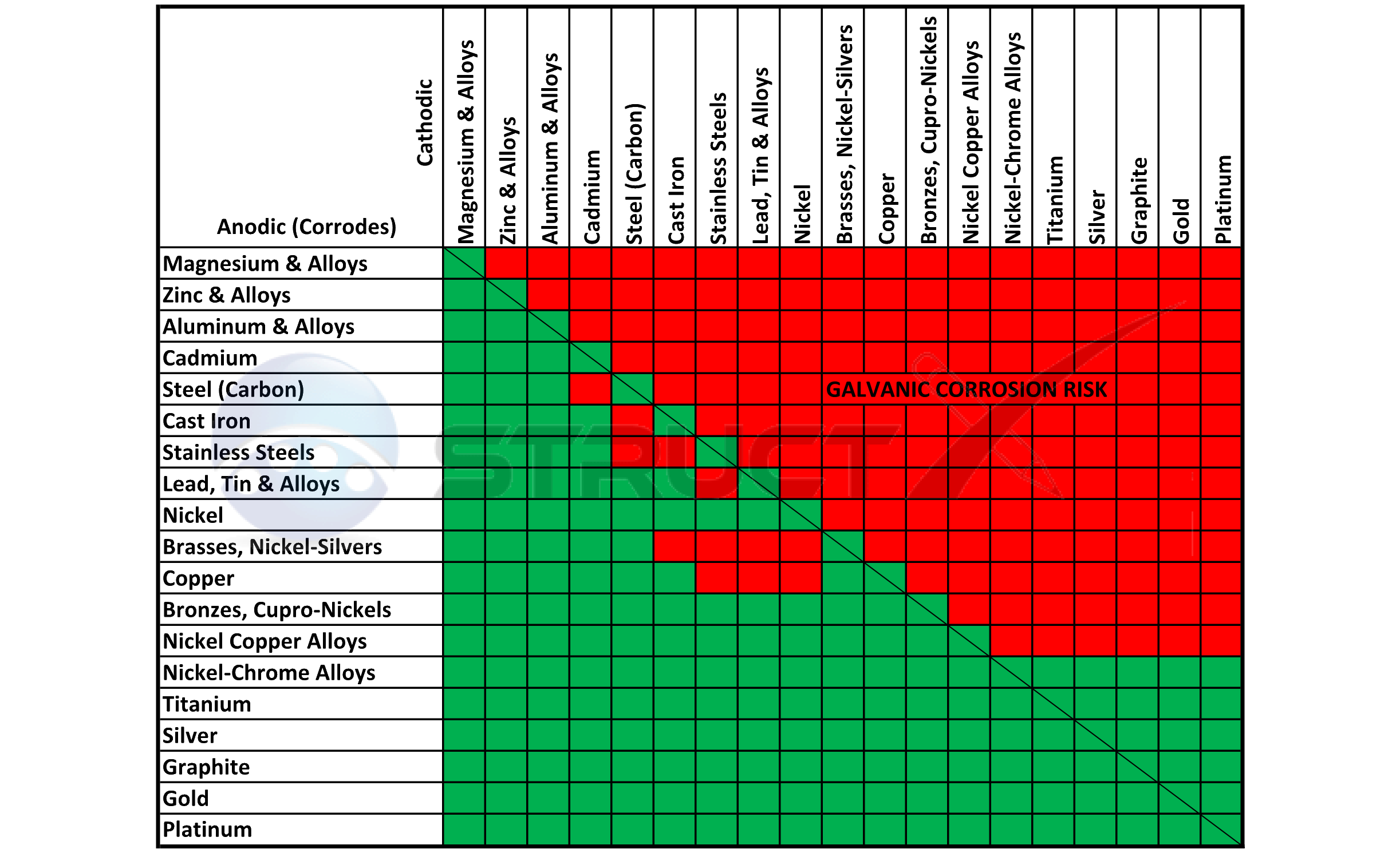

Big mistake. Aluminum and steel are far apart on the Galvanic scale. The Aluminum will rot away in a few years.
The below table can be used as a quick guide to select compatible metals. Where two materials meet in a green region the corrosion potential can be thought of negligible, meaning, a good combination. Materials that meet in the red zone however should be avoided or used with caution.

Al on Al is fine. It becomes a problem when dissimilar metals touch. The time for the Al to rot away depends on the conditions. Salt, water, damp operating and storage conditions will accelerate the process.
Places like steel bolts holding on a metal part is where you will see the problem.
Dissimilar metal issues can get involved, and I, by no means, are an expert on this subject. There is a lot of information on the internet for those who wish to learn more.

If he uses galvanized steel, and galvanized fasteners, he shouldn’t have any meaningful corrosion
   / Aluminum car trailer vs steel
#20
There is something about the chart I don't understand.
If I start with aluminum, and go to the right over to steel, it is red.
But if I start with steel, and go to the right over to aluminum, it is green.
What am I missing?
