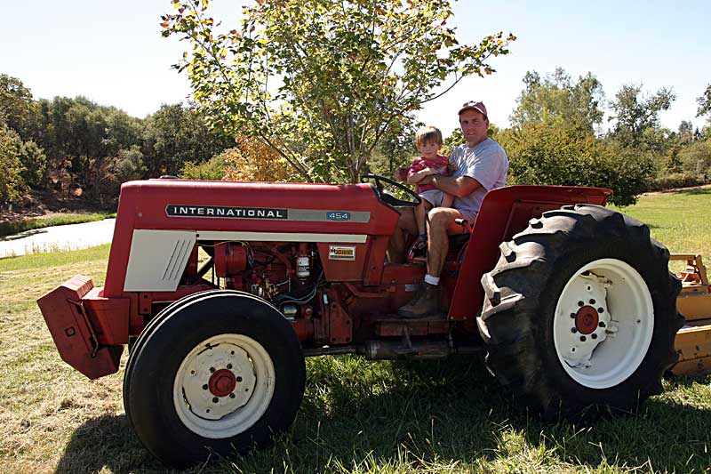

Remember old Prunty C. He was a hard core 2WD guy. I really do not know if he ever tried a FWD or MFWD, but I know I share much the same sentiment as you. I had a 2WD, a International 454D. It was a massive cast iron beast. I really liked it. I grew attached to it, but frankly, my much smaller Kubota 4WD was so much better at getting in and out of tough spots, up hills, down hills and with loader and box scraper use, there simply was no comparison. It easily outweighed my Kubota by 2000lbs even without the International having a loader but could not pull the box scraper that the Kubota did so easily. As a flat field mower though, it did marvelous.
   / Aluminum really inferior for tractors??? #14
Nice tractor. I totally agree after my experience. That is why I'd disagreed earlier with the sentiment that the lighter 4X4 CUT's would only be good for flat mowing. My experience showed exactly the opposite. For mowing flat fields or highway medians, your old 454D would be excellent. It's all the other jobs I found the 4X2 to leave me seething. Oh well, even hard headed me eventually learned; albiet the hard way...:eek:
