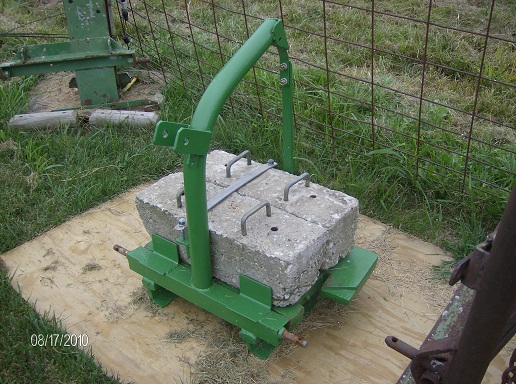

I had fixed up a "ballast unit" for my JD 790 out of things I had 'laying around' (see pic.).
After a year of searching, I found an unused John Deere ballast box on CL for $80 about 100 miles from home. Went after it, then on to Des Moines for a "day trip". Today (between rains) I've been cutting up the old unit to put the iron into the box. Still need around 300#, some of which I have at the farm, to get the recommended 600#+. I don't want anything permanent in it so I can easily adjust if need be.
This frees up my two 100# suitcase wts. for other uses when I need them! ~~ grnspot
