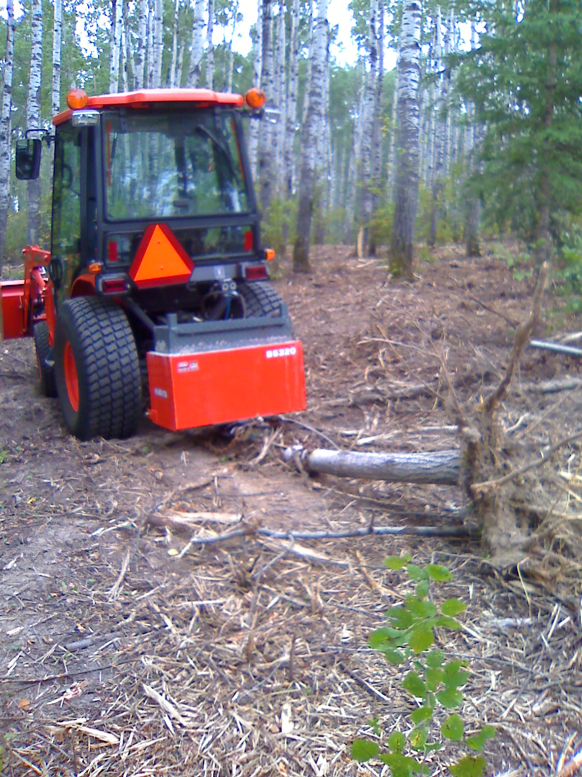

I got a ballast box with the tractor when I bought it. The dealership wanted to fill the tires but I don't always want the tractor to be that heavy so they didn't fill the tires and 'gave' me the box instead. I filled it with scrap steel and concrete with a frame embeded in the top for carrying chains, chainsaw and other things. I also bolted a hitch receiver to one of the slabs of steel inside before I filled it with concrete. I figure it is around 900 lbs. If I am digging dirt, pulling out stumps or dragging logs there is nothing better or I can put a drawbar in the receiver and move trailers around.
Compact weight, low center of gravity and space to carry extra stuff.
