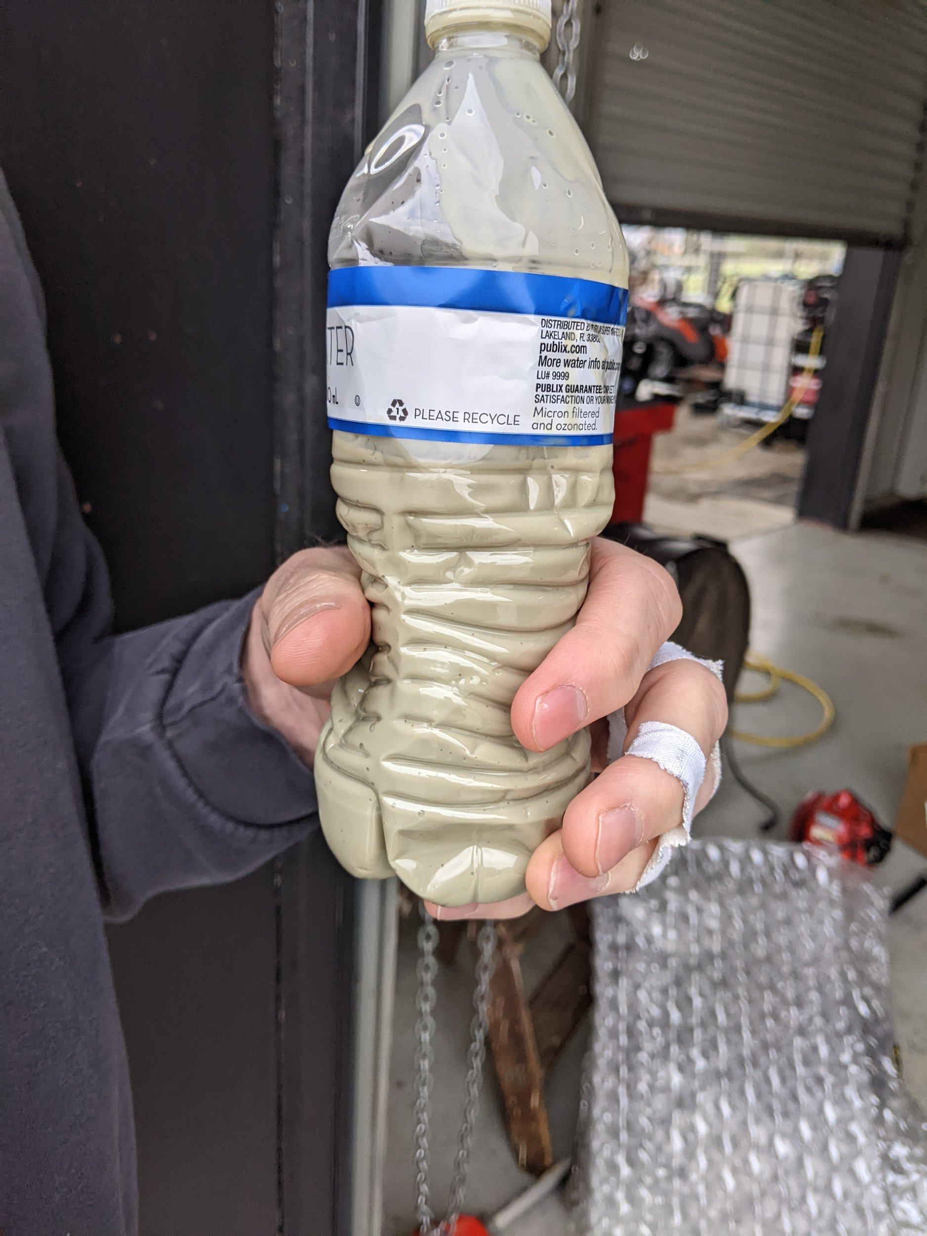

Your friend has a cracked block/head or blown head gasket that is allowing coolant to get in the oil.
Its air cooled so no coolant to get into the oil.

Water can get into the crankcase thru condensation. As the unit sit in the crate or on display the air changes temperature of course cooling and heating of the engine will cause moisture to form and will drain into the oil. Remember the crankcase is not closed to the atmosphere and air can freely enter and exit. Condensation inside an engine is exacerbated when an engine is started cold and not allowed to warm up before it is shut down, and is especially bad when it is done repeatedly and the oil does not got hot enough and long enough to "boil" the water out of the oil.
As for smoke at start up. This is very common on vertical engines. Oil lying in the cylinders can go one of two ways depending on the position of the engine. It can run back into the sump or it can slowly seep past the rings and can be made worse if the ring gap is on the bottom. even if that being the cause of the smoke it will clear quickly and have no affect on performance or life of the engine .
I noticed the op stated it was a new mower to him but did not say anything about the manufacture date of the mower. Read the first of the sn to determine that. It could be last years model which would have more temp fluxuations with more chance of condensation.

Does it seem like condensation would result in that much froth? Could rainfall have entered or something else?
   / Am I crazy? Chalky oil in crankcase - 1 Hr old - Husqvarna ZTR #34
Actually all the above are possible.
We had a Husqvarna HUV that was run a lot and never long enough to "burn" moisture out of the oil. Don't remember all the issues but condensation caused a lot of problems especially in winter.
but yes it could be possible for water to enter by rain or pressure washing or even under the edge of a roof.
