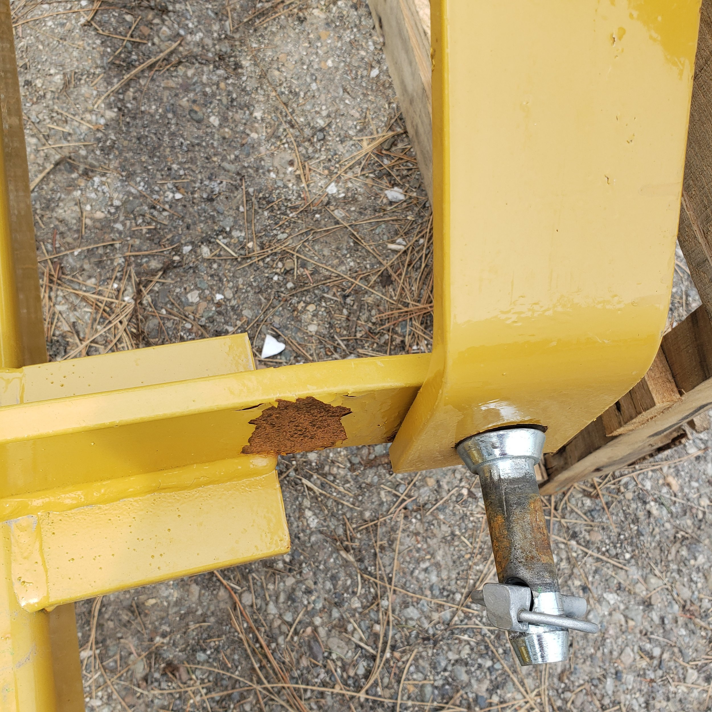

My boss got a 6' Countyline box blade for our 4052r and I wish he'd spent a little more on a heavier duty one. We haven't used it much but two ripper teeth have broken off tips and the steel is tweaked on both sides near the lift arm pins. Comparing it to other brands it is kind of a weak design.
