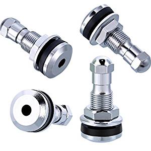

If you are stuck using normal 5 gallon jugs with the typical safety spouts that take forever to dispense 5 gallons there is a cheap and easy trick to help it breath and flow better. Get a tire valve stem for a tubeless tire and remove the guts from it. Drill a hole and install the valve in the back side of the jug where the vents use to be. Remove the valve stem cap to let it breath and flow better when filling up. It took mine from about 6 minutes to 2 minutes to empty a 5 gallon jug.
How to install a vent in a plastic gas can - YouTube
Great idea. Any problem with diesel disolving the valve stem?
Some have claimed that was a problem. Probably different rubber compositions. Use metal stems to avoid the problem.

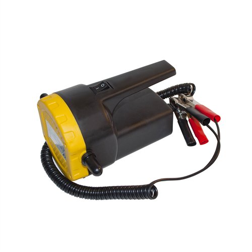

This pumps 5 gal in about 2 min from the ground to Top of tractor I just clamp it on a ground and the battery cable at the starter. Got it on Amazon for around $15 pump.jpeg
