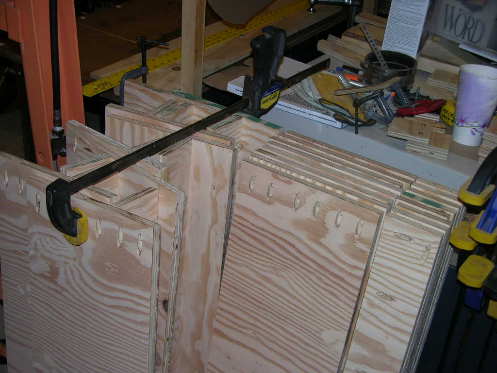

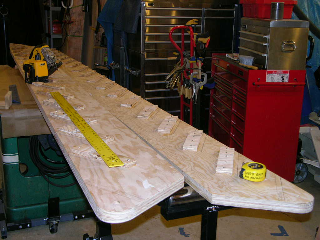

Dunno about polishing - maybe sanding, or drilling pocket holes - this pull-up staircase I'm almost done with has 527 pocket holes total, 4 full sheets of 3/4 ply, and weighs about 240 pounds total - with the 3-1/2" ribs under each tread there's zero give, and the double thickness of 3/4 glu-lammed risers flex just under 1/8" when I bounce on the middle. The mezzanine is 1-1/8 T&G ply over 2x12's, so I wanted it to not sag with me and as much as I can carry up or down - think I pulled it off :laughing:...Steve

I have to be careful building storage I just gather more stuff. Now thats a nice piece of furniture. Howcum you railroaded most of the treads? And ain't that Dewalt Jigsaw about the best $115 ever spent?
