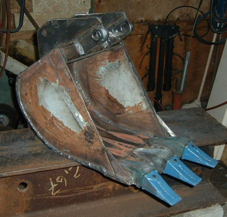

FWIW I used the Hensley 156 teeth on my bucket. They seemed kinda hefty for the 12" wide bucket when I was building it, but once I started using it they seemed to fit right in. I used top mount shanks as I wanted a smooth bottom to the bucket. They stick up a bit on the top, but don't seem to hamper dirt dumping out in any significant manner.
Based on this thread though I'm going to be a bit careful digging out stumps this summer as I start on the hedgerows at the farm. A.

Banjo, I see what you mean on top mount shanks. Good idea for a smooth bottom trench or footer ditch. Wish some of the excavating contractors that dug footers on projects I ran years back had one like that. Rolled my ankle a couple of times on the teeth depressions in footers while tying steel. Do my eyes deceive me?? /forums/images/graemlins/confused.gif Did you make the entire bucket or just do some rewelding on an existing one? Looks good either way but making it would be the better story. /forums/images/graemlins/cool.gif /forums/images/graemlins/smile.gif
   / Another broken tooth #26
Chris,
thanks for the comments, and glad to hear that I was on the right track with the teeth.
Yup I welded up the whole bucket. It goes with a backhoe that I also designed and built last spring/summer. I posted a few pictures in the photo area here, plus there are a whole pile in the Machine Builders Network photo album too here. Most of my pics start with "ADM".
So far the teeth have held up OK. I was digging out some big lumps of concrete clearing the way for a new front porch. I am going to start a bit more carefully when I start "weeding" the fence rows at our new farm this summer.
cheers, Andrew

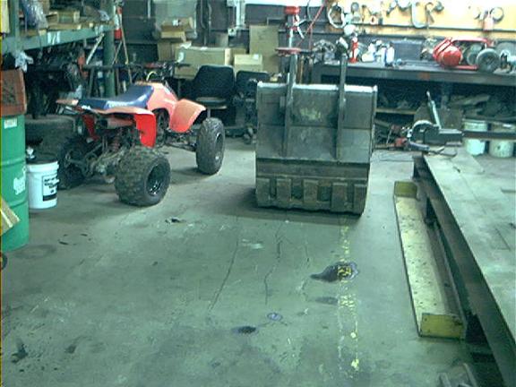

Check out this bucket with broken teeth. Saw it at work the other day and took a couple of pics. Was suprised to
see that could happen myself.

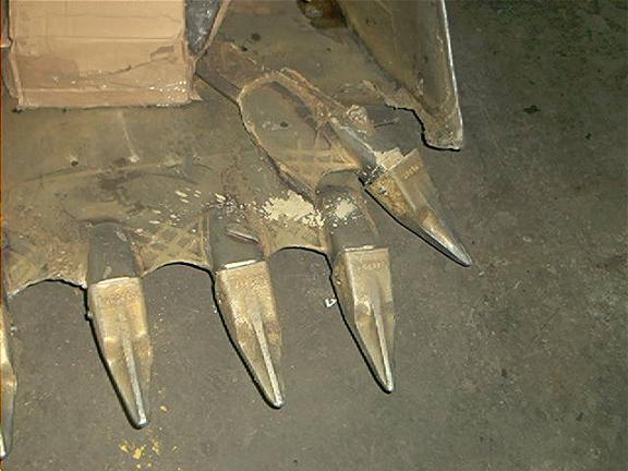

Sorry wrong side. Here's the damage.

One more angle.

Mark,
I think I would call that a broken bucket, rather than a broken tooth...
The tooth looks like it held up quite well... /forums/images/graemlins/smile.gif Just that the bucket area where it was attached broke off...at least as far as what the picture seems to show.
That's a nice size bucket... /forums/images/graemlins/cool.gif
