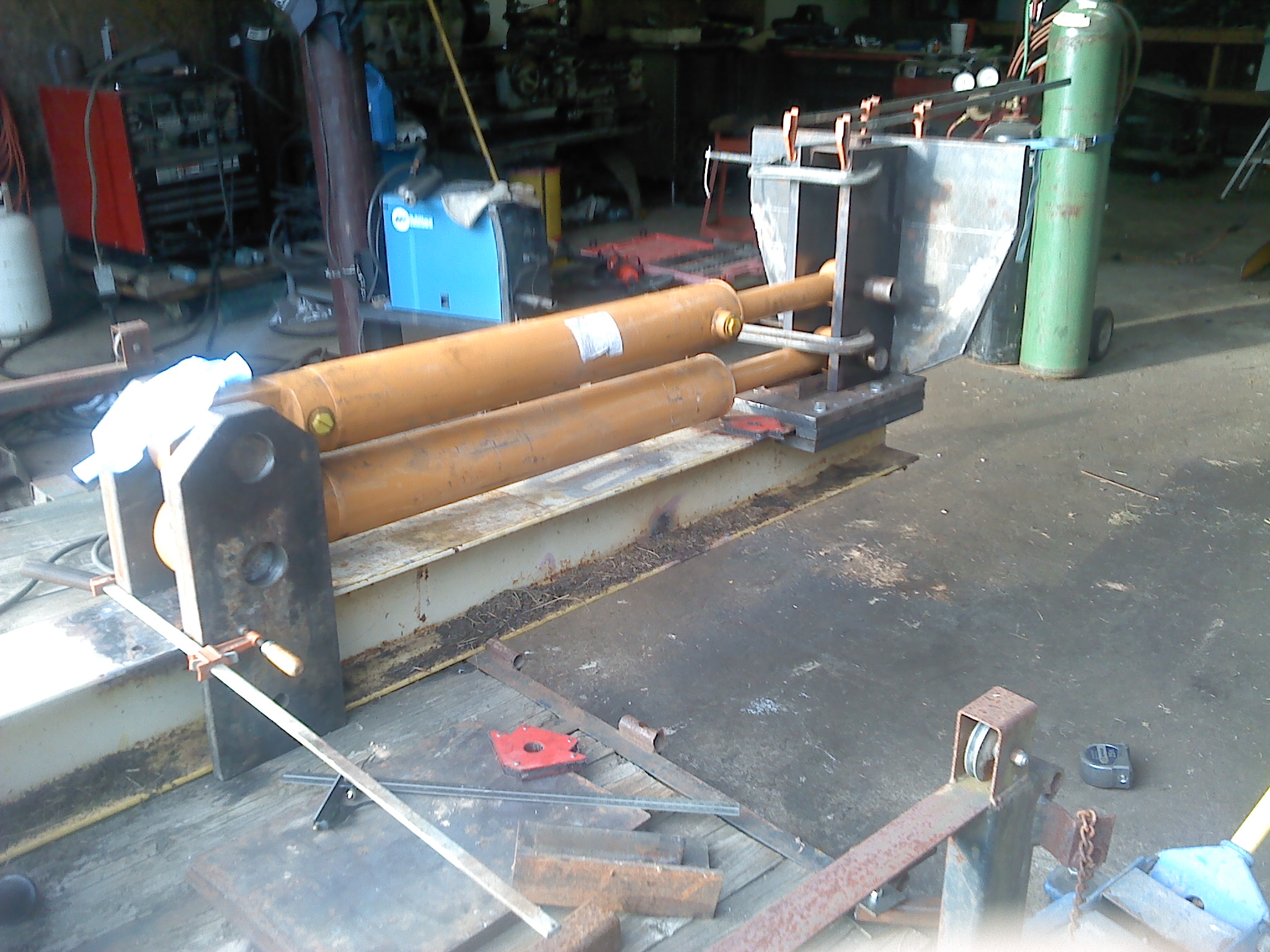

Ill throw up a pic of my cyl mounts. 0822151909.jpg. Of course my mounts are for 2 cyl instead of one, but my pusher block is the same 20in tall as yours. Past experiences on a few other splitter builds and I found pretty much the same thing you have with high cyl mounts. The higher you mount the cyl, the more the base mount is going to flex. While my top cyl is mounted at about the same height as your single cyl, I mounted the bottom cyl as close to the hbeam as possible. I also chose to use to side plates for the base instead of one center mount which will give a little more support when pushing. I havent boxed my beam yet, but your pic's of boxing the beam is pretty much exactly what I had planned. I also intend to plate the top of my beam. Plating the top of the beam will provide a lot of support when it comes to bending/flexing the hbeam under load. My thought for you are to lower your cyl mounts as low as possible. Make your slide/pusher plate as long as possible and then brace the pusher to keep it from bending backwards. My current splitter has a 5in bore cyl and is mounted with a single 1 in plate at the base like yours, and the sides of the web are plated with additional 3/4 plate, both sidesbut it only extends about 6 or 8 inches toward the front of the hbeam. I have never noticed my hbeam flexing at the base of the cyl. The wedge end of my beam is plated on both side with 3/4 plate and 6in channel on both side. securedownload.jpg, I have seen it flex and I actually think I bent the hbeam where the plateing ends. My wedge is 24in tall adjustable and a 6way. If your not able to lower the cyl mounts, you might consider just welding ome sqtube between the cyl and beam. You can sandwich the base mount between the tube to give it some extra support at the same time. probably the cheapest, easiest fix and will really give your hbeam a boost of strength
I think the URL is a little off, Your not a dumbass, dumbasses dont build what you have built.

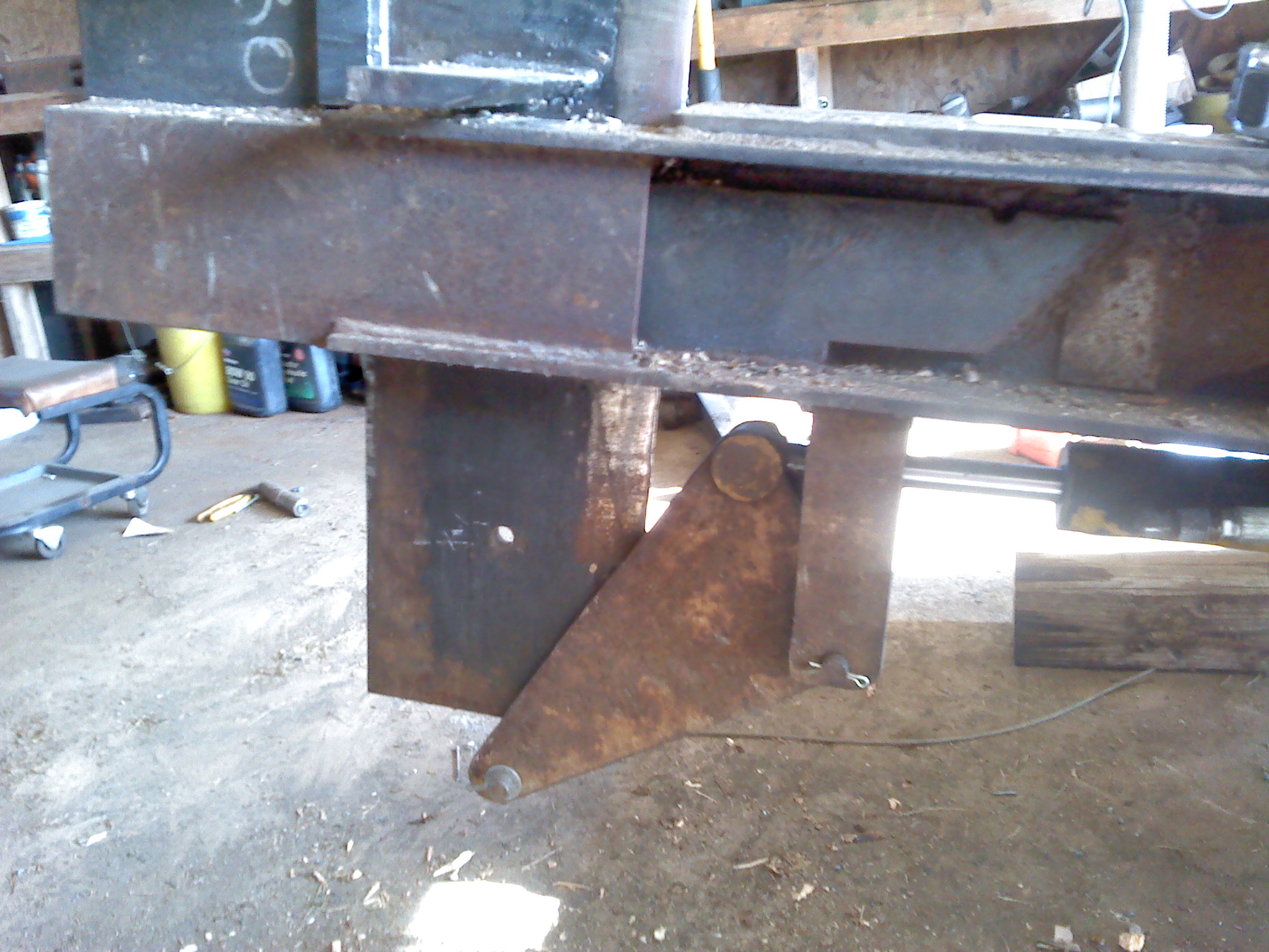

Update: We processed about 6 full cord this weekend and found some issues that need to be addressed.
Issue #1 Bending the pusher plate forward.
Since our load of logs had so many that were small in diameter it showed us just how easy the pusher could break its welds. They cracked right down the middle. The cylinder being mounted 8-1/2" above the beam and us not having larger gussets in there caused this issue.
We then put a log cross ways at the top of the wedge and tried to push it as far back into position as we could. We re-welded the vertical members and are planning on adding gussets. Unfortunately in this picture you also see the results of our second issue. The pusher lifting off of the beam.
This pic shows the gussets we plan on adding to the back of the pusher as well as a piece of C-channel we want to add to support the cylinder mount some more.

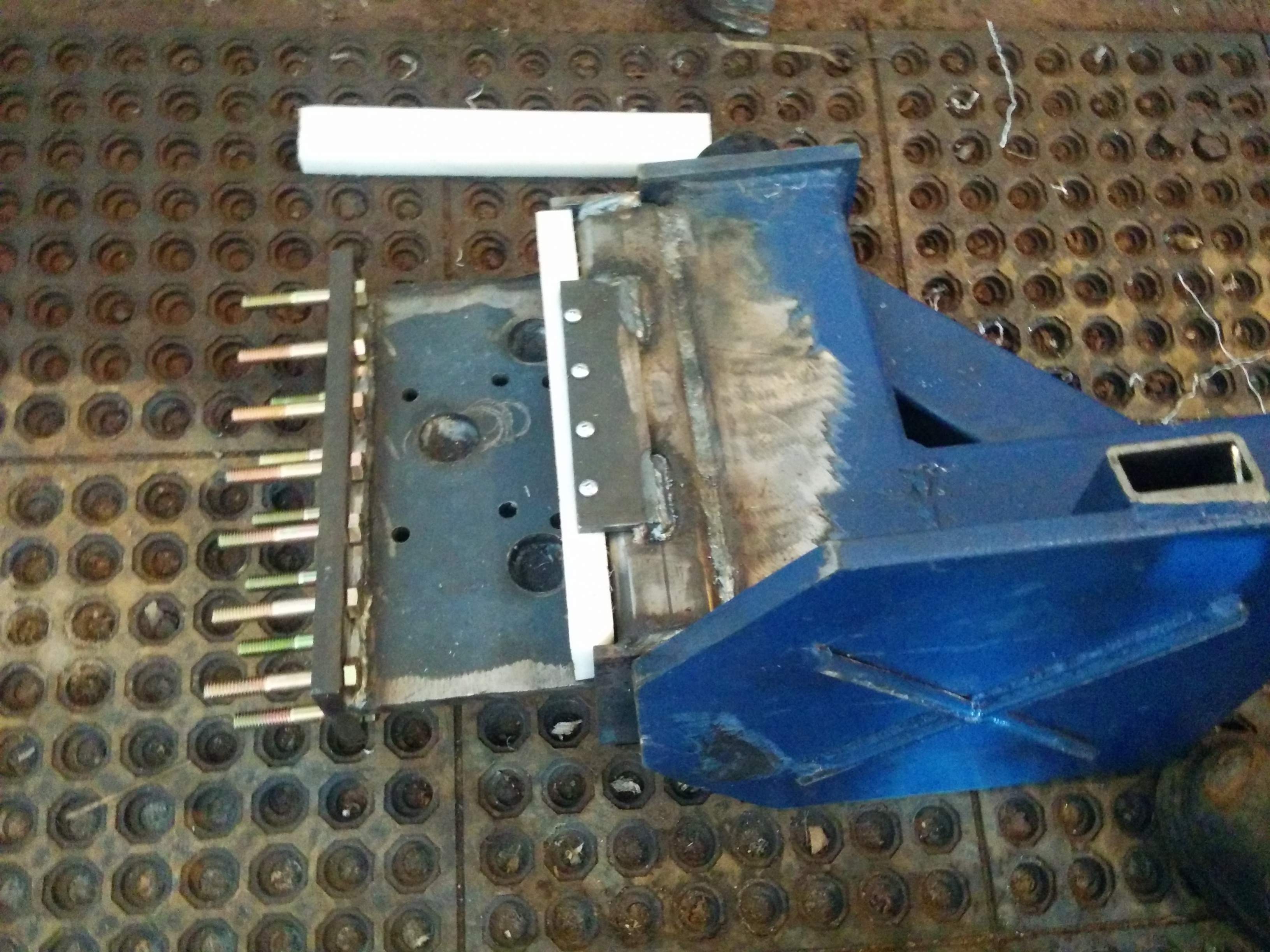

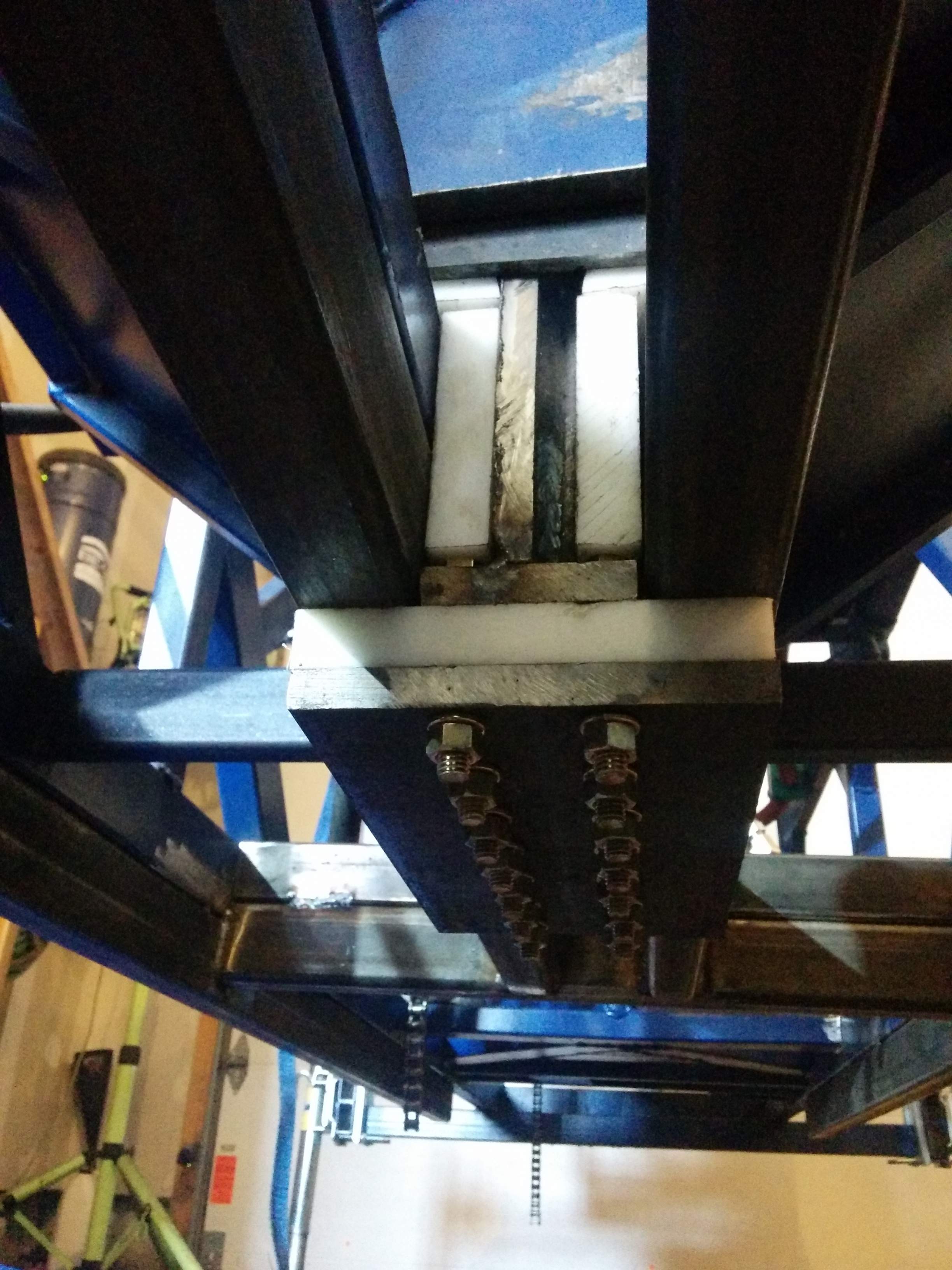

Issue #2 Lifting of the pusher plate.
Here you see how the plate lifted.
The spacers in between the pusher sled and the lower plates was left a little too thick. We have since machined them down and hope that if things are tighter they wont start to bend quite so quickly. Again, we feel that this is mostly due to having the cylinder mounted higher.
So to fix a lot of this we will need to drop that cylinder. But right now the top of the pusher plate leans forward towards the wedge. A bit over 1/2" difference over 20 or so inches. With this lean now welded into place we have an issue. If we drop the cylinder now, whenever we run larger diameter logs we will be pushing the pusher plate up at the front similar to what is shown in the 2nd picture . So for now we are just going to add the gussets and try to get this years wood done. Over the winter we plan on squaring up the pusher to the pusher sled (likely building a new one) and dropping the cylinder by 3 inches. We are thinking that we would not make the pusher plate nearly as high so we keep the forces lower. We will run the splitter roof supportsfrom behind the pusher plate.

Well, first, congratulations on processing 6 full cord, that's a big accomplishment.
If you're going to reconfigure your cylinder mount, don't just drop it 3 inches, drop it all the way to the bottom and brace the top of the pusher plate. Here's a picture of my pusher plate that's lying on it's side. The cylinder is as low as possible with bracing to support the top of the plate. I've had no issues.
I don't think machining the spacers is going to be enough. "Where's the beef man!!!" The steel guides need to me much stronger and it looks like you need several more bolts and you should make them grade 8. As you know, my machine works a little differently but the guide is made of 1/2" steel and is continuous from one side to the other. A picture from the bottom should show what I mean. If possible, I'd use the underside of the beam, otherwise, I'd beef that up significantly. I think if the guide had been strong enough to resit the upward force, you may have bent the top of the I beam, it may be a good thing if failed where it did.

Thanks for your info Ken, I've been wondering how things have been going for you. These things do take a bit to get the bugs worked out. One of our guys suggested that when we get everything worked out we sell it and use everything we've learned to make our 2nd one even better. :eek: I don't know if I could take that...
I was planning on adding that upside-down piece of C-channel on top of the beam to strengthen it a bit more. My Troy-Built 33 ton unit has that setup. Dropping the cylinder 3" would put it 1/2" above that channel.
We made those bolts and bottom plates weak on purpose to do just what they did. Obviously the last thing we want to do is bend the beam. We are in the process of making a bunch extra bottom plates. For the time being they will be a wear item that is checked daily That is until we drop the cylinder and get the pusher angle fixed or end up replacing it.
If that does not fix things then we will need to regroup. Maybe making something that wraps under the entire beam will be the solution. I never thought of that. I think we'd need to move one of the beam supports but that is not the end of the world. Is that nylon that you are using to reduce friction? How is that holding up?

Not sure I fully understand, but if it's currently 8.5" above the beam and you drop it 3", my quick calculations tell me it's going to be about 5.5" above the current beam, and that's too high. If you're raising the beam 5" with the new C-channel, you're going to have all sorts of issues with the cutting head, which can't be raised accordingly. It should make no difference to the overall strength if you add that C-channel to the top or bottom of the beam. Adding to the bottom means you don't have issues with the height of the cutting head but means you need to lower the cylinder more than 3". I really don't think you need to strengthen the beam, just lower the cylinder.
If using the bottom of the beam is an option (you can move the beam support), I highly recommend going that route.
I'm not sure if it's nylon or some other plastic. My neighbour used to run a plastic manufacturing company and sold me a large chunk that I cut into a blade for the bottom of my snowblower. The blower is about 1500# and it's used on a paved driveway. I've used it 3 seasons without any noticeable wear. I've only processed 6-8 face cord with my processor, but there is no noticeable wear there either. I don't think it's 100% required, but I had the material and I think, if anything, it will help. I had to cut some of that material away so that it didn't act as a brake against the bottom of my beam and I cut a little too much so I do get a little upward movement on my pusher plate, but everything has held up well so far.
We have 1 major issue with moving the ram super low. Our ram presses directly on the back of the pusher plate. So that means when the cylinder is fully retracted any meaningful gussets will hit the cylinder. We don't have the length on our H-beam to set the cylinder back further and run gussets forward from the point the cylinder meets the pusher. I really like that aspect of your pusher. A good design consideration for future builders!!!
Sorry to hear that your attempt of an easy split extraction turned into a repair Ken. We put chain grab hooks on the back of the pusher for extractions but we've not yet made a J-hook that will attach to them. We're just using steel bars and sledge hammers if the need arises. Not fun,or even remotely enjoyable...
Here's what comes to mind, it would solve 2 of your problems, possibly 3. Does the diameter of the splitter cylinder fit in the width of the I beam, it looks like it does in your pictures. If so, I would weld 1/2 plates under the base of your pusher plate to box the I beam in. This will allow you to use the bottom of the beam as a guide and prevent the issue you're having with the pusher plate rising. I would make those side pieces much longer than the base of the pusher plate so that I could run a brace from the pusher plate to the side pieces. When fully retracted, the cylinder will fit between those two braces. If you make all this out of 1/2" plate, it will be plenty strong enough to resit all the forces you're putting on it. I'd also guess it would move the forces enough and be strong enough that you wouldn't need to lower the cylinder.
haha, I obviously didn't look at you're sketch up drawing! I understand the C channel now, I though you were putting it the full length of the I beam, which would obviously be an issue!

We beefed up the bottom plates under the pusher plate to 3/8" steel. They bent slightly right after the install but have remained on there for at least 18 full cord. The old ones made of 1/4" steel would have to be replaced pretty much daily. We are pretty darned happy with that!
Note: We have NOT moved the splitter ram down as we were talking before.
