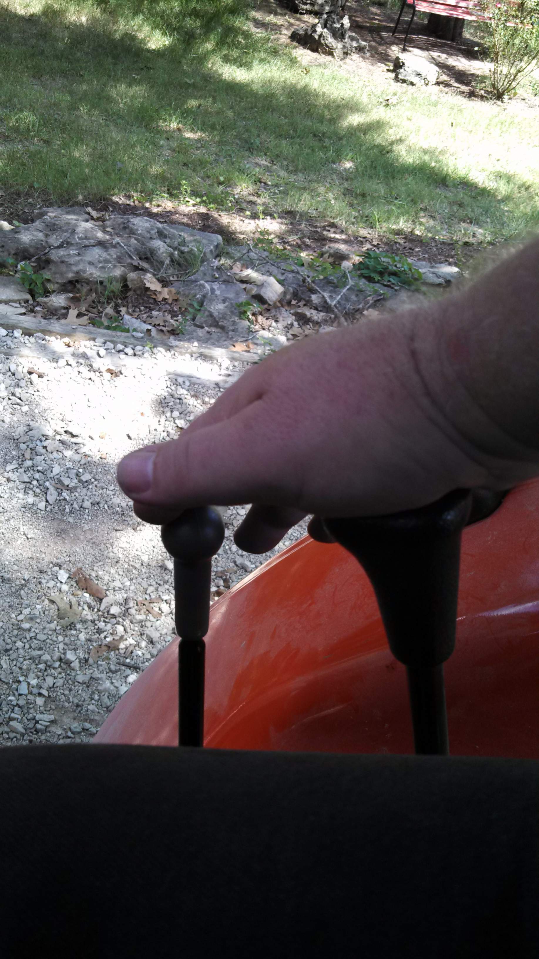

I used the rear remote, BUT mine was very conviently place next to the joystick control and is very easy to operate, but it does not sound like yours is. So I am thinking you will need a diverter valve or a 3rd function. I would use the diverter valve. Brian at fitrite hydraulics can fix you up on that, or you can shop it out yourself.

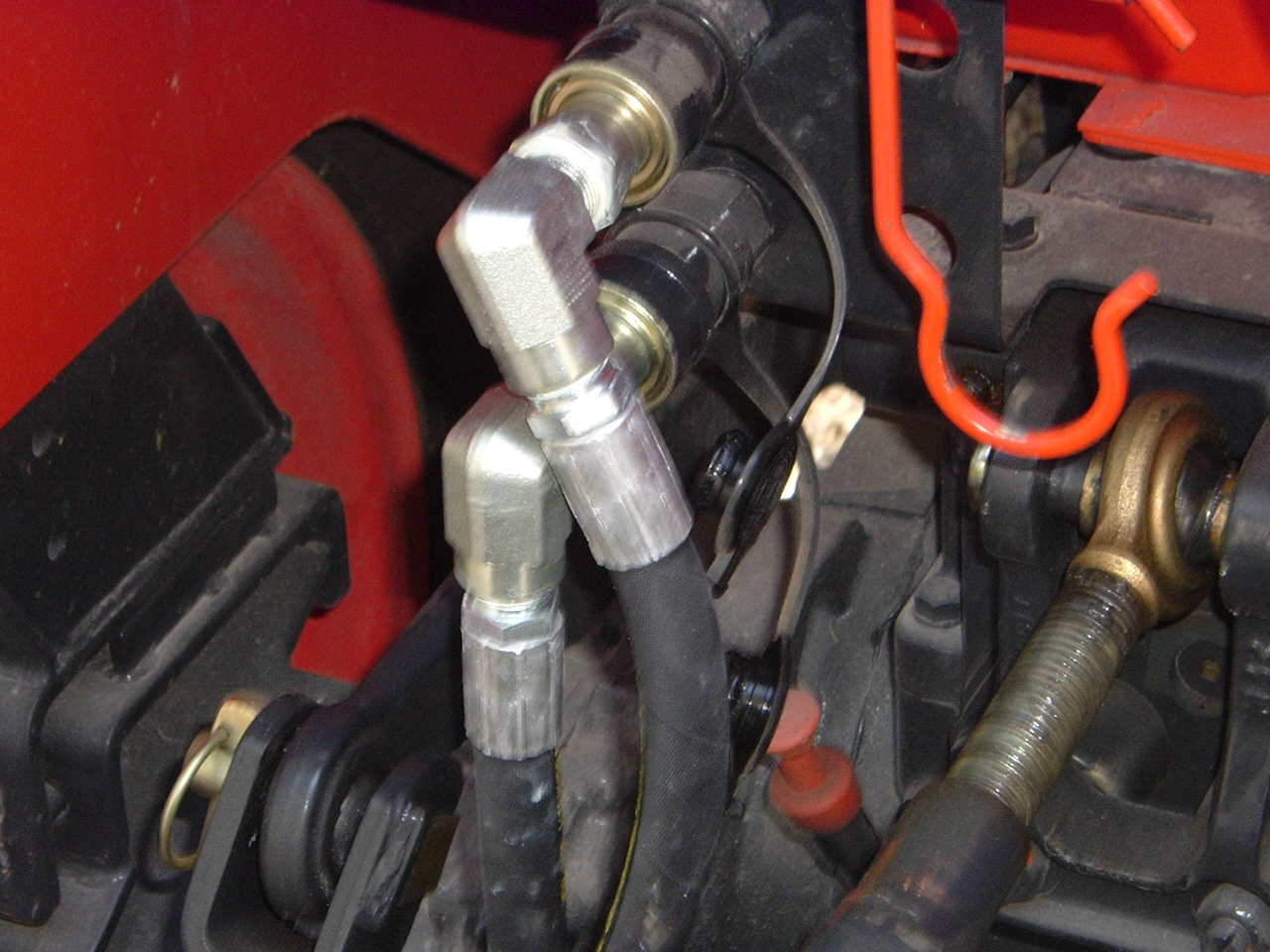

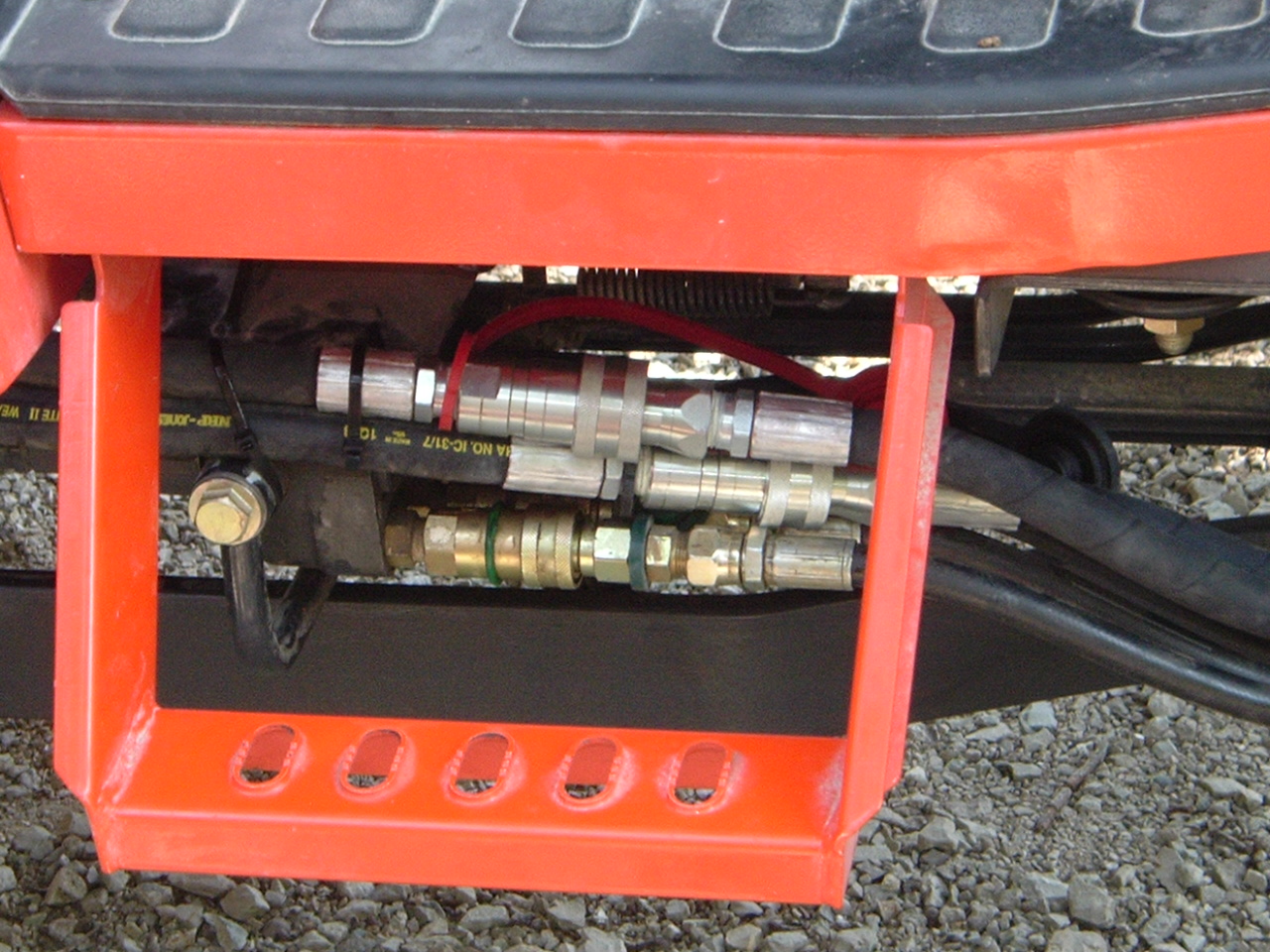

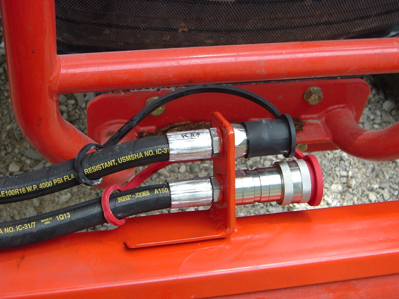

George, I think Everything Attachments will make you a pin-on style grapple, or at least sell you a plain back one with no mounts that you could take to a local welding shop to have the proper mounts added-that should be cheaper than converting to SSQA. You can also just run long 1/4" hoses from your rear remote to operate it, anything larger is a waste of money and real estate IMHO.

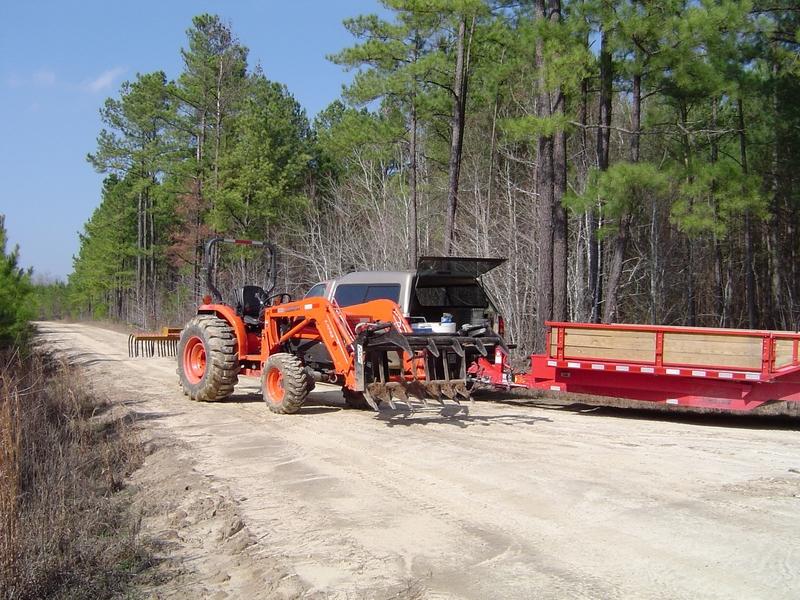

By the way...I have a WR Long grapple, valve and setup. My grapple is 5 feet wide. It is the width of the front tires. That way you can clear stuff and not be running all over it with the front tires.
