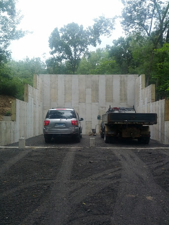

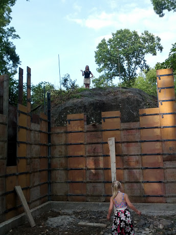

This is going to be a long project, I'm doing most the work myself as time and money allow. The Barn is going to be 28' wide and 32' deep. It's being set into the hillside so that the second floor will be walkout also. I'm designing and changing it as I go, after I dug the hill out and hammered the ledge I discovered the foundation needed to be 17' high at the rear. I wanted high ceilings in the shop but hadn't planned for that high. I called my old engineer professor and he came up with a simple plan of pouring counterforts on the back side to counter act the pressure of the soil pushing on a wall that high. It痴 been about a year and I got the trees cleared, driveway cut in, and foundation poured
barn footings.jpg barn forklift.jpg barn pouring footings.jpg barn poured footings.jpg barn wall forms.jpg barn high wall.jpg barn pouring.jpg barn inside.jpg barn counterfort.jpg

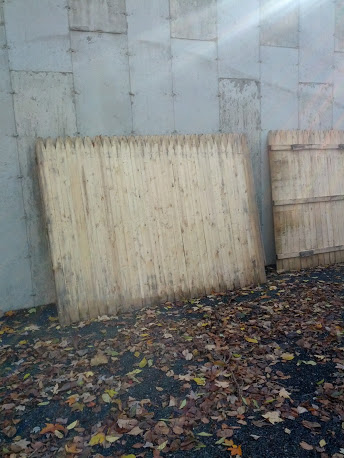

Funny you say that. I went to Home Depot the other day and saw a stack of slightly damaged stockade fencing for $ 9 a section and picked up 8 sections. If the complaints continue after I get the fencing up my wife wants to let my 3 and 5 year olds paint his side.
