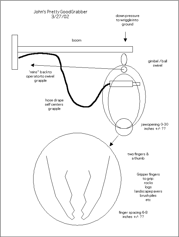

bubenberg: <font color=red>let those suggestions come PLEASE!</font color=red>
FWIW, here's one of my first PT grapple ideas. In looking around my implement dealers yard I had my eye on some chisel plow shanks for fingers. Another idea replaces the fingers with sections of landscape rake. And then there are those cultivator tines I picked up for a bucket grapple. So many ideas so little time! My darned thinker has gotten way out in front of my doer again.
Won't the mini hoe with two teeth & a thumb handle most of what we're all trying to grapple with?

Seedgewood: <font color=red>Won't the mini hoe with two teeth & a thumb handle most of what we're all trying to grapple with?</font color=red>
For the time being yes but as discussed before several of us are looking for more height, more weight and more length of the boom. i hope this boom will accommodate the ditch mower, tree sheer, platform to trim branches and high bushes. if you look at the one picture under:
http://www.valbysales.com/newpage59.htm
you will see a stand which i will attach wheels for the ditch mower attachment (attached to the three point hitch of the tractor) so the power trac only has to provide the transportation, power and control source ... you got the idea on your technical drawing , if you can swivel that thing, we are in business as far as dexterity goes, the clamshell ability is also addressed. my proposal is a minor addition to satisfy my desire of additional length, height and weight.
sometimes you have to segregate the content of the load, so you don't have to segregate it at the dump site as much. for example: your lunch wrappers, starboecks coffee cubs, coca cola cans from your crew, the leaves and the brush, the concrete and the wood leftover from the deck you installed don't normally go on the same pile at home or at the transfer station. to segregate that and load it on a larger truck or dump trailer our suggestion will come in handy ... i think
