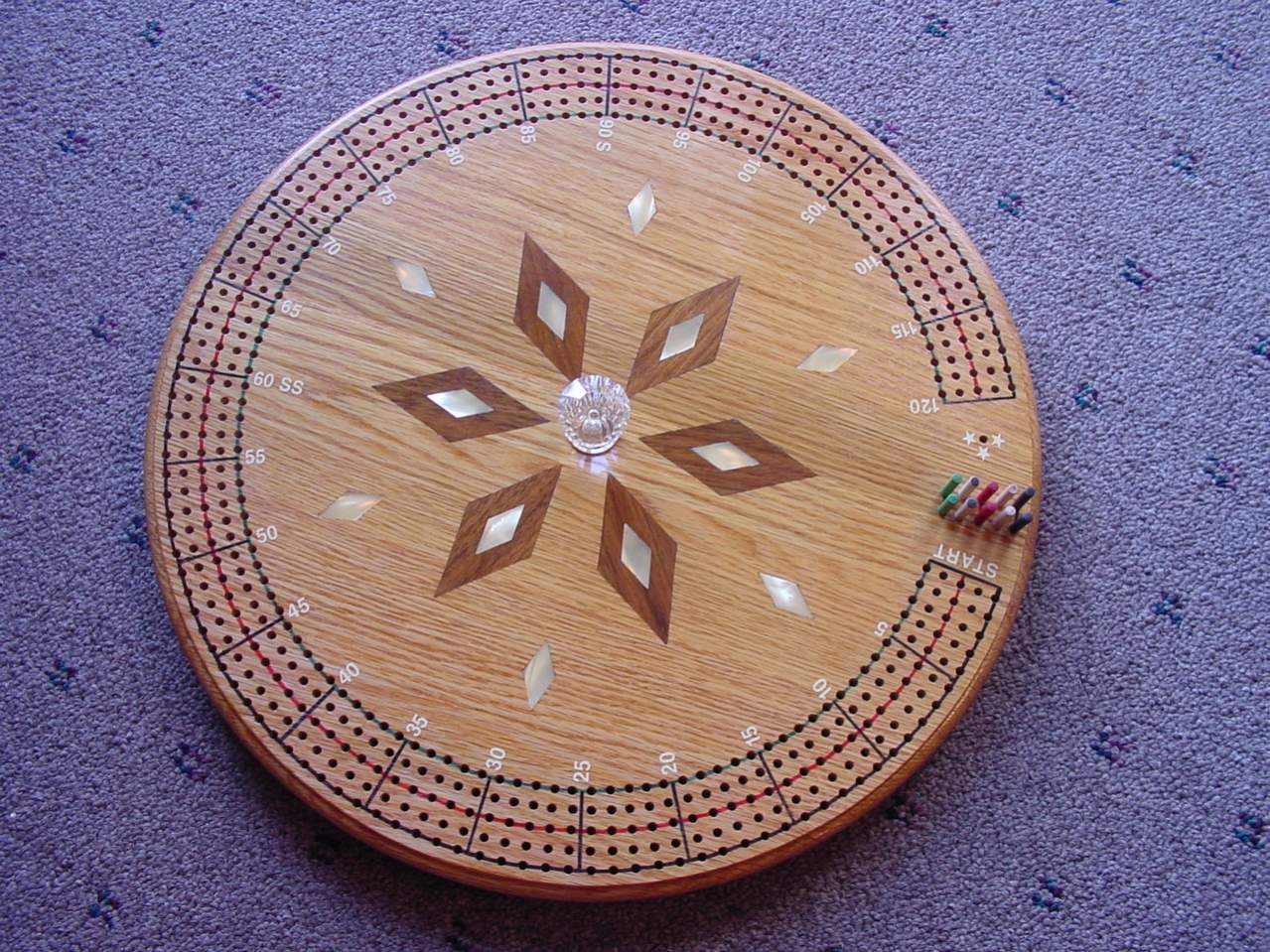

Brand New. I make custom cribbage boards and some of them were made like a lazy susan so a lot of people could mark their own score just by rotating the board.
To drill the holes in the board (some boards had over 600 holes to drill) I would mount a pivot point on my drill table and drill a small hole under and in the center of the circular cribbage board. Then I would just rotate the board to the points marked on the board, drill and repeat 600 times. Attached is a picture of one of my oak 18" diameter lazy susan boards with black walnut and mother of pearl inlay.
Bob, I hope you don't think I'm stealing your thread, I just want to demonstrate the advantage of using a radial drill press.
Rick

That's OK. I was just demonstrating what could be done for those of us "PO FOLK" who aren't "rolling in the dough"! :) Just think of how many baubles & beads your wife had to go without, just so you could have such a nifty machine like that ! :) B.t.w., that is some beautiful work you've done there ! What tools are needed to do inlay work like that ? Now, being able to make stuff like that takes true talent! I consider myself just a "so-so" welder. You have talant ! Did you buy the drill press here in the states? Or are you another Canuck? Your bio is a little vague. :confused:

Thanks for the compliments. I live in Connecticut and bought the drill press right in a local Sears store.
For the inlay, I use a router with an inlay attachment with a 1/8" bit and a sharp chisel to clean up the corners.
I use a computer to draw my designs and a plotter to draw my patterns. I then spray-glue the pattern to my wood stock to show me where to drill or rout.
