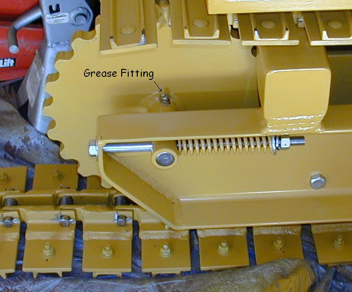

I would add zerks to those free wheeling sprockets.Make'em last as long as possible.
Done! See photo. :)
Adding the jack shaft with the pulley arrangement as you have shown will definitely slow down the dozer. Be sure to add a provision for belt tension either by hinging the jack shaft mount or allowing the mount to move up and down. Or is the rear idler used for tension?
Yes, the rear idler is spring loaded but I would need an idler on the front belt. :)

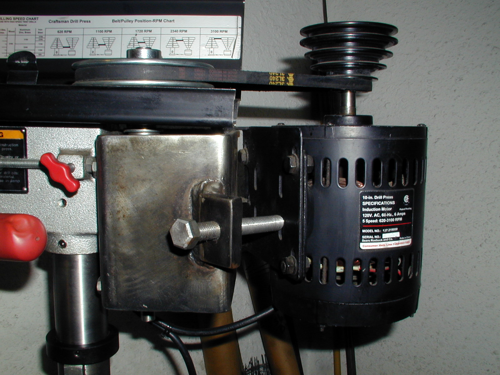

Rawinok,
When you get some down time away from your excellent fabrication, will you post some more details of how you slowed down your drill press. Every since
I saw that it's been eating at me to do the same thing to mine.
I'm adding my"aye" to that proposal!:thumbsup::cool:
+1 on that one from me.
...Oh ya the drill press thing too.
Chris
... Count me in for the drill press also.
Well, I've got some down time now so I thought I'd give you the run down on the modification that slowed my inexpensive Sears drill press from 620 RPM to about 205 RPM. The first thing I did was purchace a 1.5" diameter pulley (1/2" bore) from DrillSpot.com | Online Hardware Store for $3.82. Next I purchased a 4.5" dia. pulley (1/2" bore) from www.pheonix-mfg.com for $15.30 (about twice of what I should of paid for it!). Then, from www.McMaster-Carr.com I purchased a 1/2" dia. x 9" long keyed shaft for $16.90, two 1/2" dia. pillow block bearings for $21.90 and two 1/2" shaft collars for $1.50. This made the total $59.42 (plus the cost of one additional belt).
The Surplus Center did not have any of those parts at the time but it would probably be worth checking with them first for maybe a better price. I then scrounged around in the scrap pile and found a piece of 4" square tubing (3/16" wall x 5" long). On the side of the tube I welded two pieces of 1 x 1/4" flat bar drilled and properly spaced for both mounting the tube to the drill press as well as mounting the motor to the tube(refer to photos). I drilled the tube so that the two pillow block bearings could be mounted to the inside.
I welded a 1/2" thick tab which was drilled and threaded for a 1/2" bolt on the outside of the tube for the motor belt tensioner. I cut the sheet metal shroud away so that there wouldn't be any interference with the added pulleys. Note: Making this modification throws the center of gravity back enough to make the drill press want to tip backwards. It will either need to be bolted to the bench (if it is a bench model) or mounted to a heavy plate which extends out towards the back at least 6". I then assemble it and purchased an additional belt and presto! Before I knew it I was knee deep in shavings !
