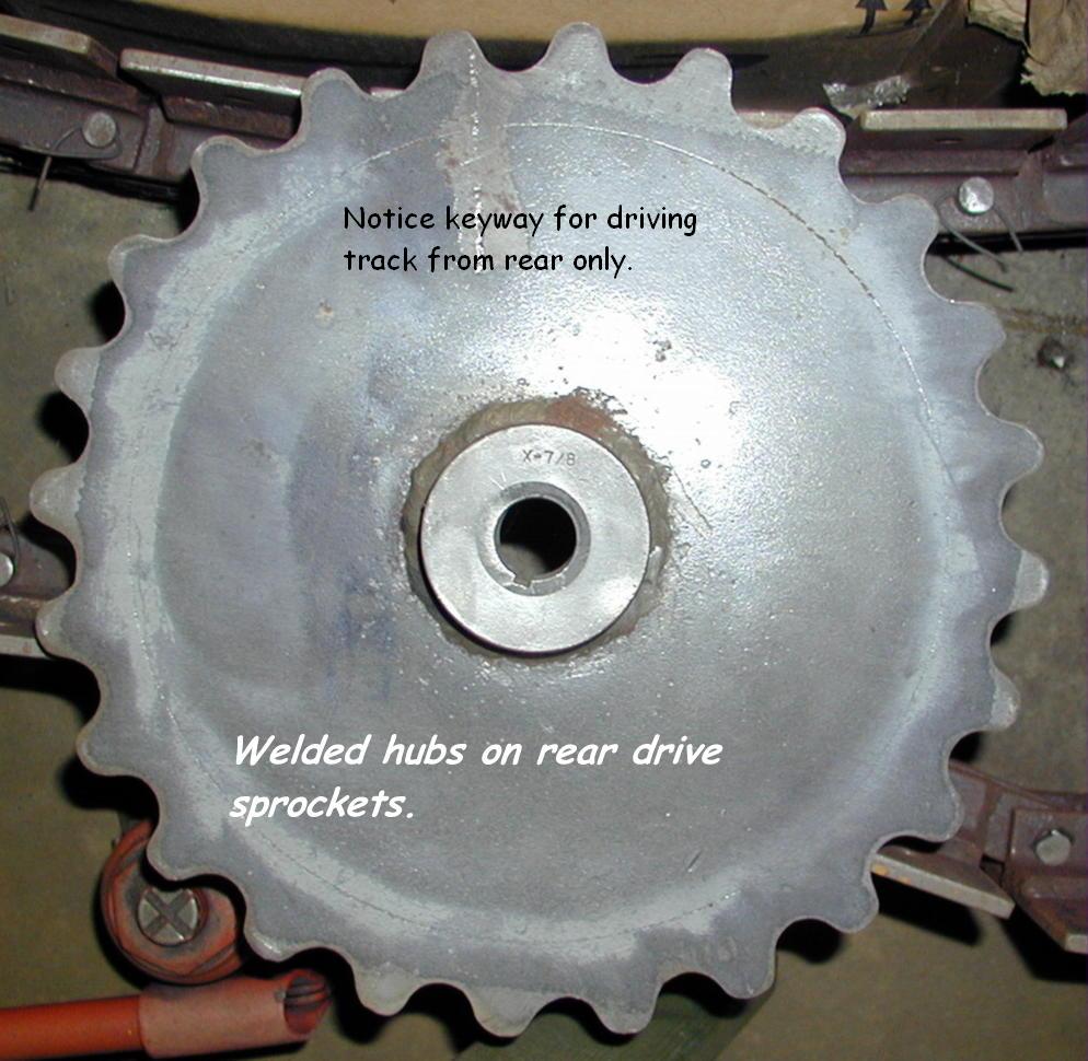

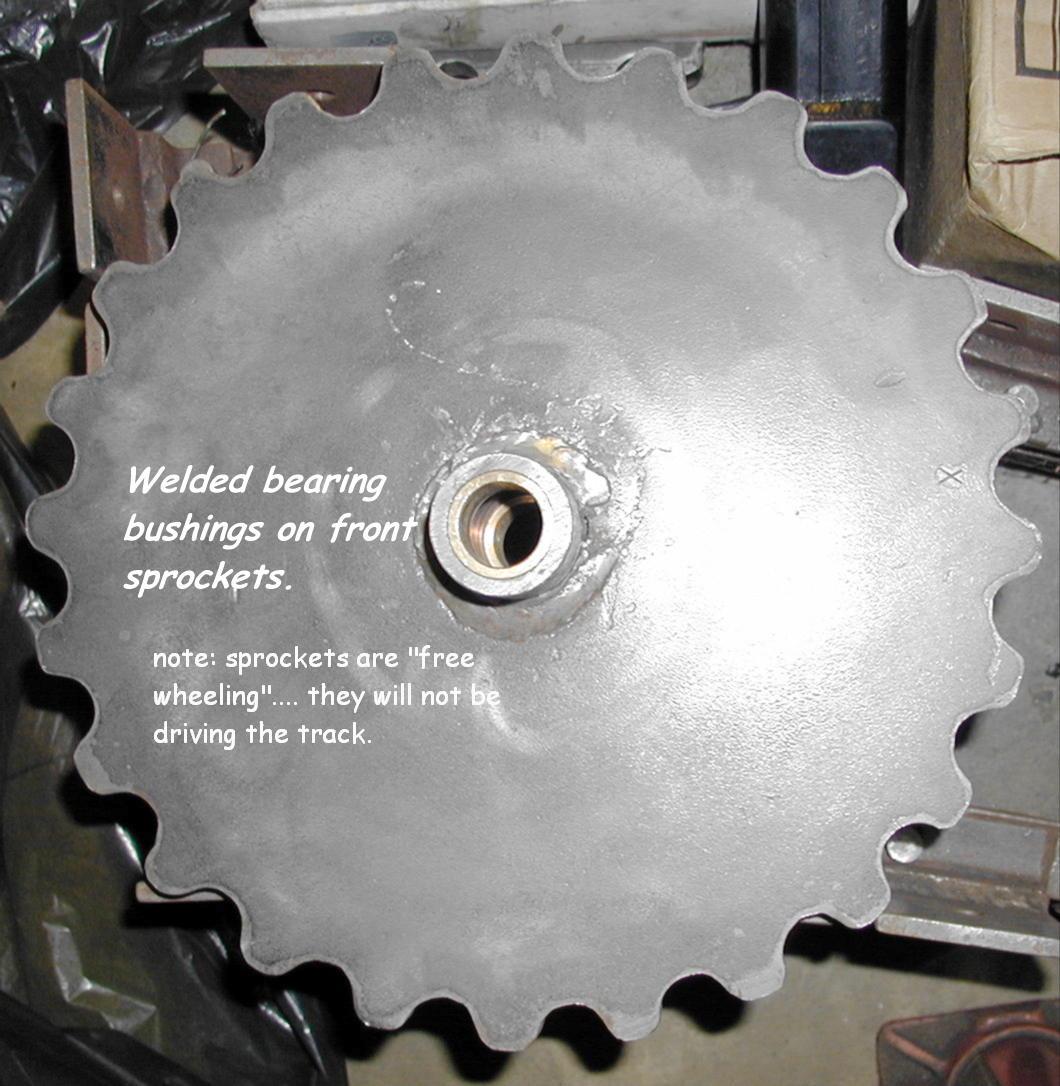

Speaking of drive wheels, I noticed you put drive sprockets on the front rear of your dozer. On dozers, usually the rears have the drive sprockets and the fronts have what look like idlers that run on top of the inside track. I believe it is done that way to reduce wear on the pins. Just curious why you did it that way even though it does look like you have four wheel drive. LOL
I am not sure what you are talking about here. Do you, by any chance, have a photo of an example of this? I have attached a photo of the keyed rear drive sprocket as well as the free-wheeling front sprocket fitted with sleeve bearings. Hope this clears things up for you.
