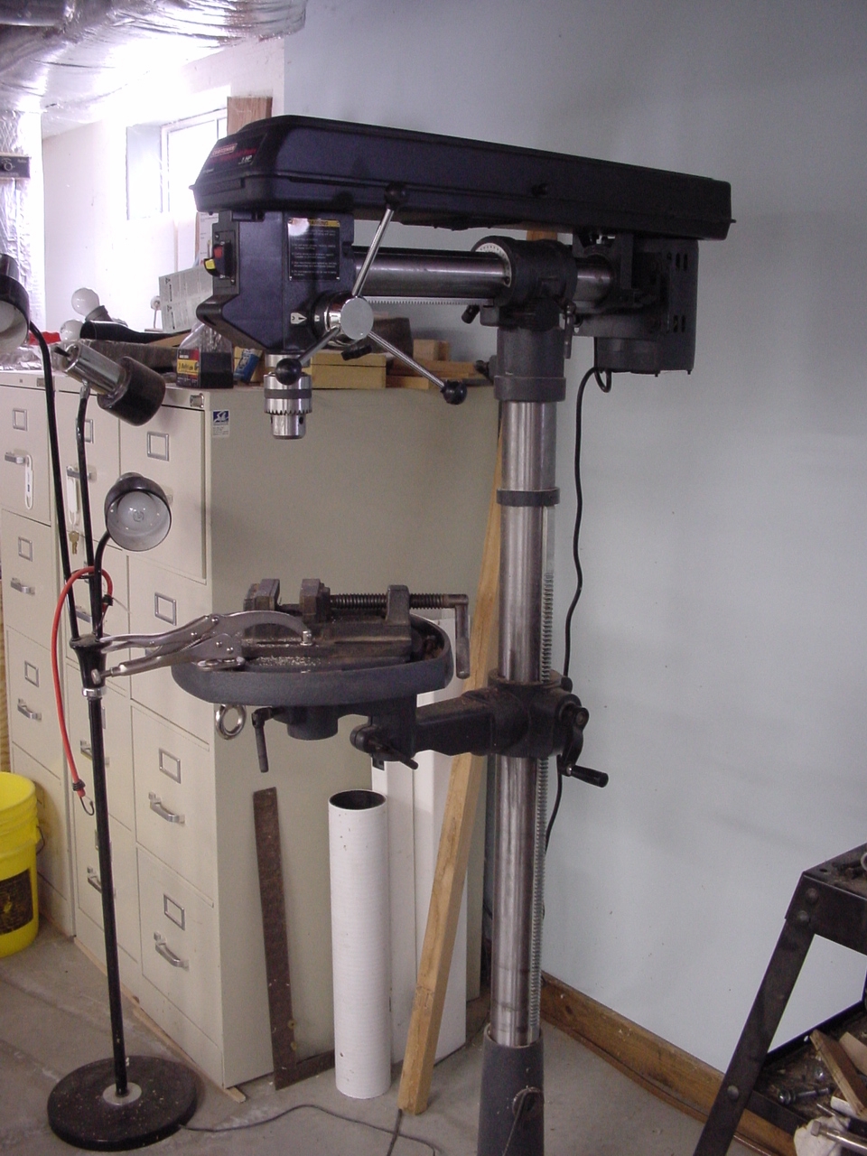

Here is a picture of a 12spd Craftsman drill press I bought about 10 years ago and you could get speeds from 250 to 3100 rpm right out the box. It was probably in the $450. range back then. You can also drill to the center of a 34" diameter project.
Rick
