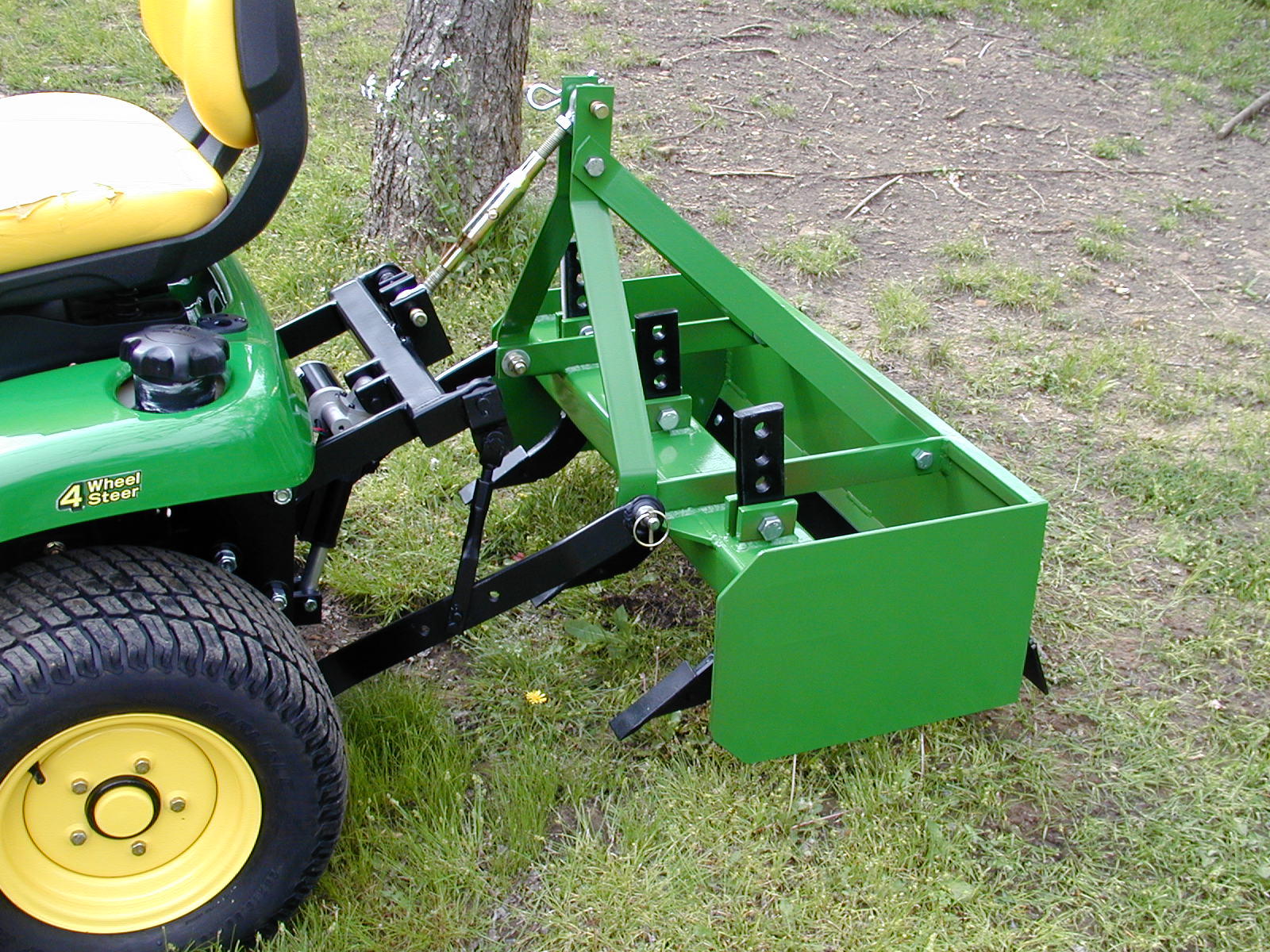

It's shaping up real nice.Will you be running dual batteries or deep cycle batteries to power the actuators ?
rawinok2:
One standard lawn mower battery will do just fine. The same one that starts the engine & powers the lights. The actuators look like they have 18 gauge wires on them so amp draw must be minimal. I purchased them from Northern Equipment but I don't recommend them to anyone.They are too slow and barely have enough power to raise and lower the box blade that I made (see photo).

ben2go:
rawinok2:
Great job on the box blade, you have real talent.
Yeah. That's about par for the course with linear actuators. But, if you have them, use them. They beat moving stuff by hand.

ben2go:
rawinok2:
I too have found them gutless. Problematic as well.
