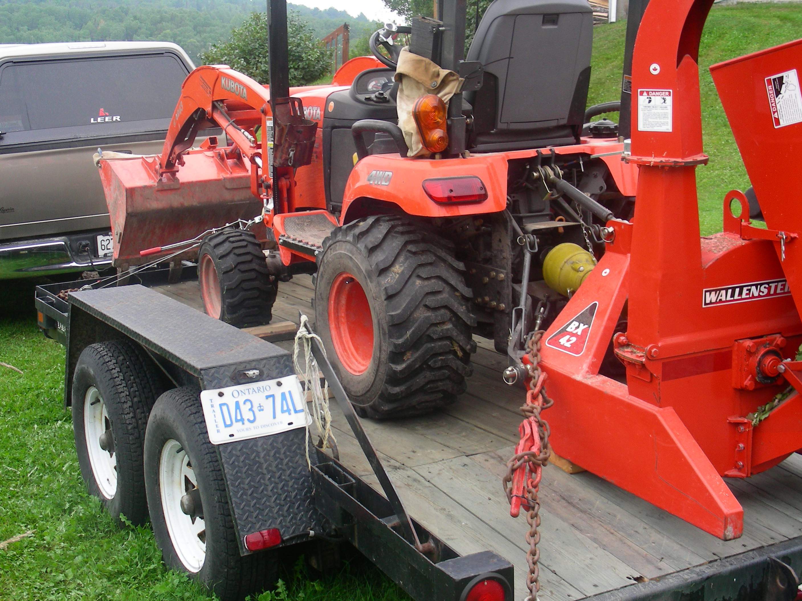

Here is mine being loaded to bring to my daughters property to help her get rid of brush.
I am impressed the unit , simple but rugged.

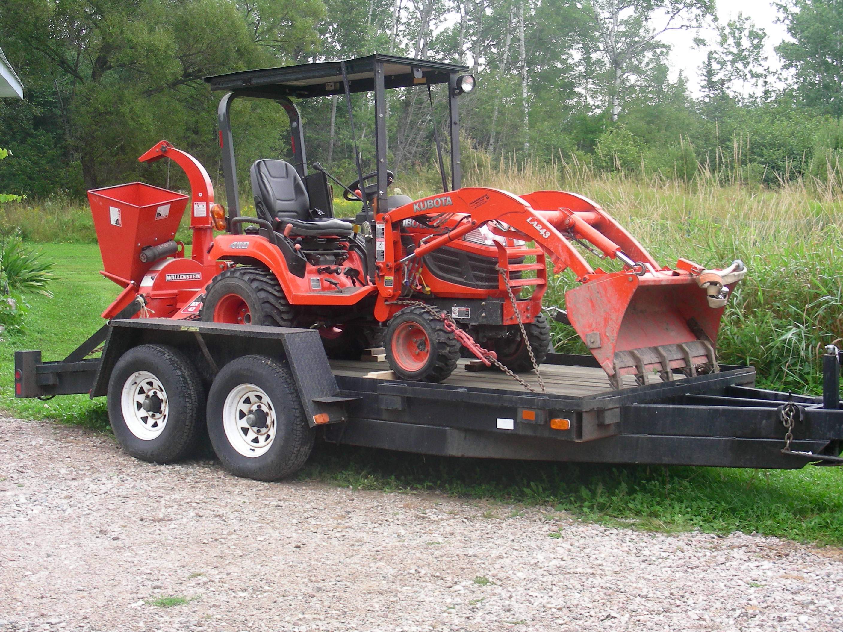

Well I bought a BX42 and I love it. I've used it for about 8 hours so far and it has exceeded my expectations. Now thinking about adding the power feed but I probably won't. I'm in no hurry and I enjoy it. Thanks for the help!!
Larry

Very nice congrats! I have to say I'm jealous of your nice matching orange color. I got my bx42 used, so had to take what was available and it turned out to be JD green, which doesn't match my kubota orange very well!
