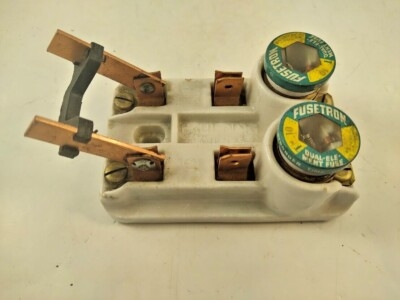

Picture below is identical to the service main I removed when I did a 100 amp 240 volt service upgrade
What I found interesting is one fuse for hot and one fuse for neutral… circa 1920.
Not recommended to attempt in the dark and always with a steady hand… other wise it tickles… as an old sparky said to me.
Pole to house, knob and tube to disconnect, disconnect to utility meter, utility meter to 2 circuit panel… 15 amp lights and 20 plugs.

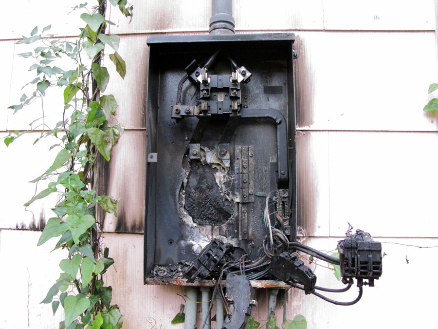

Used Zinsco panel for sale - replace that unsafe Federal panel. Needs cleanup.
Was this a meter socket or an actual panel?
My wife was watching one of those "flipper" tv shows a while back that was set in Florida and it didn't seem all that uncommon for the breaker panel to be outside. WTF?? Is that a thing there? Why would you want the breaker box outside?

As a new residential electrician in 1982, I built a lot of weather proof services. Builder house plans were not reversed to put garage on service pole side of the lot. WP service was cheaper than extending service into the garage. Owners did not want the breaker panel in a bedroom or living room.

Very common in California and especially for Service Upgrades
The combo meter base with service disconnect and 20 to 40 circuit breakers all in the same box.

The rental neighborhood i lived in for a couple years had the breaker panels outside next to the meter.
These were brand new homes 4 years ago.
