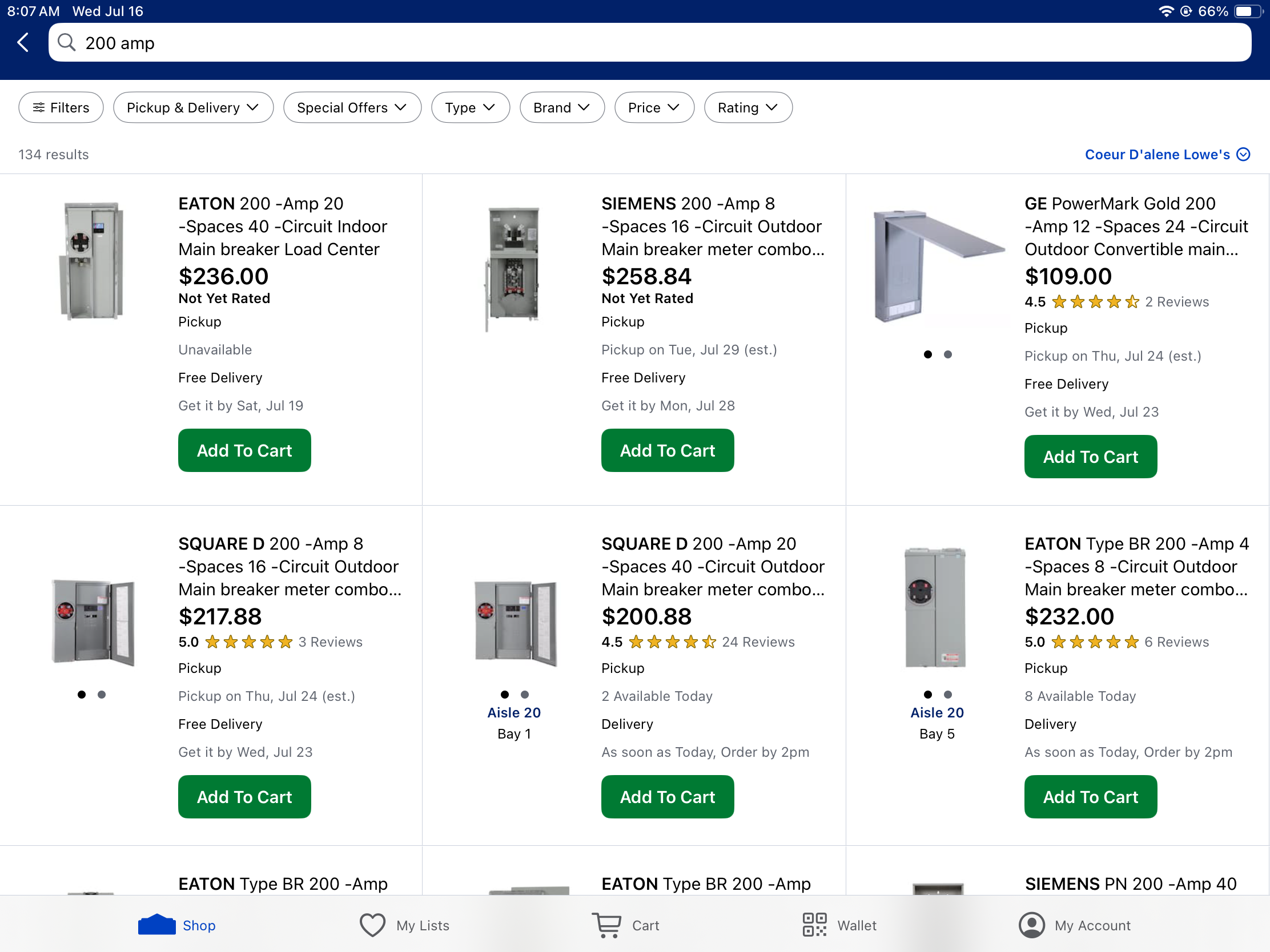

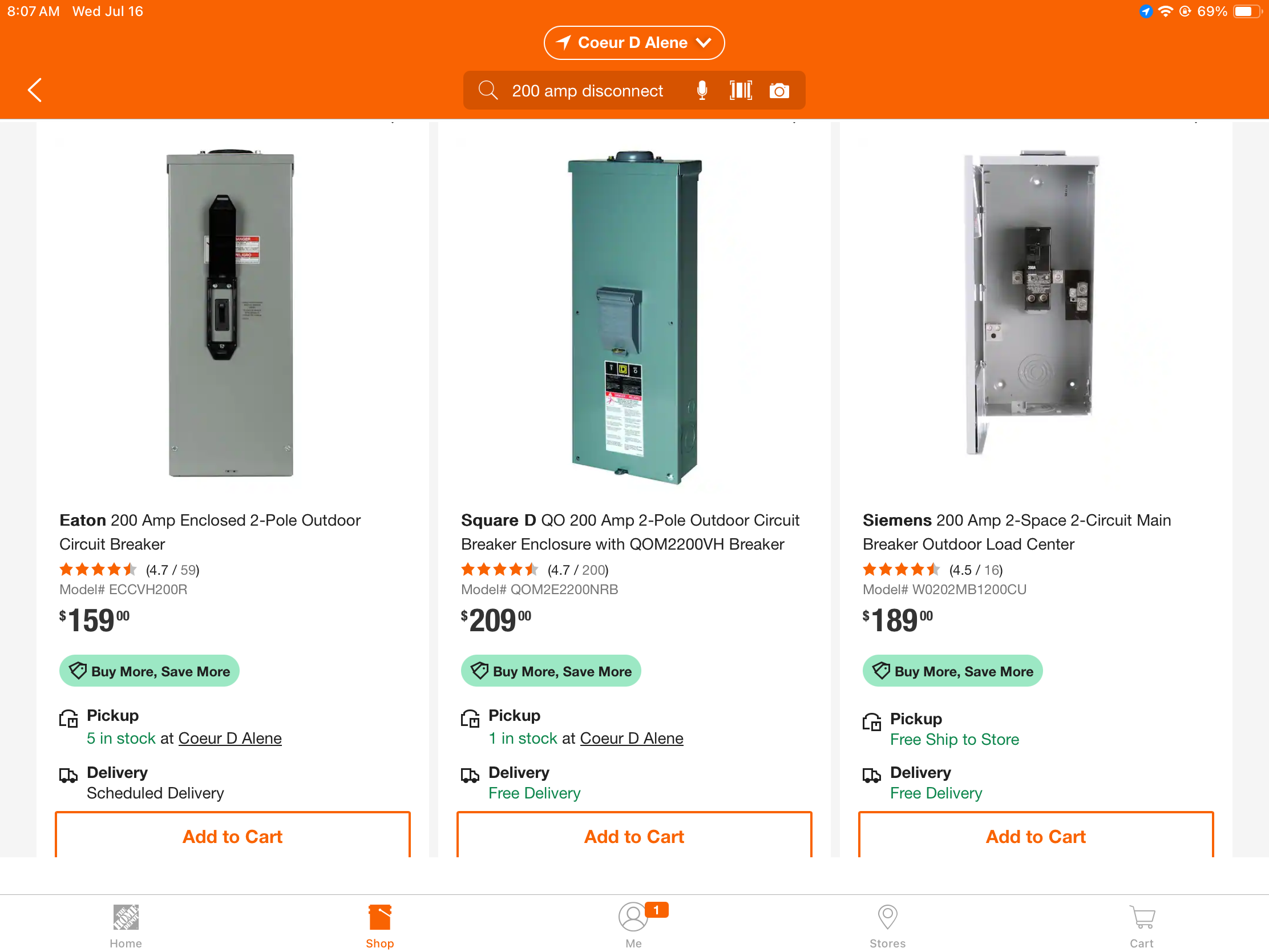

Actually, they make a relatively cheep 200 amp outdoor disconnect. Last one i purchased was about $150. There 3R weatherproof enclosed. Meet current exterior disconnect codes.
Also have small 200 amp beaker meter socket and with 8 spaces for around $250.

I wish I had that pricing here. Retail vs wholesale pricing? Or California vs Idaho pricing?🤣
Regardless, I think that putting the main service panel outside saves relatively few dollars, if any, upfront, and brings issues later, at least in my experience in the form of more corrosion, I admit that corrosion depends a bit on local climate, but if I see it here in California, I suspect that the issue is pretty widespread.
