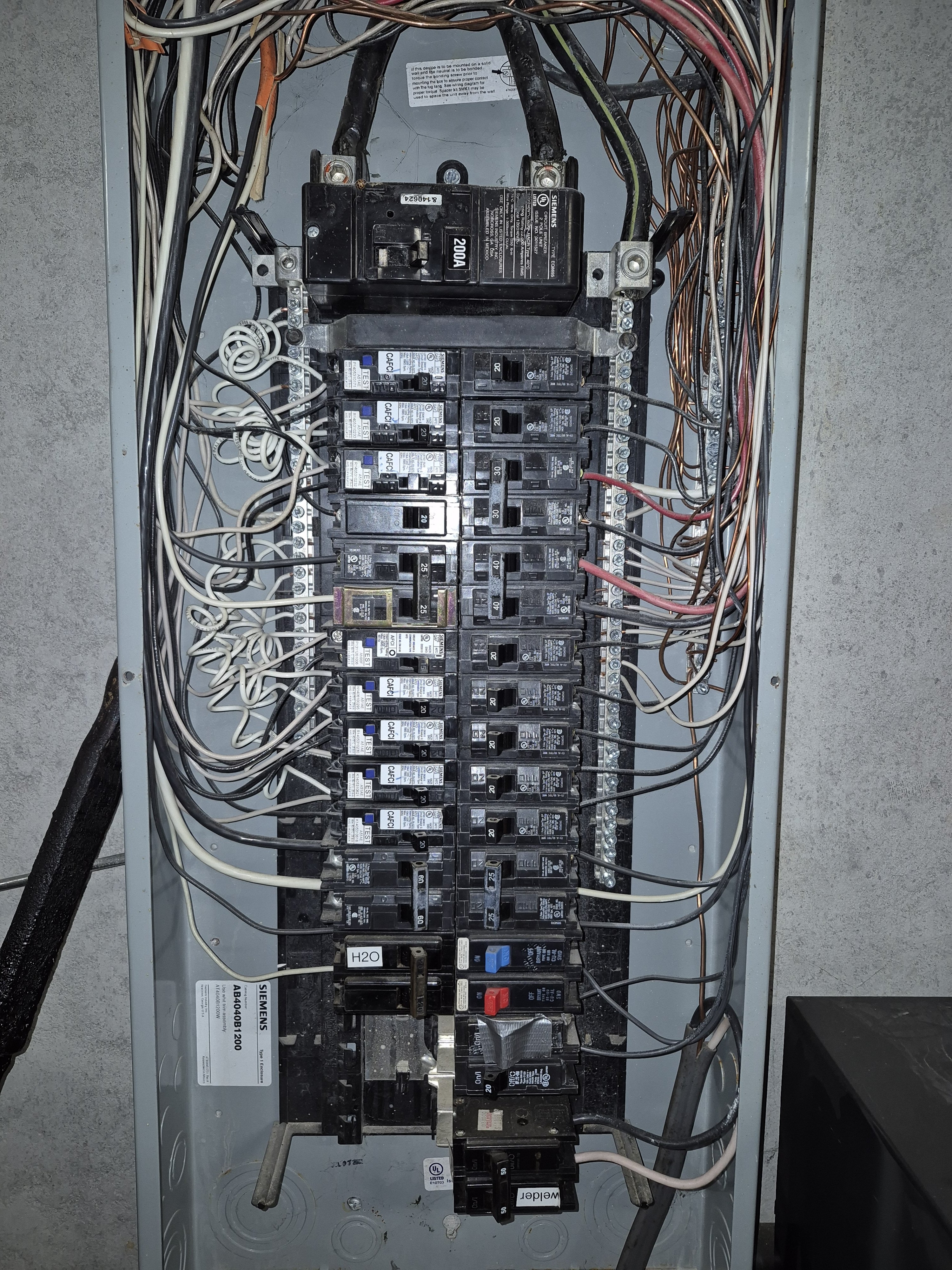

For 10 years we've put up with this "problem", hoping it would go away by itself. Best we can tell is when we do laundry and the water pump kicks in (really just guess that's when it happens) we "pop" anywhere between 1 to 6 ground fault breakers. (photo, right side; ones with check marks - ones with "X" pop constantly.)
Modular home built 2015, most of the "features" are definitely cheap. I've replace lots of things to upgrade as we go. Would replacing the (assumed cheap) ground fault breakers to better quality be the route to go?
IMPORTANT bit of information - we know NOTHING about the well (pump or depth) Another thought... could the pump be somewhat isolated. Since it's 240, moving it to the other side of the panel doesn't change since it uses both legs.
Also, all the ground faults breakers are on one side of the panel... Not sure that's an issue.
Also, NO the circuits that "pop" are not over-loaded... they barely have anything plugged in.
We have an electrician coming next week to look at it... hope to have additional information beforehand. So, any guesses why we "pop" so many breakers when the well pump kicks on??

Those are combination arc fault breakers (CAFCI), similar to, but not identical to GFCI.
They do make dual arc fault and GFCI breakers.
Do you have a photo of the panel, with the front guard off?
My guess is that there is a loose connection / bad relay /bad capacitor on your well pump circuit that is causing the breakers to pop, but it might also be how the wires are routed in the panel. If everything checks out ok, you could add a 20A 240V EMI protector to the well pump circuit. I'd do that over at the pump, but I'm not an electrician.

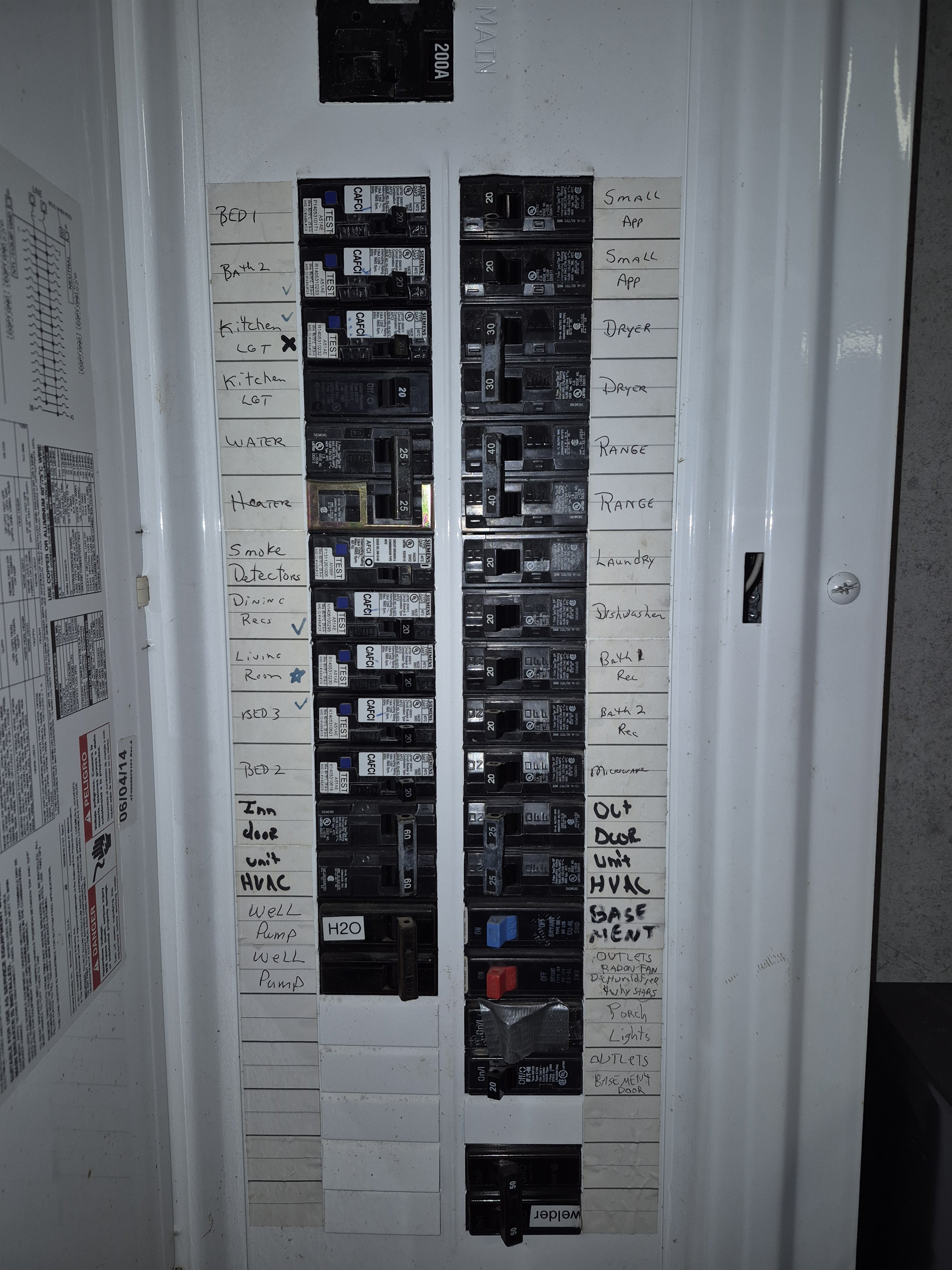

/ Another Question for electricians...
Thanks for your help, panel off photo...
I'm also not an electrician but dumb enough to wire up my basement and do the easier stuff, outlets, lights and switches.
EDIT: Just noticed the 3rd one down (on right) was tripped (yes, we are doing laundry!!)

/ Another Question for electricians... #5
Remember that I'm not an electrician, right?
The photo shows what I suspect your problem is. Your electrician left your neutrals on the CAFCI breakers coiled up and right next to both the monitored wires and the pump wires. Plus the electrician did not put the CAFCI neutral exactly at its own CAFCI breaker. In my mind, there is no excuse for running it up the panel, and it can certainly add to false trigger issues.
Each coil is going to act like an amplified antenna for the surge when the pump starts. I'd start by getting each one on the neutral bus in line with its own breaker. Then I would pull the coil out, extending each one to be a long "n" shape, with each leg close to itself, and the bend at the halfway point in the wire, and I would try to get them not crossing their own wires, and get all other wires away from the pump wires. Alternatively, or in addition to that, you could try moving the pump to the opposite side of the panel to relocate the pump wires farther from the CAFCI. (E.g. swap the radon & basement over.) I do think part of the problem is that the coiled neutrals are next to the wires that the CAFCI is trying to monitor. Your electrician may have other ideas on how to solve the problem.
Did this problem always exist, or just recently?
Why do you have duck tape on a circuit breaker? That seems like asking for trouble, doesn't it?
On your well, some areas require tags at the top of the well head listing details, often including which company drilled it. Companies tend to have great records as it helps them do a better job in the future. But you must have a pressure switch or a level sensor somewhere tied in to controlling the pump, right?
Many Thanks to you Ponytug; that all makes sense.
If I follow your thinking, could I re-route the well pump wires down, out the bottom of the panel to get away from the coils? Even move the breaker to the lowest breaker slot? Thinking it's more isolated down there...
Yes, been like this since the washer was installed (it was a year later after we moved in). All the electrical was done by Nationwide Homes (modular).
As for the duck tape, I did say I wasn't an electrician, either!!! So, I installed 3 outdoor ceiling fans on the deck. Problem is we get some wicked wind at our place. Those fans turned into propellers and self destructed one by one. The wires are capped off, thinking I'll put recessed lights in some day....
No tags or information at the well head on who drilled it, when we bought, the old house was already disconnected water wise but the electric power to the well was still used. the well supplied a few campers and a "playhouse" dishwasher, sink and toilet.
Also, don't ask me about the old septic tank (that information is tied to the well information!!!)
/ Another Question for electricians... #7
Thanks for explaining the duck tape.
It's not obvious to me why adding the washer would cause the CAFCI issue. Washers aren't normally particularly electrically noisy.
Side question: Do you have two different AC units, and if so are the indoor and outdoor HVAC correctly labeled? (Indoor 60A? Just curious. I do not think it is part of your issue.)
Rerouting the pump wires down might help, but from the photo, it is not clear if that's feasible. I suspect that rerouting the wires might address part of the problem. The spaghetti wire nests of the neutrals probably also probably need to be addressed. Does your AC ever cause the same problem?

You bring up a good point about the washer. We can go long periods without any breakers popping (without using the washer). The washer is one of those breakers that trips the most only occasionally (bedroom 3, 2nd up for well pump breaker).
For A/C, Only one unit, the compressor is outside, the blower motor to run the fan is inside and the emergency heat strips might be the reason for 60 amps(?)
/ Another Question for electricians... #10
You bring up a good point about the washer. We can go long periods without any breakers popping (without using the washer being used). The washer is one of those breakers that trips the most.
For A/C, the compressor is outside, the blower motor to run the fan is inside and the emergency heat might be the reason for 60 amps(?)
So this makes it sound as if the problem happens when the laundry circuit has an issue, not the pump. Is that right?
IIRC, and please remember I'm not an electrician, the washer is supposed to have a dedicated breaker, and only one outlet. So for a 20A breaker to be blowing on what should be a less than 12A load is beyond odd to me. Is anything else on that circuit? Is someone ironing using the washer outlet while doing the laundry using the washer? (That would be a no-no...) If not, if it were me, I would have my electrician look at the wiring for the washer. Something isn't right.
The laundry breaker popping may be inducing enough of an arc to overwhelm those CAFCI breakers.
Nope because we can run the washer for a while before it trips the breakers, thinking once the water pressure gets low enough and the pump starts, that's what trips it.
That's A GUESS, I guess I need to baby sit the water pressure gauge and watch it to make sure it trips when the pressure kicks on the pump!!!
As for the washer being on it's own breaker, no, it's not, there is a light and a couple outlets that nothing is plug into.
Update, playing with outdoor flood lights, that trips the same breaker (3rd one on the right) that I think is the washer... Need to confirm that!!! Hang tight...
Outdoor Flood lights are on the 3rd one down on the right... which trips the most.
Washer is on circuit breaker "Bedroom 3", 2nd breakers up from the H2O/water pump breaker.

Little UPDATE!!!
So the electrician was a no show, texted him but I was ghosted. No reply....
I tested things, the outdoor flood lights, tripped 3 times before I gave up. Did a load of laundry, tripped 2 breakers, then it tripped 6 breakers.
Opened up the flood lights, which had way too much wire crammed in the "can". I tighten the two wire nuts and crammed the wires back up in there... Wire nuts were fine, and tight... Basically didn't do anything. No signs of electrical arcing.
But that's all it took, been testing the lights several times now, no more popping the breakers, working fine!
Then we did two loads of laundry, not one tripped breaker (never had that happen before).
Is it fixed? I don't believe so... I need to pull the flood light wires down again and look closer at them but I got 19.5 tons of gravel and I've been spreading that on the road down to the creek...
Heading back to the big city and come back in a couple weeks to play around again. I might replace all those breakers.
I will update this as needed... Especially if we pop a breaker. We did look online and these breakers are "crap" and a couple of "class action" files have been started.
