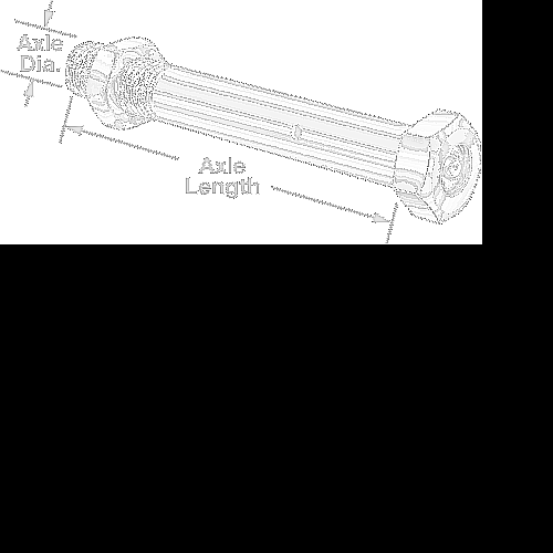

charliebrn...forgot to mention...the wheels I'm getting do not have grease fittings, but I plan to buy axles that have a grease fitting in the head of the bolt.
Question to all: the axles on McMaster.com do not list the grade of steel. Does anybody know where else I might find axles? Would like to spend $0.50 extra and get grade 8.
