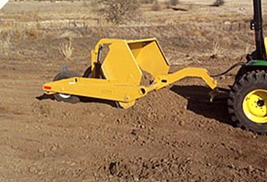

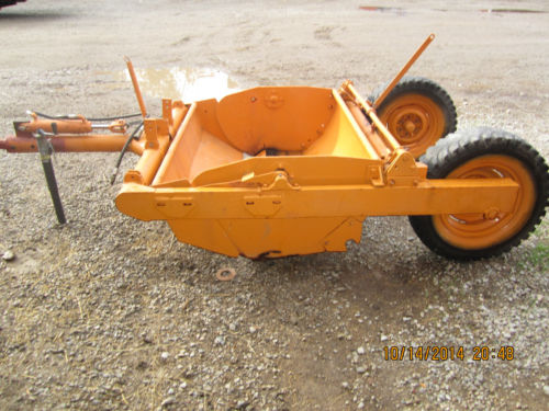

I hope for a speedy and full recovery. While you heal up, look into a 2 yard pan. Ashland still makes one and there is usually one on EBay. Moves dirt fast.
/ Any Advice Is Welcome. #11
For those that don't know what a "2 yard pan" is, since they are called different names in other parts of the world, this is one style.

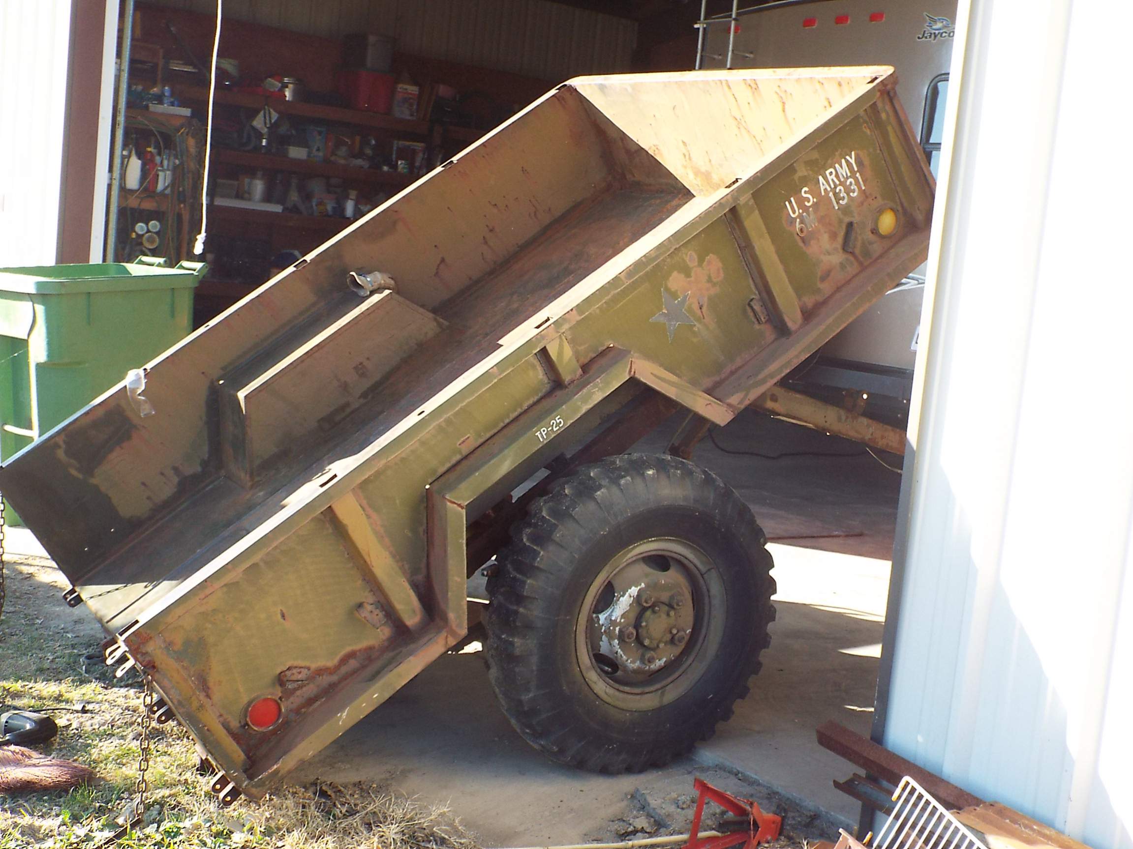

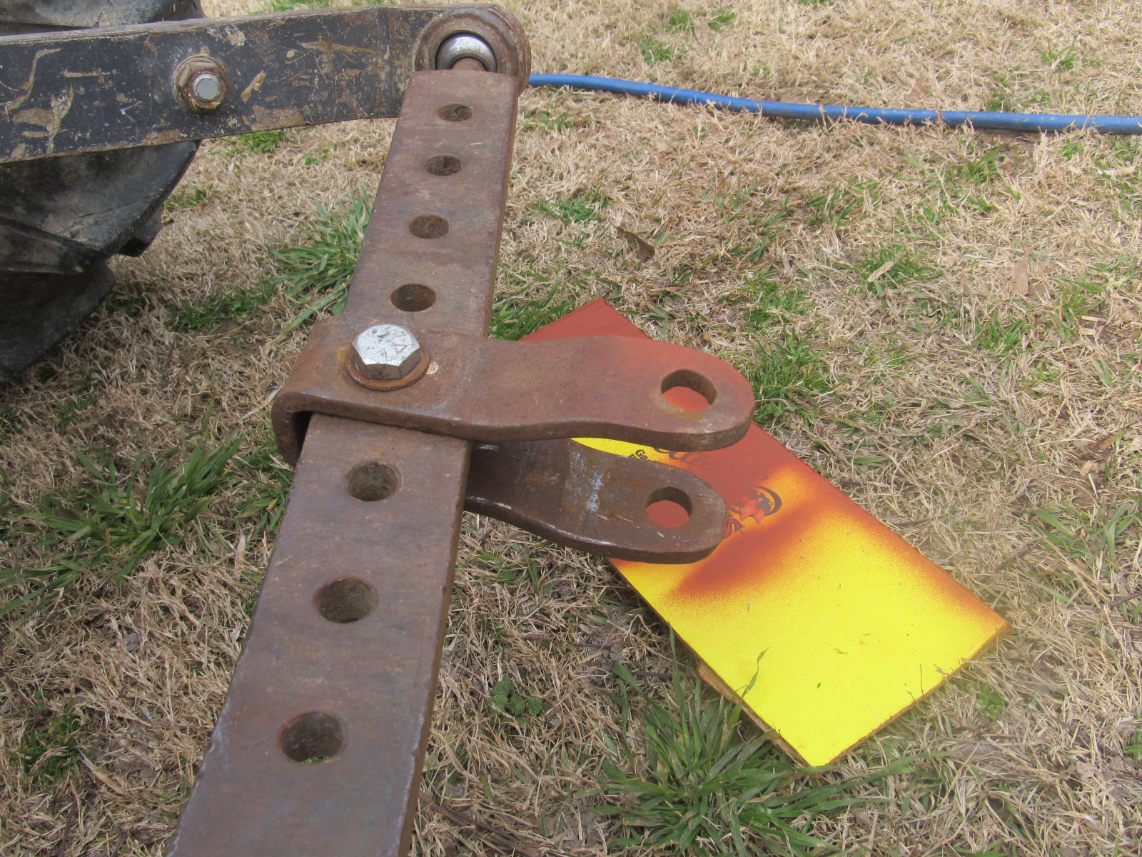

I have improved a lot thanks for the prays and words of encouragement. My knee is about 90% and my back and neck are still on hold till I can't stand it any more. Meanwhile I bought dump trailer on a government auction site. It is not really what I want but it does dump and it works, and it was cheap $225. I repainted Kubota #2 I didn't have a pintal hitch so I made this.View attachment 444426View attachment 444425View attachment 444424]View attachment 444427 .IMG_6809 - Copy (2).JPGDSCF6622.jpg
