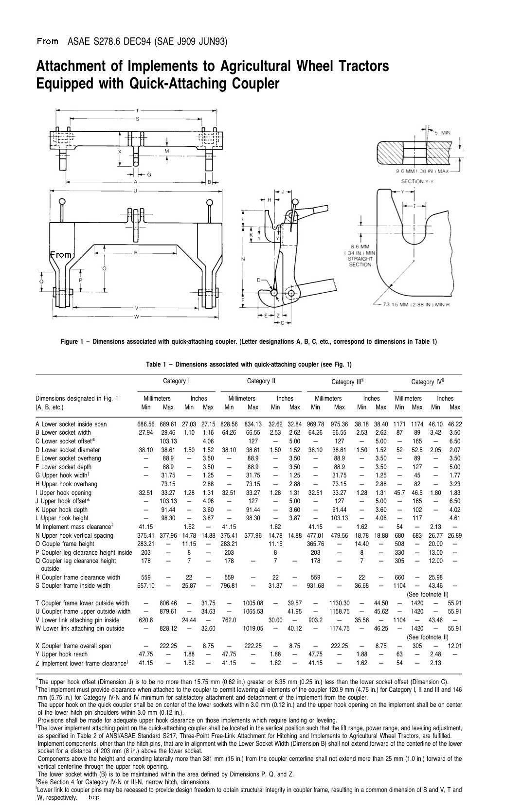

Cat 1 and Cat 2 top pin height should be the same, if built to quick hitch specs.
Implement specs:
Hitch specs:
Bruce

Bruce, almost all the info I have on 3PH agrees - not sure where I found this one though, but apparently Caroni agrees with it... Steve

BukitCase, your chart shows standard implement 3 point hitch dimensions (not quick hitch compatible.)
