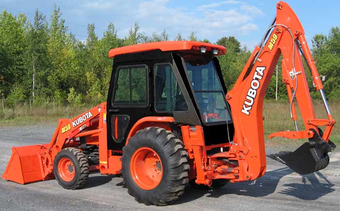

So, perhaps I should have posted this here to begin with, but I posted in the M59 discussion thread Although, I assume the audience to both threads are the same, just throwing this out there in case anyone has any input...
I was going to post this in the new M62 thread but figured there were more owners here.
I have a question regarding size.
Is the M59/62 physically any bigger than the L5740? I know the framework for the FEL is larger, more substantial, and same with the backhoe mount, but is the actual size of the tractor itself, any different from the 5740?
I've looked at the specs on tractordata, and it is difficult to tell because the dimensions and weights for the M59 is listed with the loader and backhoe attached, vs the tractor only weight for the 5740.
I'm wondering if the difference is just the extra steel on the FEL and backhoe that make up the differences, or, if it is a completely different frame altogether????

Yeah, sorry. After I reread it, I realized my reply sorta missed the target altogether....
The L6060 shares a bunch of components like the front axle looks the same, rear axle as well. I wouldn't think, with all the unique features like the cab, a mid pto, an HO alternator and ac compressor that they could use the same frame for both.... However!
The M62 weighs 8925lbs. with FEL & backhoe
The L6060 weighs 4376lbs. with the cab
The LA1055 weighs 1411lbs.
The FEL buckets weigh 331-397lbs. depending on shape
The BH92 weighs 1800lbs.
The backhoe buckets weigh 119-229lbs. depending on size
So maxed out the L6060 weighs 8213lbs.
If you consider the M62's backhoe and the FEL, it's reasonable to assume they do share the same frame...
