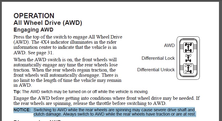

For all you Polaris 4 wheelers out there.
The number 1 reason for front drive failure is this little note in your owners manual.
Notice: Switching to AWD while the rear wheels are spinning may cause severe drive shaft and clutch damage.
Always switch to AWD while the rear wheels have traction or are at rest.
And this applies to all 4wd systems.
Knowledgeable drivers switch to 4wd before they actually need it and in so doing eliminate the chance of doing damage to their drive system. Otherwise you should return to an idle, switch on the AWD, and then slowly speed back up allowing the system to engage.
His video is a good example of how to switch between forward/reverse and 2wd/4wd with ease allowing the system to engage and disengage. Great video for that part of the demonstration. Too bad he doesn't understand how the front differential was actual working.
Hope this helps save a few owners costly repair bills.
