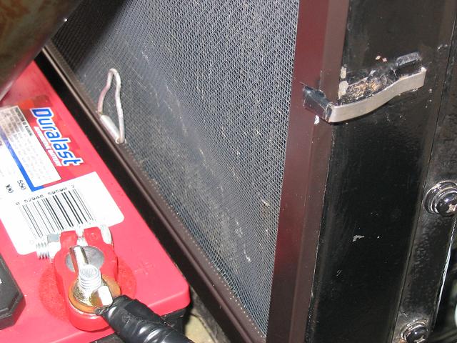

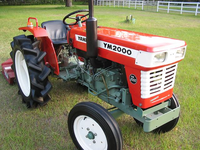

I have a YM2000. basically a YM240, and noticed references in the operating manual about a radiator screen. I learned that the part from Yanmar Japan would be around $50.00.
I decided to fabricate my own screen using regular window screen, aluminum channel, and plastic corner brackets. To better match the radiator, I painted the aluminum with black spray paint.
This has worked well for over a year now. I have attached a couple of pictures of the screen and a picture of my tractor.

Let me try again on the pics.

   / Any Radiator Screen Suggestions for YM240?? #27
Pic 3
