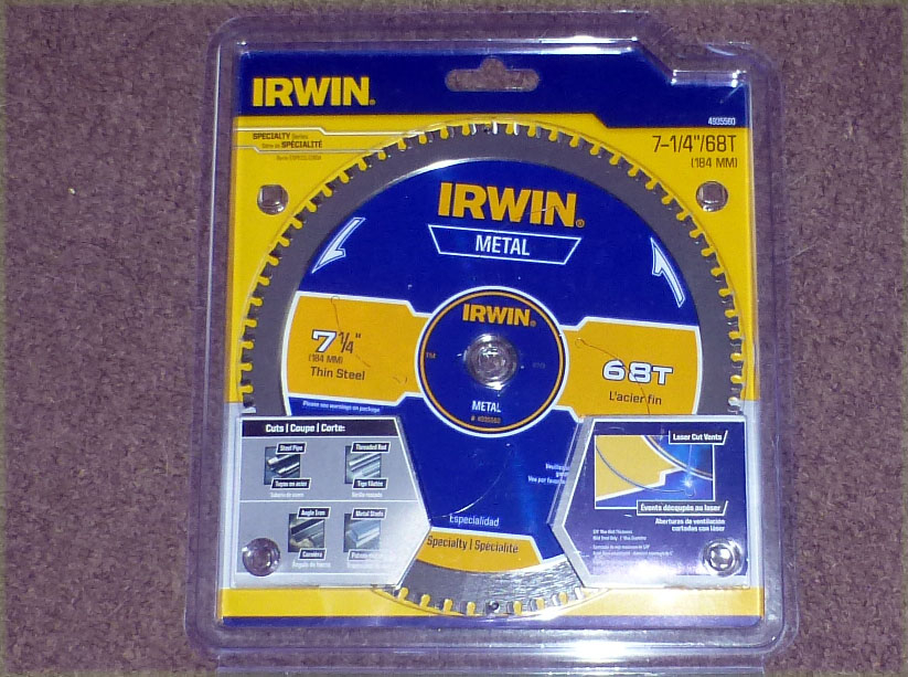

Because of you characters o_O, I got this thin metal, carbide, blade. Now I can throw my old one in the recycle bin.
