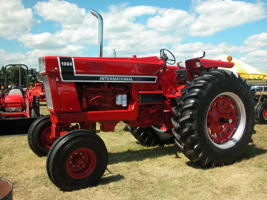

E&M has exhibited at Ag Progress Days a few years ago. Here is a photo of their handywork...
