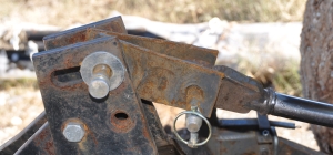

As I had the hydraulic top and tilt installed at the time of the tractor purchase but added Pat's system later there was a mismatch in top link length. I fixed that with a couple pieces of metal drilled for two pins to make an extension. Pat read about it on the site here and offered me a professionally built version for free. All my PTO driven implements had enough extra reach on the PTO shaft so that didn't cause a problem.

Could you post a pic of the extension you made for the top cylinder?

Sure thing, be glad to as soon as I get out to the tractor.
Meantime...Consider a rectangular piece of steel 2-3 inches by 5-6 inches with a hole drilled about an inch from each end on the centerline of the long dimension.
The holes are clearance holes for top link pins. Make two of these pieces. Pin one end of each to the hydraulic cylinder, one on either side of the hole at the end of the rod using a standard pin and keeper. Do the same at the other end to connect to the implement. This extends the reach by the distance between the holes you drilled. I use washers on both sides at both ends. This will extend your reach but it won't let you apply down pressure to the implement by extending the top link. This limitation (if it actually is one) doesn't bother me. I probably didn't need to do that as I sure don't miss being able to do it.

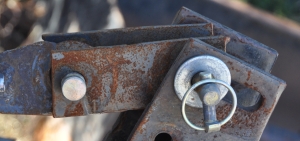

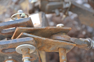

Bobsphotos, here are some pix as promised.
They show 2 slightly bent/rusty pieces of flat bar steel with holes near each end. These are pinned to a slot in the top link connection of my brush hog at one end and at the other end to the hydraulic top link. Pretty low tech but works well in all respects except if you wanted to use the top link to put down pressure on the brush hog. Noting the slot in the top link hookup you really can't put on effective down pressure anyway (don't know why I'd want to.)
The first three pix show the adapter. The fourth? Well... I like Clint Eastwood and I thought the AARP thing was a hoot. So there!
