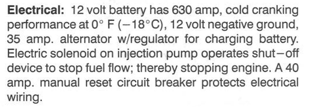

Do you know if the regulator is working?
I didn't know what the amp rating was for the alternator, so copied this from the Operator Manual:

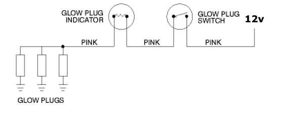

On another recommendation, I have decided to eliminate the nichrome wire and replace it with a starter relay or I also have a glow plug relay from a 6.2 diesel. I could use it by itself, but the ECM tells it how long to stay on. And I won't have the ECM
I am going to use a little LED light for the indicator light. I was wanting the glow plugs on a timer. Like my Toro 223D Reelmaster was - I'm not sure if it was a timer or thermal switch.
How long does everybody's glows stay on that has a timer that shuts them down Automatically?
I was think 10 to 15 seconds.
Does anybody have a recommendation for a timer?
Or a different LED light? The light I have takes a 3/4" hole. I haven't looked at it yet, to see if I can reduce the hole size needed. Not sure what hole size the nichrome has.

Do you think this would work for a glow plug timer - hooked up to a starter solenoid for a relay?
Car Ceiling Light Dimmer Delay Off Timer 7-14s for Lamp/LED Free Shipping CH1 | eBay
I don't understand why you are trying to complicate a simple circuit?
Why not fix the problem, if there is one, on your machine?
In cold weather, I hold my glow plug switch until the indicator gets bright red and turn the key to start, while keeping the glow plug switch on until the engine runs a few seconds.
This is the circuit:
