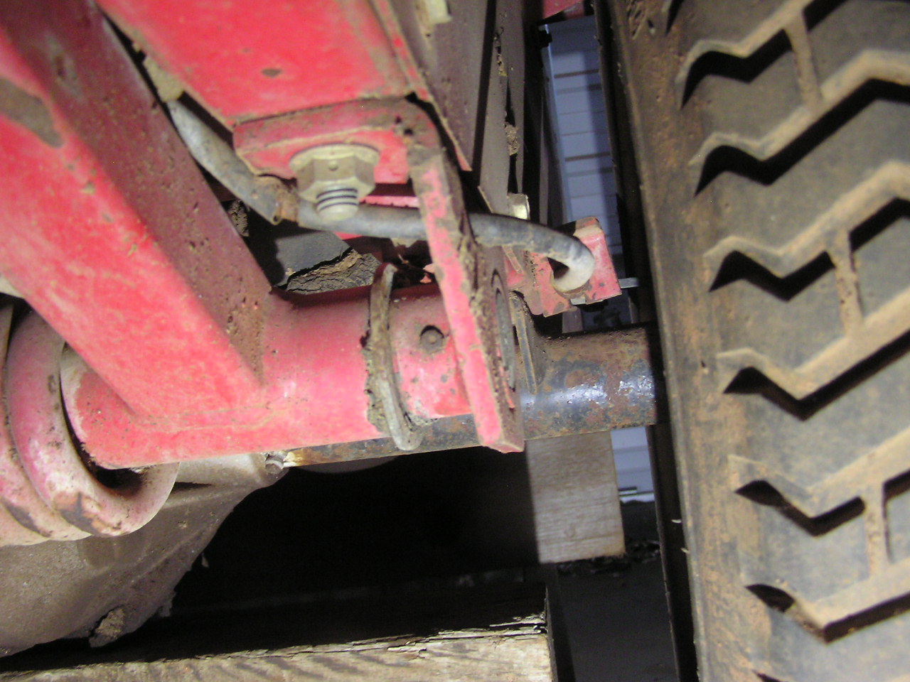

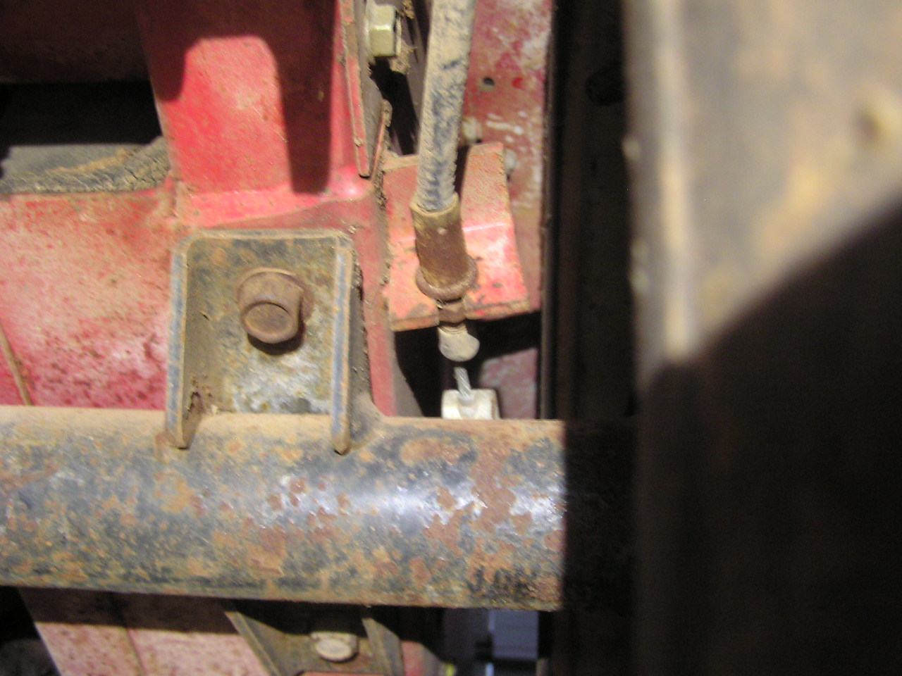

I have a 1998 Toro Groundsmaster 325D Model/Serial 30795-80161. The right brake cable is locked up. It does not look like it was routed correctly.
Looks like it kinked up a little. At $115, I don't want to kink the new cable up.
I did not see any pics of the cable in the manual and am not having much luck figuring out how it is supposed to run. I did read one reference about taking the clamp off that holds it in place - on my mower there is no clamp in between the ends. It's just routed in the manner it's routed, hanging loose.

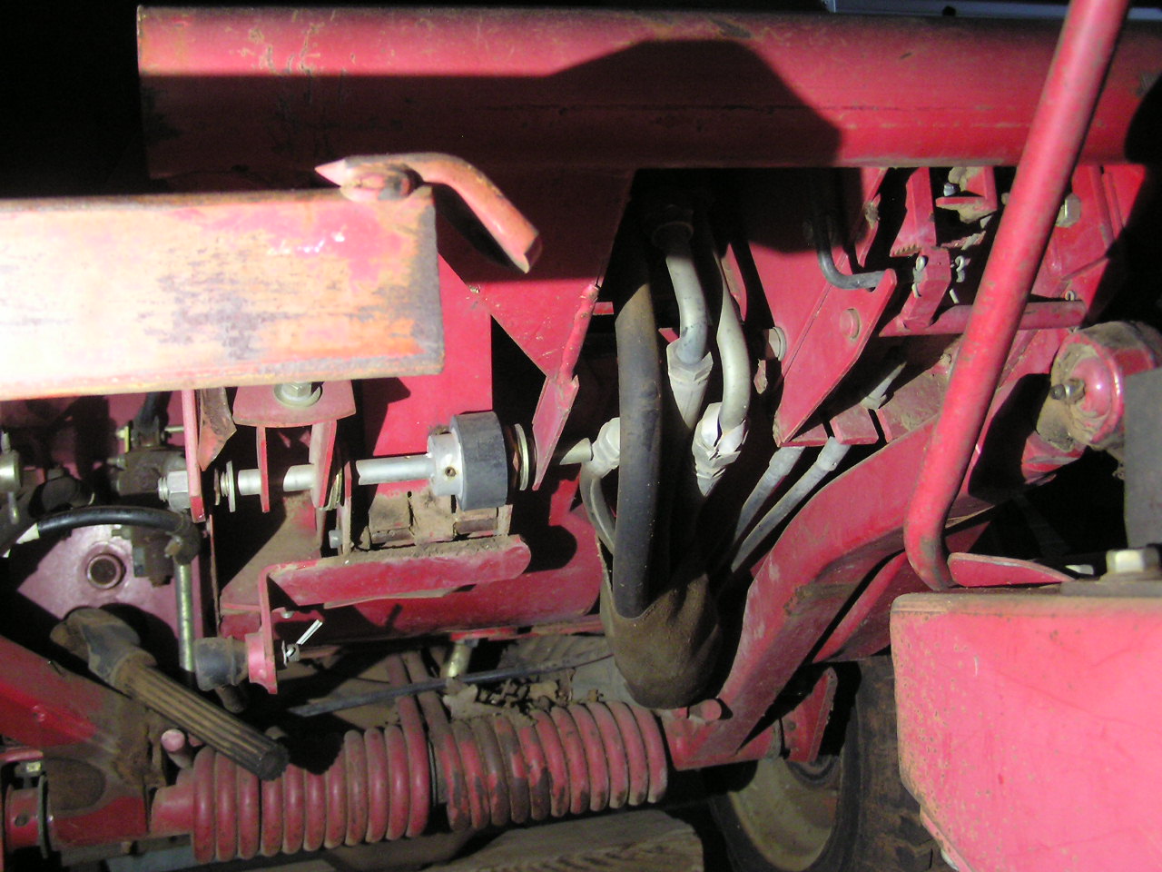

Can anybody get me pics of the LEft & right front brake cables on a Toro Groundsmaster 325D ?
I just got back in and the left side does not look quite right either
   / any toro groundsmaster fans on here? #123
Didn't see your comment about the left side, before I went out and took some pictures of the spare parts machines.
Here is the right side, it goes down and lays on top of the springs:

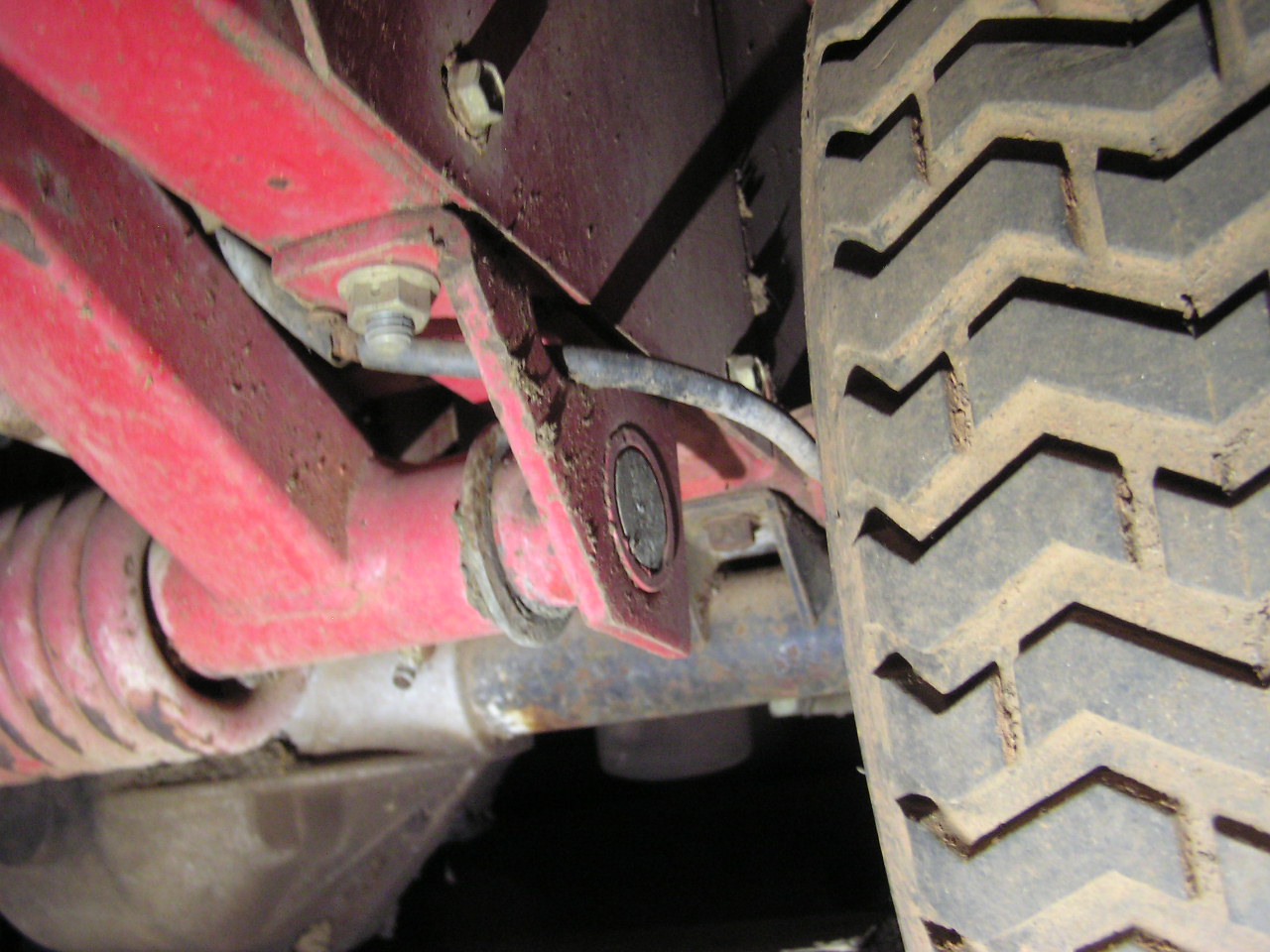

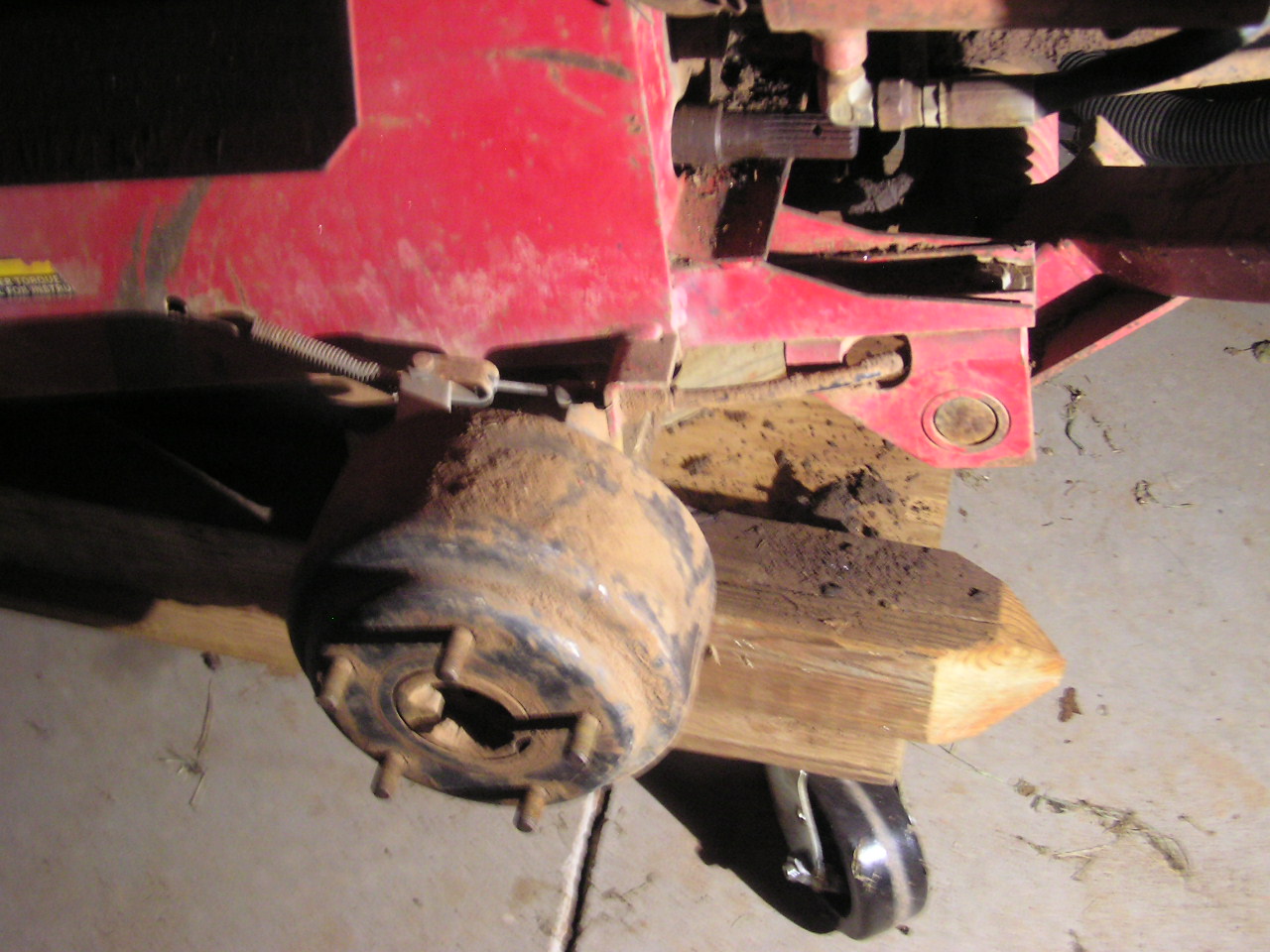

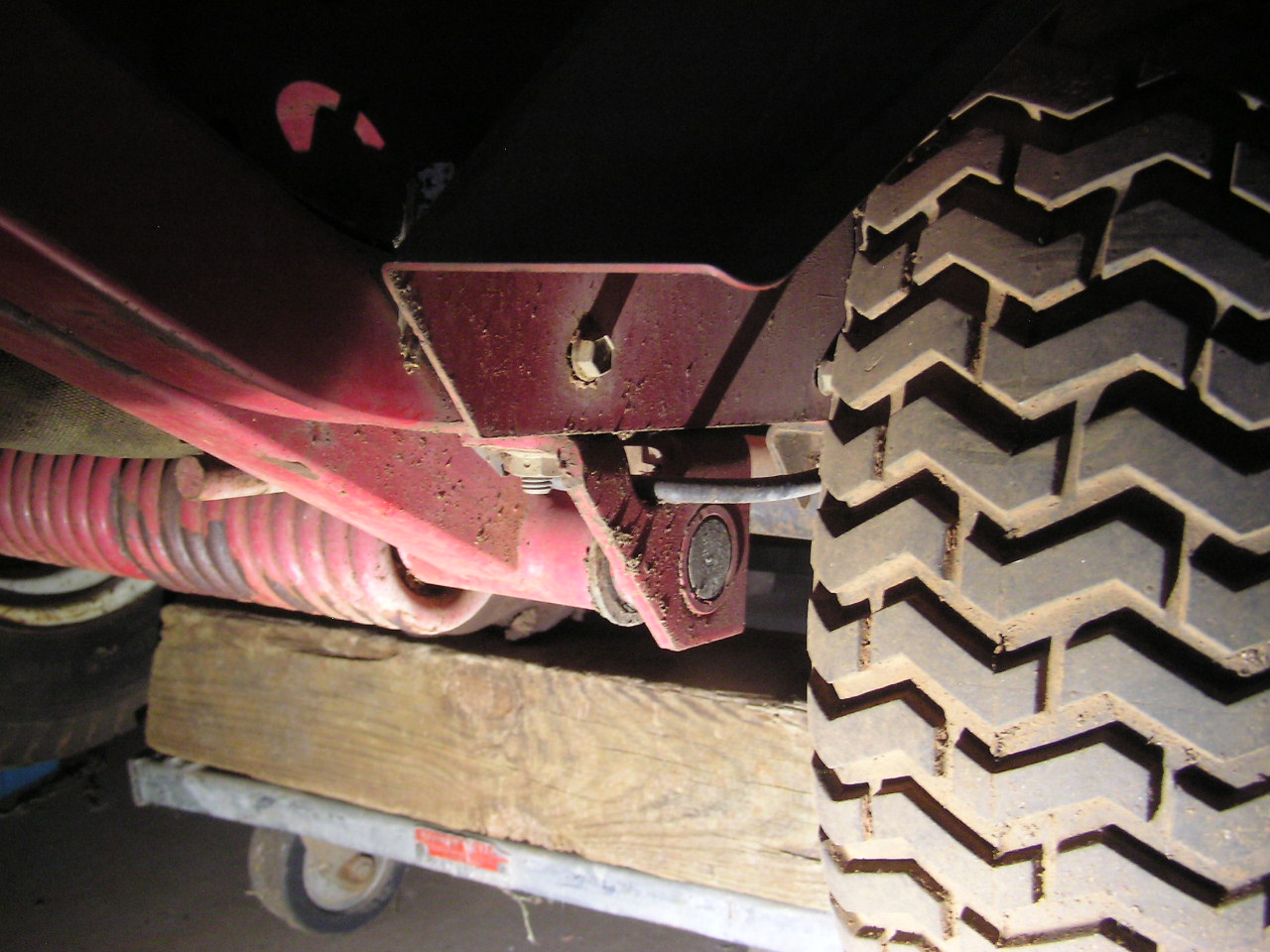

Does the left side run through the same hole in the frame as the right side?
   / any toro groundsmaster fans on here? #125
Yep, the same location on the left side:
   / any toro groundsmaster fans on here? #126
Thanks again. Mine is just run straight back on the right left side - Did not look right to me.
The right side was run underneath everything. Looked like it was rubbing on the drive shaft and got kinked by the lifting arm.
got them done.
Then I Noticed a drip off the hydrostat. More work to do.
   / any toro groundsmaster fans on here? #127
I have decided to reroute the left side back the way they had it. For some reason it does not want to bend to clear the lift arm. So I am going to take it back apart and run in inside the bracket like it was before. It seems that bending it enough to clear the lift arm as shown pushes the part of the cable outside the frame dangerously close to the tire. if I ever have to run chains for the snow blower it would never work.
