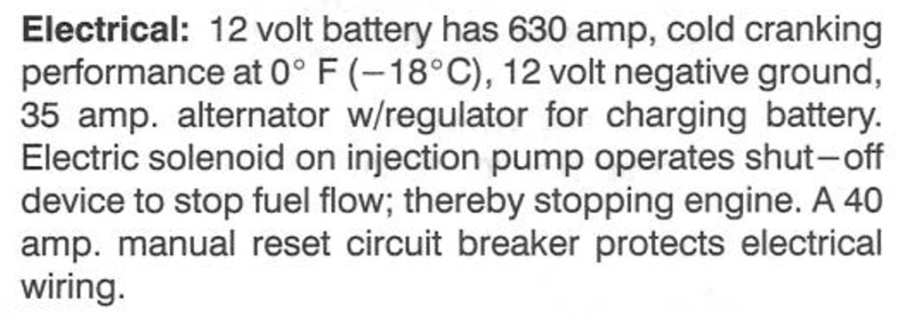

Do you know if the regulator is working?
I didn't know what the amp rating was for the alternator, so copied this from the Operator Manual:
Yes, the regulator is functioning (with supplied charge from my truck, it will break the circuit, and close it after I unhook the cables).
The alternator is a 40 amp unit. The cheapest I've found is $215 through a Google search and cross reference. An 80 amp one-wire universal alternator from Advance Auto parts is only $250... but I would have to fab mounts, as it's a generic GM housing.
I have picked up used alternators from various vehicles, for $20 or less and made mounts for them. Usually had less than 5 hours in them all told - including getting the alternator. Mostly for old tractors. Some 6 volt to 12 volt conversions.
1 - 20hp Kohler that the charging system went bad on - but I had room to mount an alternator rather easily. Turned out to be much cheaper and easier than buying and replacing the parts for the K532 Kohler. Also did a Wisconsin engine for the same reason.
In this application a heavier duty used alternator might serve you well.
