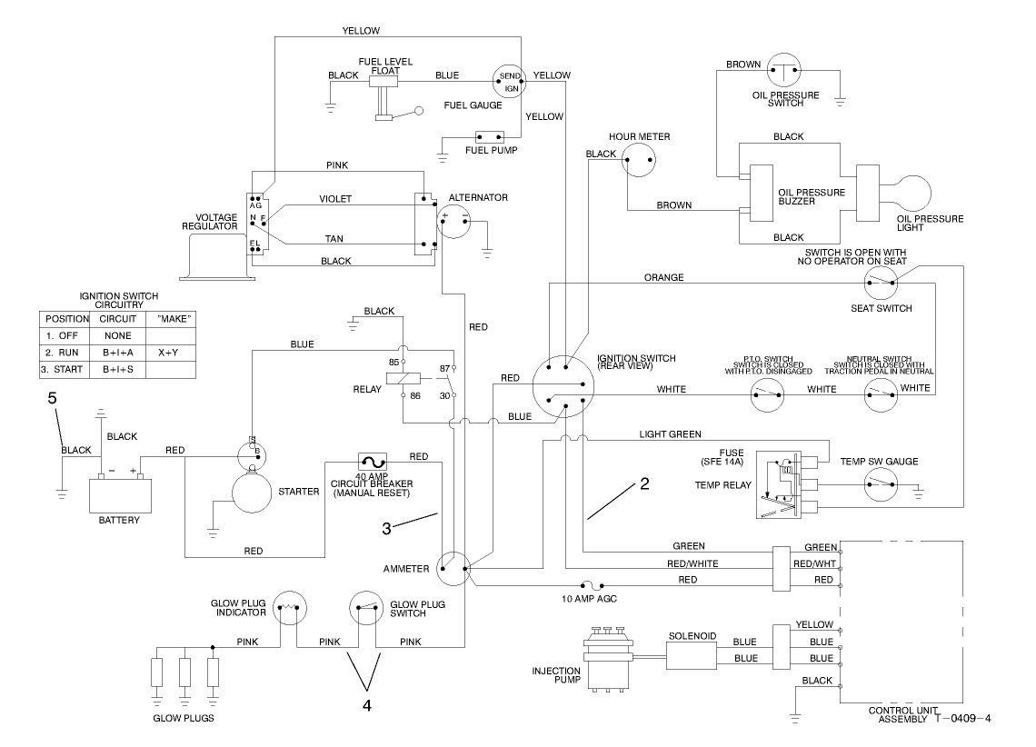

On the 1998 Toro Groundsmaster 325D with the Mitsubishi engine.
I believe the glow plug controler is not working correctly. My glow plug indicator is not working and the glow plugs are only getting 8.3 volts instead of 10.5.
When the weather got colder I noticed right off that I had to hold the glow plug button way to long - about 40 to 50 seconds.
Can anybody give me a clue on part number or possibly a simple fix?
The part number for the indicator is Toro 42-9190 $56.04
I would think I get get something far cheaper to reduce from 12 to 10.5 volts - any ideas?
The glow plug indicator is just a nichrome wire that glows when the current is high enough.
You may have one glow plug that is open. Disconnect them and check the resistance of each one.
You probably already have the schematic:
Open it in a new Tab for full size.

I checked the glow plugs first. I also pulled them out for a visual and gave them a coat of anti-seize on the threads before re-installing them I also ran new wires to them. Somebody had taken the buss bar off and run little wire to 2 of the glow plugs.
I ran 10 gauge wire and made it so the connectors were all on one wire. Before I had voltage drop from glow plug to glow plug
It says the glow plugs are 10.5 volts.
Can you check on your machine to see what volts you are getting at the glow plugs?
Thanks
   / any toro groundsmaster fans on here? #138
My battery needs to be charged, but I was getting about 1 volt drop across the glow plug indicator. There is no buss bar, just the little wire. I get the same slight voltage drop from glow plug to glow plug.
Had the same voltage at the first glow plug, as the output of the indicator, so that wire is good.
Check the battery voltage while the glow plugs are on, see if it drops to 11.5 or 12 volts.
