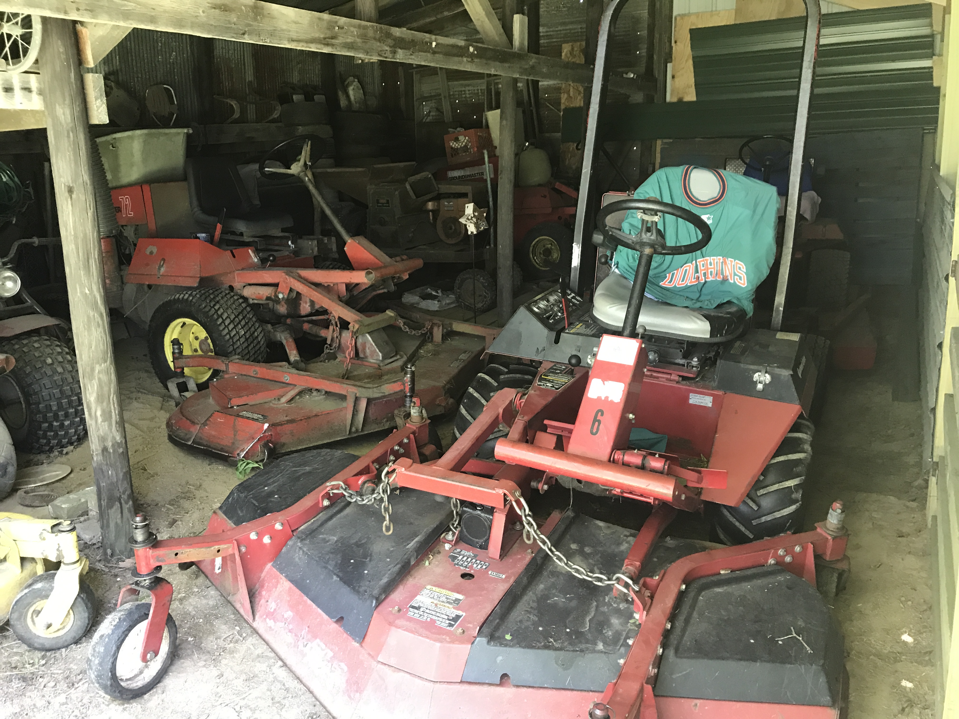

wow, upload files, didn't even think to hit that! well in all fairness to me it just looks like regular text and not a link! lol Well here is my collection though I want to line them up some day with my tractors. BTW, I made a cable for the right brake and it works well, unfortunately it only helps turn a little bit. :( There just has to be a way to make a 325D turn, but if there is I haven't figured it out, short of taking the 4wd off.
