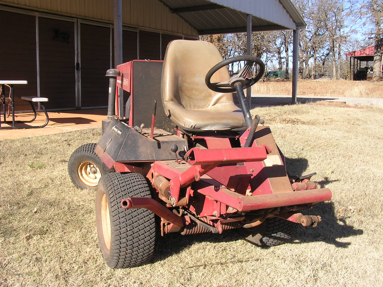

any toro groundsmaster fans on here?

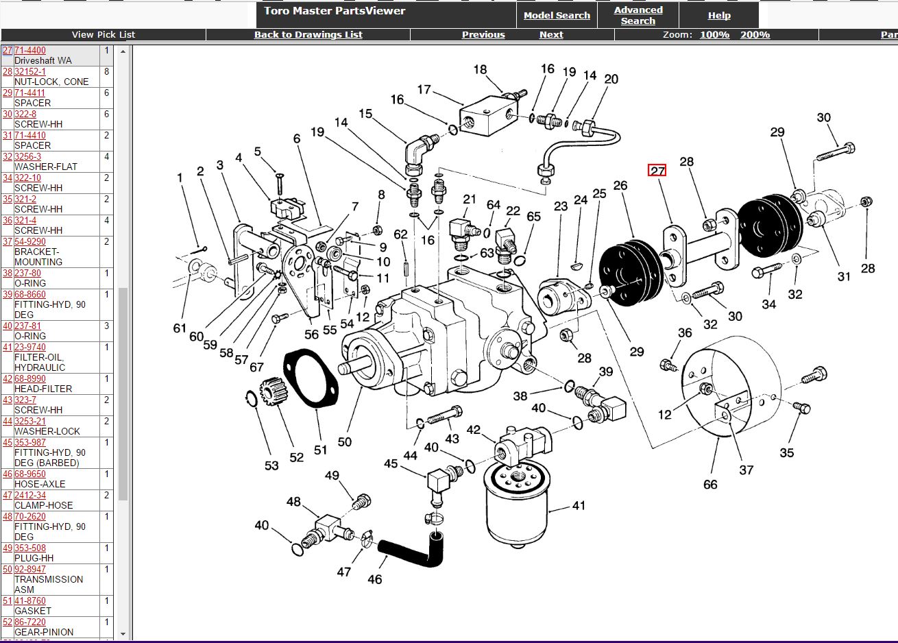

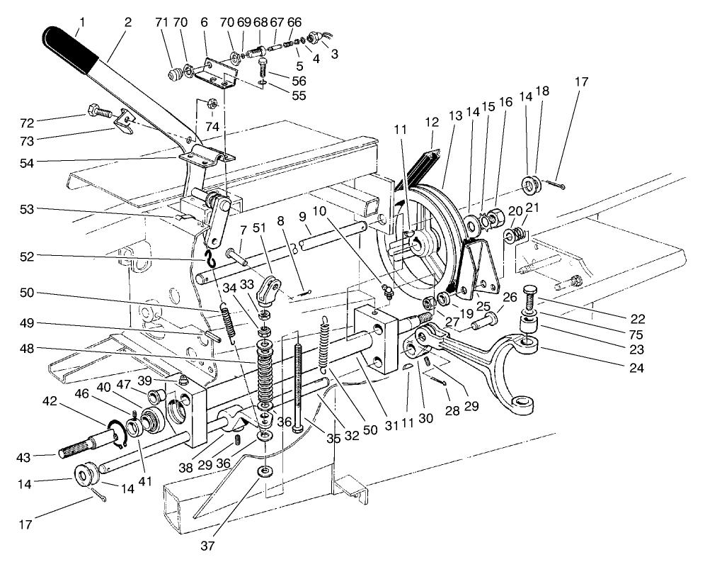

Yours doesn't have the roller clutch, the lever connects the drive shaft to the rear axle.
Does the manual say anything about using 4WD on hard surfaces?
   / any toro groundsmaster fans on here? #222
I don't know if it would be classified as a crappy design. It's just something that they improved over time. Nice for when you want to back up a hill, otherwise you'll never notice.

Also found in attempting to adjust the neutral position, the manual said to lift one wheel off the ground and notice which way the lift wheel was turning if at all and adjust accordingly. Well, the wheel on the ground kept turning even though the manual said it wouldn't, so either something is going on there, or the 4wd was engaged when it's suppose to be off. I didn't look at the time to see what was making the machine move since I was trying to keep it from falling off the jack! lol
Jack up the right side and put a jack stand or block with wood. Get the right side of the rear axle off of the ground also.
Maybe the 4WD isn't disconnecting.
